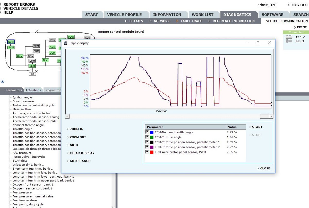

Did a little experimenting with the throttle body off that V70. Plugged it in to the vehicle harness on my car as such:
The mechanical pots are happiest when they stay clean and dry. I opened/reassembled it several times experimenting with several substances including engine oil dielectric grease.. Spray the rotating sweeps with MAF cleaner, wipe off the resistive pads with cotton soaked in same and bam! Sweep test looks like a new one:
I played with the throttle pedal and 'tested' it for over half an hour while watching Vida. I think it can go back on that V70. I'll check the harness/connector on it. I don't have problems with that not staying seated on mine. But I put bulb grease in there so that the weather pack seal doesn't get caught up and prevent the connector from fully seating. Unless you broke the locking tabs that's probably all most people need to do. A squirt of silicone grease that doesn't cause an issue vs a $40 pigtail plus the trouble of snorting into bay harness...I'll take silicone grease for 10 cents please.
Edit. I wasn't going to mention this because it sounds crazy. But a recent new topic viewtopic.php?f=25&t=86003 got me thinking about it enough that I'm deciding to put it out there. During one of the 'substance' experiments earlier today, specifically bulb/silicone grease which had a similar consistency to the gummy engine oil that originally fouled the TPS, along with DTCs for the TB/TPS and 'reduced engine performance' displayed on the DIM at KPII, a persistent active DTC for the brake pedal position sensor (out of range) popped up. Very persistent: through key off cycles and also after clearing with VIDA it came right back. I have not had any recent issues with the pedal sensor. That pedal sensor fault went away after I cleared the grease out of the TPS contacts, reconnected the TB and continued my experiments. There is a chance that the pedal sensor is about to go bad and it was just a coincidence. I drove the car a couple times later in the day, cruise worked fine like it always does. I use it a lot. No system warnings..nothing.
