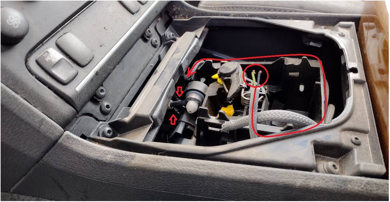

Finally had a little time to fix this, likely from previous owner's spilling sugary drink.
All you need is a few drops of sugary drink on the cable, it will make it sticky.
Anyway, I was at junk yard, someone already removed the center console trim, so the
whole anatomy is exposed. I took this opportunity to snap a photo for forum.
This is how it works...
When you turn the key to from position 0 position I or II, 2 events happen:
1. The Yellow plastic is moved rearward. The White plastic will move downward,
releasing the lock on shifter.
2. But the microswitch is now "armed", locking the shifter.
3. When you press on the brake pedal, a microswitch is de-activated.
Now you can shift from out of Park.
You can see it in the youtube video below, if you are stuck somewhere, just lift
the rear of the trim as shown (no need to remove the trim) and press the White
plastic down...Do this with the key in position 0.
Stuck in Park
- Posts: 8360
- Joined: 31 Mar 2010, 09:54
- Location: Omaha NE
- Been thanked: 504 times
I had a little time to play around with the engineering aspects behind this, hope this helps others...
1. At junk yard or if you are stuck some place and need to shift out of Park
(let's say battery is dead and you need to tow the car):
- Pull the Parking brake or chock the tires for safety.
- Once the trim around the shifter is lifted upward, press the white platic lever
Downward, while squeezing the Shifter Button to shift out of Park.
2. Now, this is how it was engineered from factory, which is pretty standard in most cars
with Auto Trans. In order to shift out of Park, three (3) things need to happen:
a. Key at least in position I or II (this pushes the Yellow Plastic rearward, at the
same time the microswitch is activated).
b. Foot on brake pedal to release the small electric microswitch.
c. Squeezing the button on the shifter.
I learned about "b" when the brake pedal is NOT pressed and when the key is turned to
position I or II:
* I hear a click from the microswitch, now even if you squeeze the button on the shifter,
you cannot shift out of Park bc the microswitch is turned on (blocking the shifter) as
soon as the key is turned to position I or II (try it yourself).
* Once you step your foot on the brake pedal, the microswitch is released, unblocking
the shifter.
Spend a little time and go through this yourself, you will see how this was engineered!
position I or II:
the shifter.
- Posts: 8360

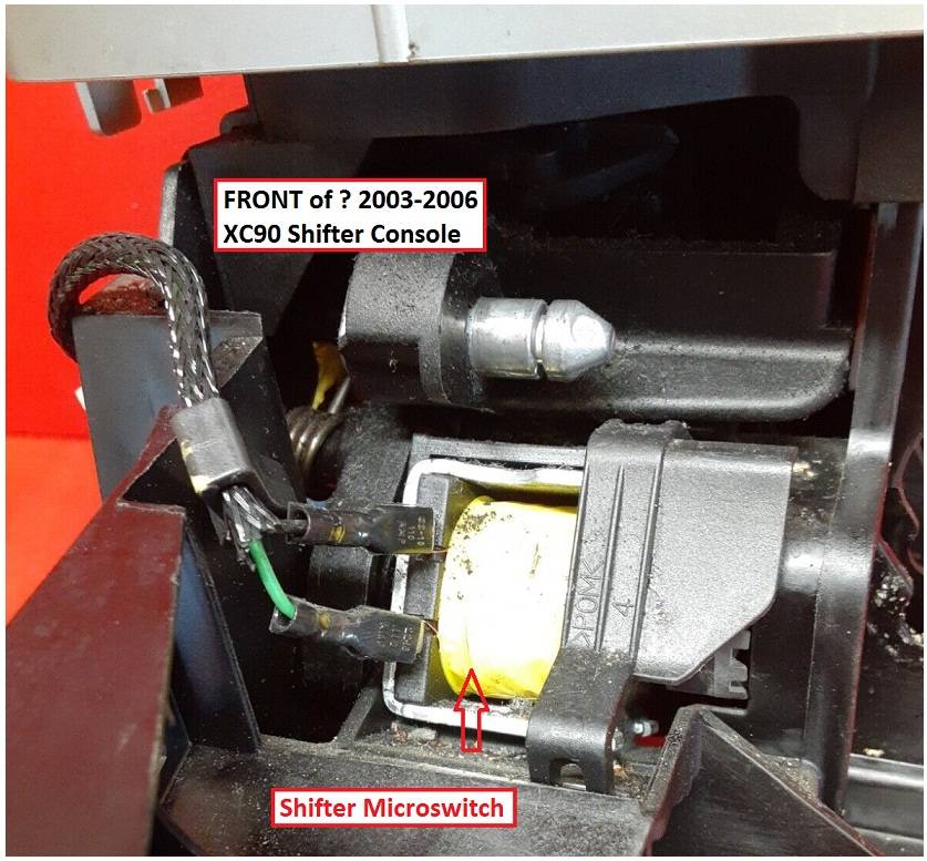

So, the wife 2005 XC90 2.5T is acting up intermittently (cannot shift out of Park).
This happens in 2-3% of the time, I have not had time to pinpoint the issue...but...
- The P80 forum years ago was talking about disconnecting the microswitch.
When doing this, you still have 2 safety items in place (which means kid cannot
shift out of park without any means. Btw, no kids at home for us old timers).
Anyway, to shift out of Park:
1. You still need the car key to turn the ignition.
2. You still need to squeeze the button on the shifter.
So, has anyone here deactivated the microswitch (just unplug the microswitch)?
This would effectively eliminate the microswitch ---> brake pedal circuitry?
I made a sketch to show the points...
The 2nd photo shows the location of the microswitch...

I was at the junk yard yesterday, this is a 2005 XC90 2.5T with 260K miles...
Different topic but you can see the Shifter Claw is broken.
Anyway, the circuit for the Shifter Microswitch is in the photo:
- The smaller wire bundle (Black and Green) feeds the microswitch by running around the
aft side of the Shifter Assembly.
- From the left side (driver side), you can see (using flash light) the 2 wires terminating into
the microswitch motor:
