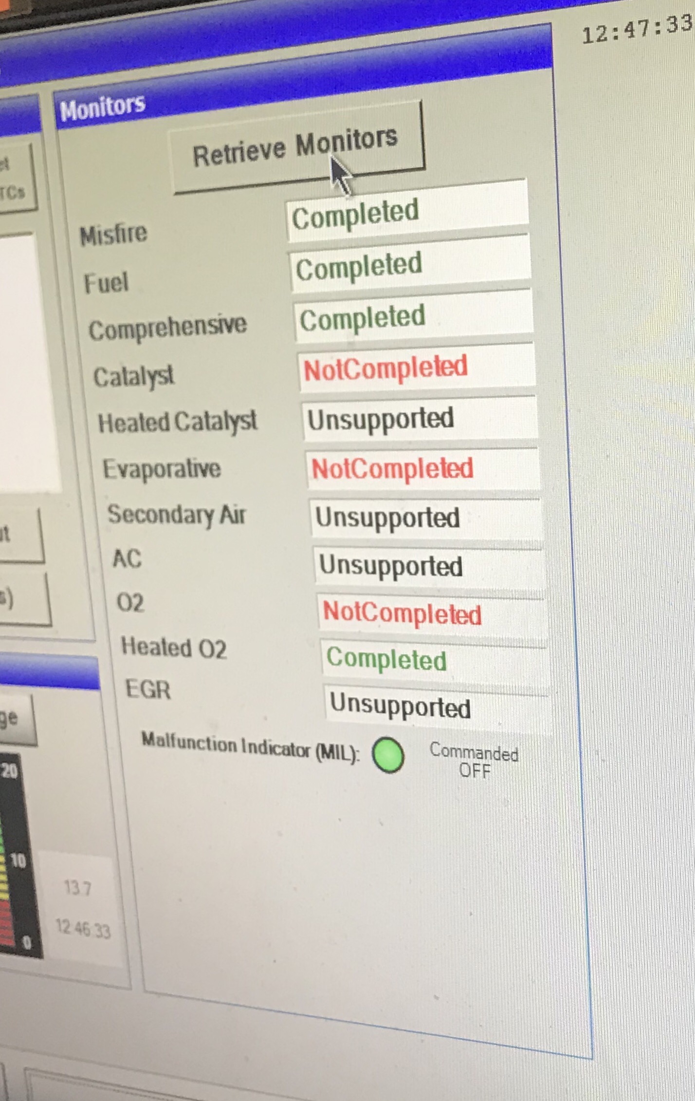

Okay on my lunch break I took it to get emissions checked. I told the guy what all had been going on, he said before actually checking it he would test to see if the car was ready yet-nope.
Catalytic, O2, and Evap system were not ready yet.
He told me get another 50 or so miles on it, it should be pretty close to being testable.
I managed to get another 20-25 miles on it before going to work. I tested the car with my code reader before parking it, code p1081 came back on my code reader.
Still no check engine....
I’m hoping I can get enough miles on it after work before the emissions place closes. He said I can have 2 tests outstanding and it will pass. So I just need one of the catalytic, evap, or O2 to finish it’s cycle and be clear.
I’d prefer all to be working though so I don’t have a check engine light all the time...
