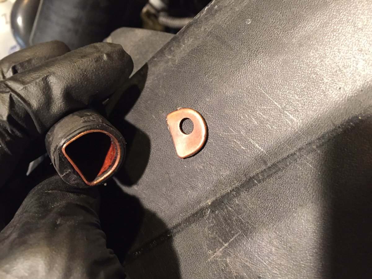

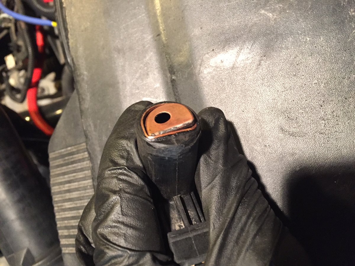

erikv11 wrote: 14 Mar 2018, 17:46
If you are thinking of increasing the orifice size in the PTC, one very easy way to do that is to just pop off the whole copper plate, the one with the hole in it. I did that on my 850 R last fall, haven't yet seen any ill effects.

I was unaware that PTC copper plate would just pop off. Much easier than drilling.

I've never seen it posted about to pop off the PTC plate, but it made sense to try and was really easy to execute for me. You might be the 2nd to try it :D
P80 PTC, dislodging the copper plate
P80 PTC, copper plate removed

You just need to make sure that hole is open, some carb cleaner will rinse gunk out. There is no valve or mechanical parts here, the electrical connection is just a heater
