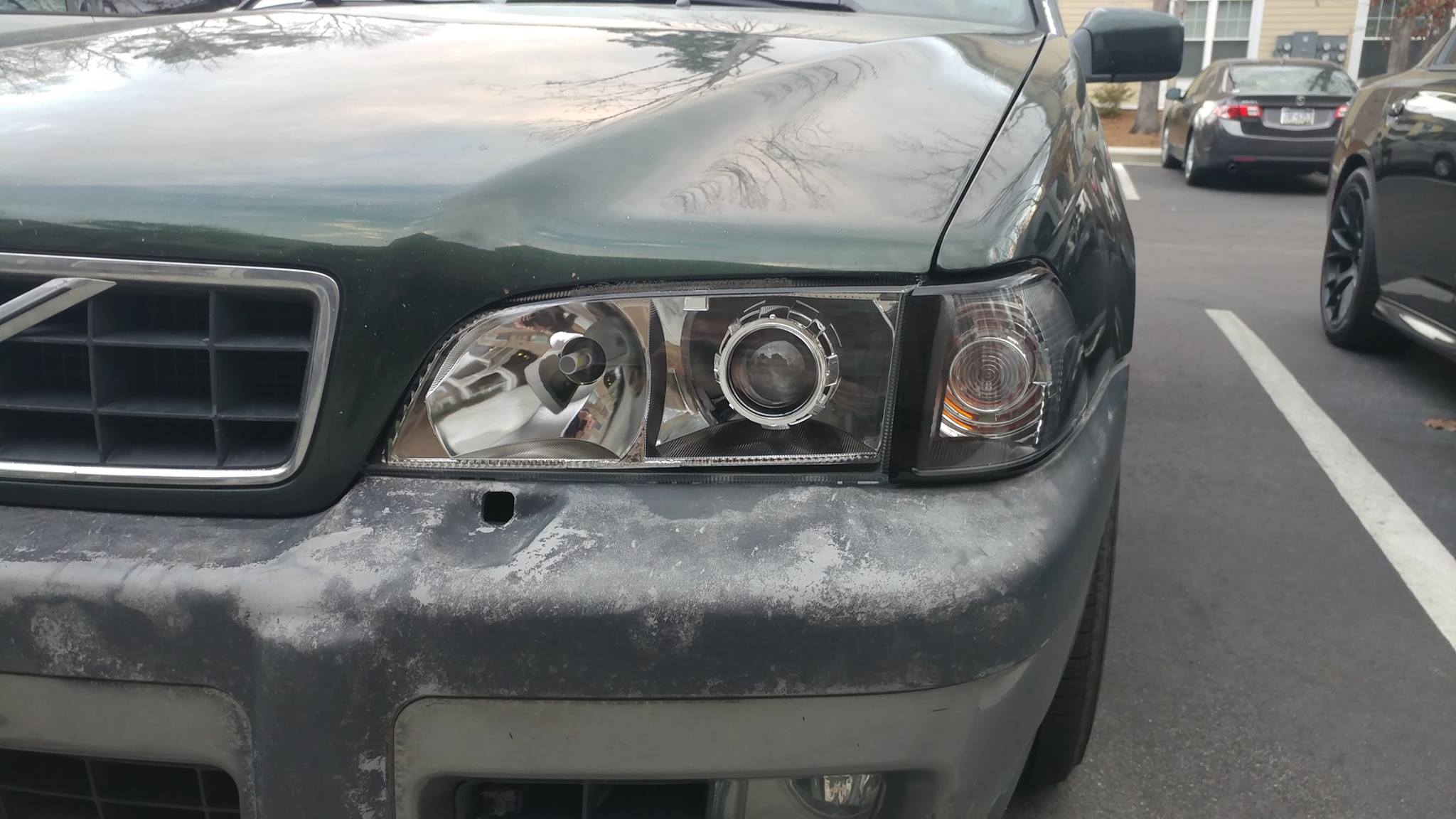

I had HIDs in my ABMs for a few years and the light output got progressively worse. I took them apart one day and found the HIDs had basically disintegrated the reflectors.nickelghandi wrote: 27 Apr 2018, 09:38Agreed. I tried HIDs in mine at first. They were bright, but had bad flickering and tended to get hot in the housing. I run LEDs now and modified the dust boots to accommodate the heat sinks. The ABMs look a bit too "custom" for my taste. Do you have a thread with your retrofit? I'd imagine it isn't too bad on these larger housings. Did you keep the H7 bulbs? What projectors/kit did you use? So many questions. I don't want to hijack this thread, but that is a very appealing idea.ecbsykes wrote: 27 Apr 2018, 08:55 PSA for those who get the ABMs: they are projectors, but there are NOT HID projectors. Don't put HID bulbs in there.
My LED bulbs of choice:
https://www.amazon.com/gp/product/B01L1 ... UTF8&psc=1
They are relatively cheap, very bright, and I have had them for over a year without any problems.
So the way I went was definitely pricey, but unfortunately is one of the few ways to properly go to HID lights. I basically took the glass from the ABMs, put them on new TYC assemblies, and then use a TRS HID retrofit kit (linked below). I now have H1 bulbs. TRS provides very clear instructions for everything and it was a pretty smooth process. I also put in LED H7s in the high beam position.
The result is amazing. When you flick on the high beams now, not only do the LEDs come on, but because the HID kit is bi-xenon (high and low beam in one), a small motor moves the shroud in the projectors and then you get full light from the projectors as well.
https://www.theretrofitsource.com/compl ... age-3.html
A few pics. Can't find one with the high beams on... though it is quite impressive. Also yes my bumper was really bad. it's since been painted and is a deep black now.

ecbsykes, that looks clean and like it is supposed to be there. Nice work! I might have to try that. I have heard/read good things about that site.
