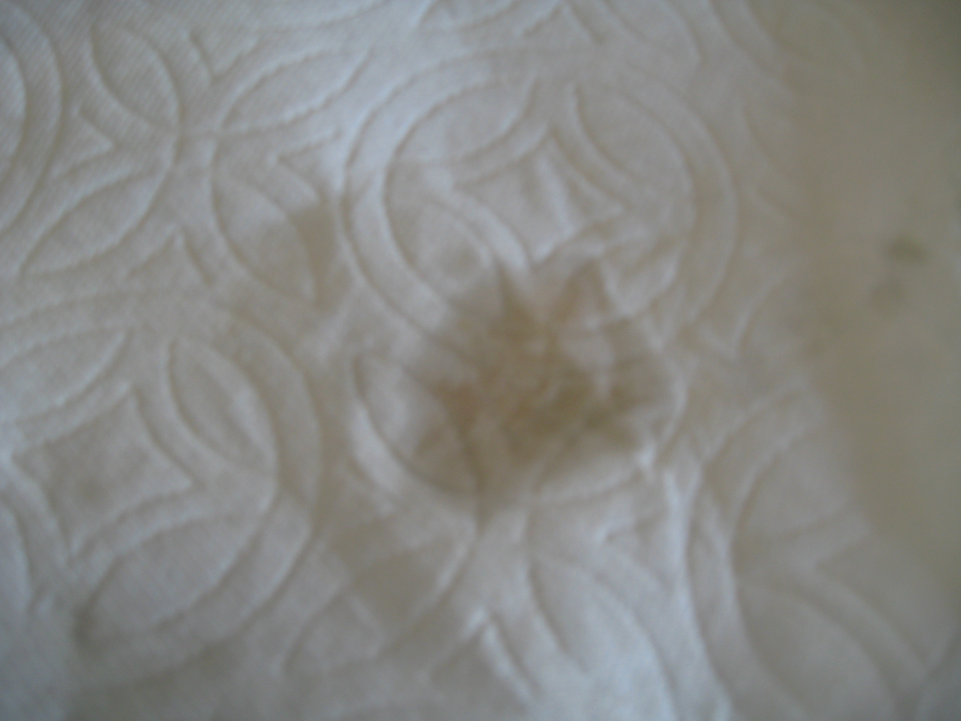

Upon a second look the fluid is more of a clear in color, I am assuming this is power steering fluid??

Post a picture of the fluid on the stick and wiped (dabbed) on to a white piece of paper or napkin.

check original post for pic pleaseSuperHerman wrote: 21 May 2018, 10:42 Post a picture of the fluid on the stick and wiped (dabbed) on to a white piece of paper or napkin.

ok pic now upDanonly55 wrote: 21 May 2018, 12:52check original post for pic pleaseSuperHerman wrote: 21 May 2018, 10:42 Post a picture of the fluid on the stick and wiped (dabbed) on to a white piece of paper or napkin.

Power steering fluid - I would use Pentosin CF 11 or 202. You should have enough to top off now and do a flush later.
