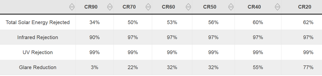

Scan that cite I gave for 3M...scroll down the page and notice different versions. Chances are 3M sells this to glass OEMs, and it is installed at their glass factory.mrbrian200 wrote: 19 Oct 2018, 10:18I'm not 100% sure what the term 'solar tint' on the Fuyao glass refers to

See chart above....where it says "Glare Reduction"Rattnalle wrote: 19 Oct 2018, 12:39Regarding a slightly purplish tint with the heat radiation treatment, could that be what makes a lot of cars look terribly wierd when viewed from the outside with polarised sunglasses?
I suspect it is a polarized film....just wear polarized glasses...they work fine

The 3m product referenced specifically says it does not result in a purplish hue. I'm looking at the glass on my car again.. the 'purplish hue' I thought I was seeing might have been my imagination. I doubt that exact 3m product is used on my glass, however.
