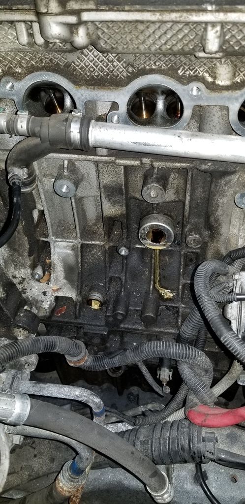

XC70Rider wrote: 24 Nov 2018, 21:31 An hour later I removed the intercooler pipe connected to the turbo. For the first time I loosened the clamps between that plastic pipe and it's rubber hoses and removed only the plastic pipe. I re-installed that plastic intercooler pipe tight and snug.
Another thing I gave a shot is further tightening the top 3 and bottom 2 intake manifold mounting bolts. I couldn't reach the bolt hiding behind the thermostat.
Neither the rubber intercooler pipes nor the intake manifold gasket was leaking to cause the ECM-121B code. I installed new Reinz rubber hoses to the over the engine intercooler pipe. I also replaced the intake manifold & ETM gaskets. A new banjo bolt and new crush washers were installed on the manifold.
This code used to appear during every cold start when I first got it last May. After replacing the burnt vacuum pump, the vacuum pump switch that was stuck open, all vacuum hoses, and the MAF it was still running 7% lean but the code didn't appear again until the temperature dropped below freezing. Today it still only appears when the temperature is below freezing. When above freezing it runs 7% lean but when frigid outside it drops to 8% then throws the code. I replaced the rubber inercooler pipes and gaskets cause I suspected they weren't expanding as much in the frigid weather. Another factor is it runs leaner at highway speeds than when city driving or idling.
Idling in park with a warm engine the MAF flow rate is 2.8 g/s (10kg/hour) which is lower than average. The other sensors to calculate air loss are the MAP, ECTS, and ETM. I cleaned all connections on those sensors, replaced ETM gasket, and checked o-ring on MAP sensor.
I'm going to have a friend blow smoke into the air intake today. I'll then hook up VIDA and get LTFR, MAF, and Throttle angle readings while driving.
If no leaks are found then the remaining culprits are bad wiring, O2 sensor, or ETM. When I cleaned the throttle butterfly valve I noticed it would close very slowly. The nylon springs might need replacing. If so MrBrian please give me a lead.
Thanks for your assistance!
