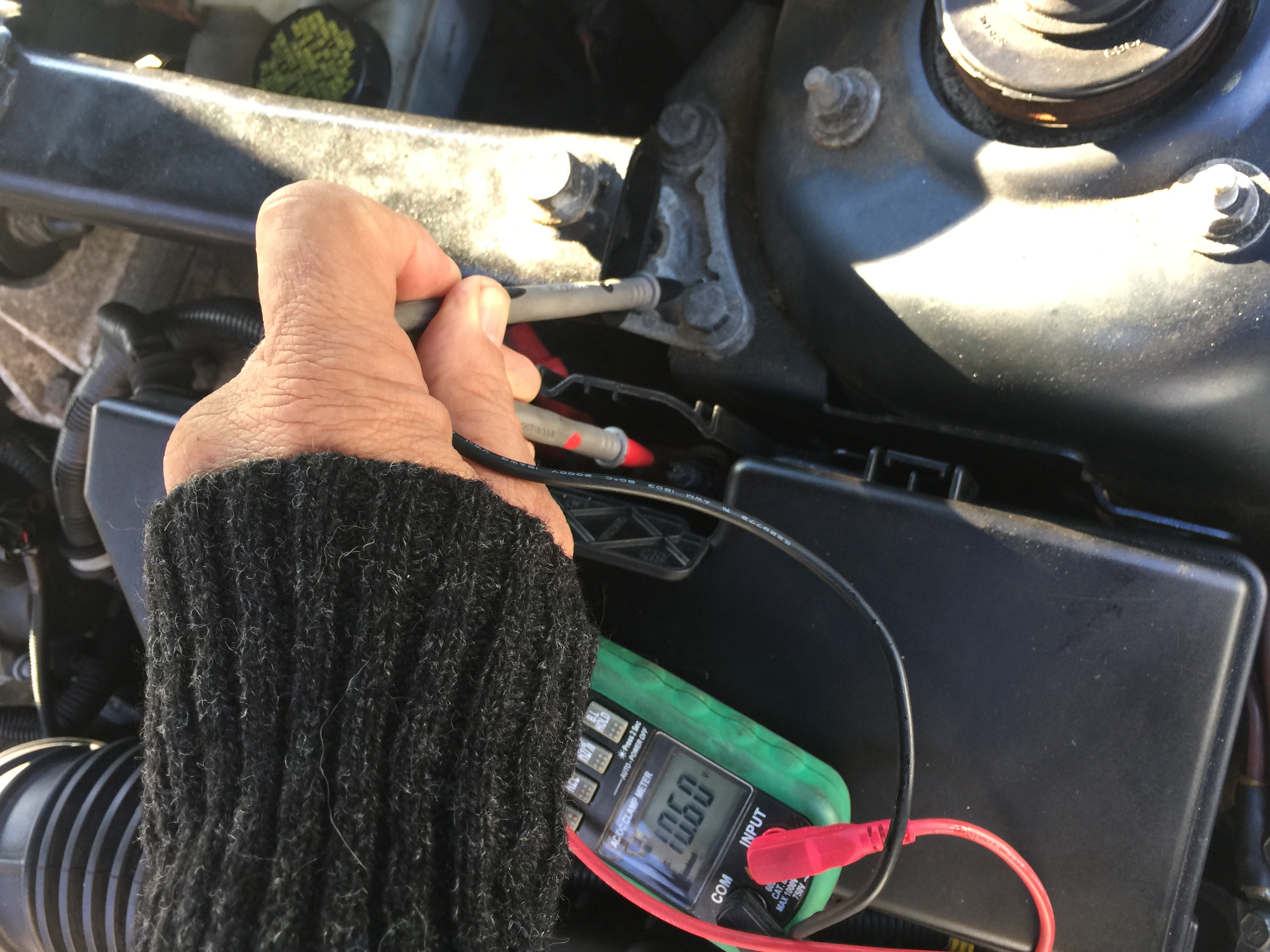

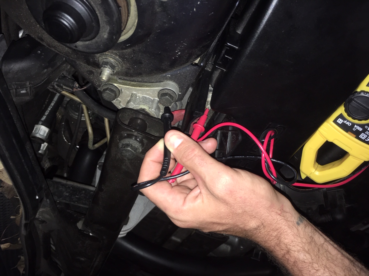

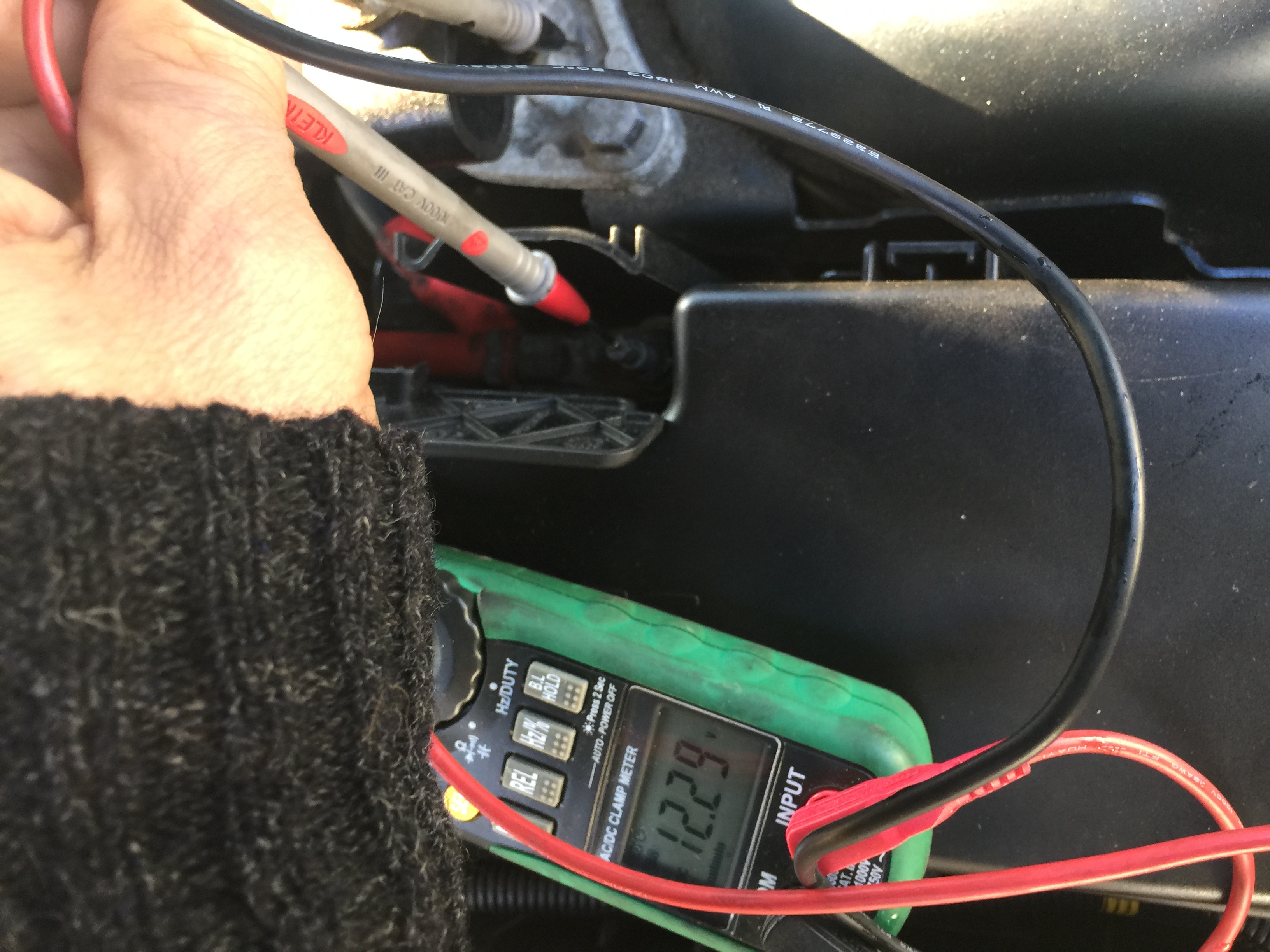

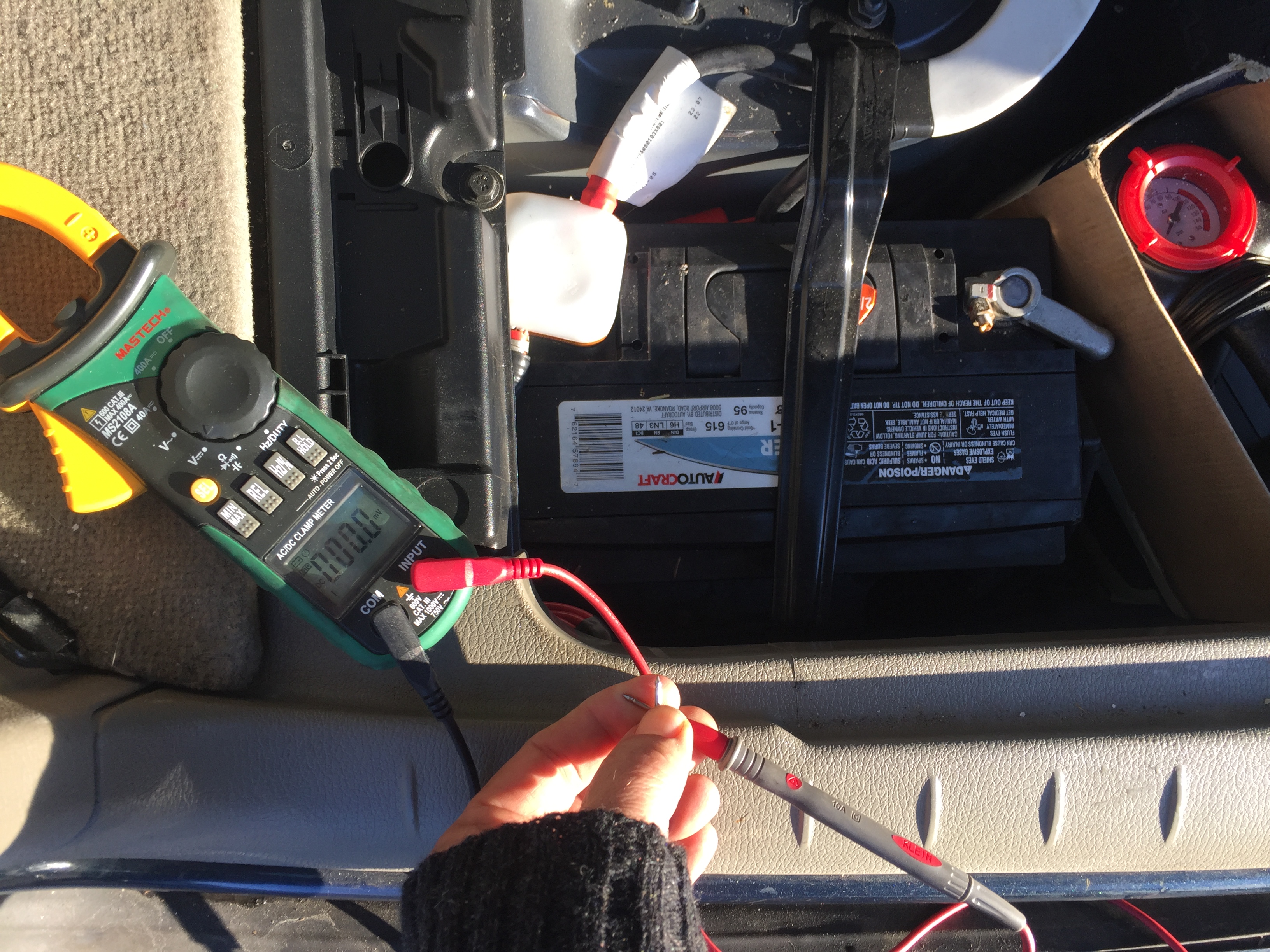

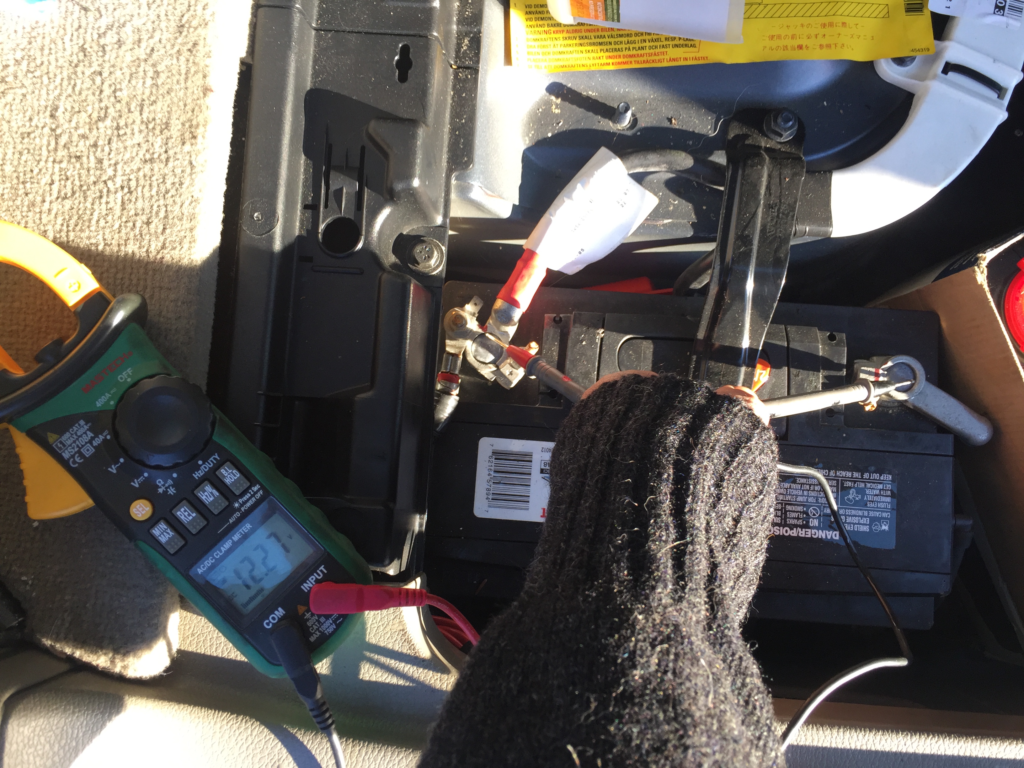

12.69V under the hood
12.69V testing points

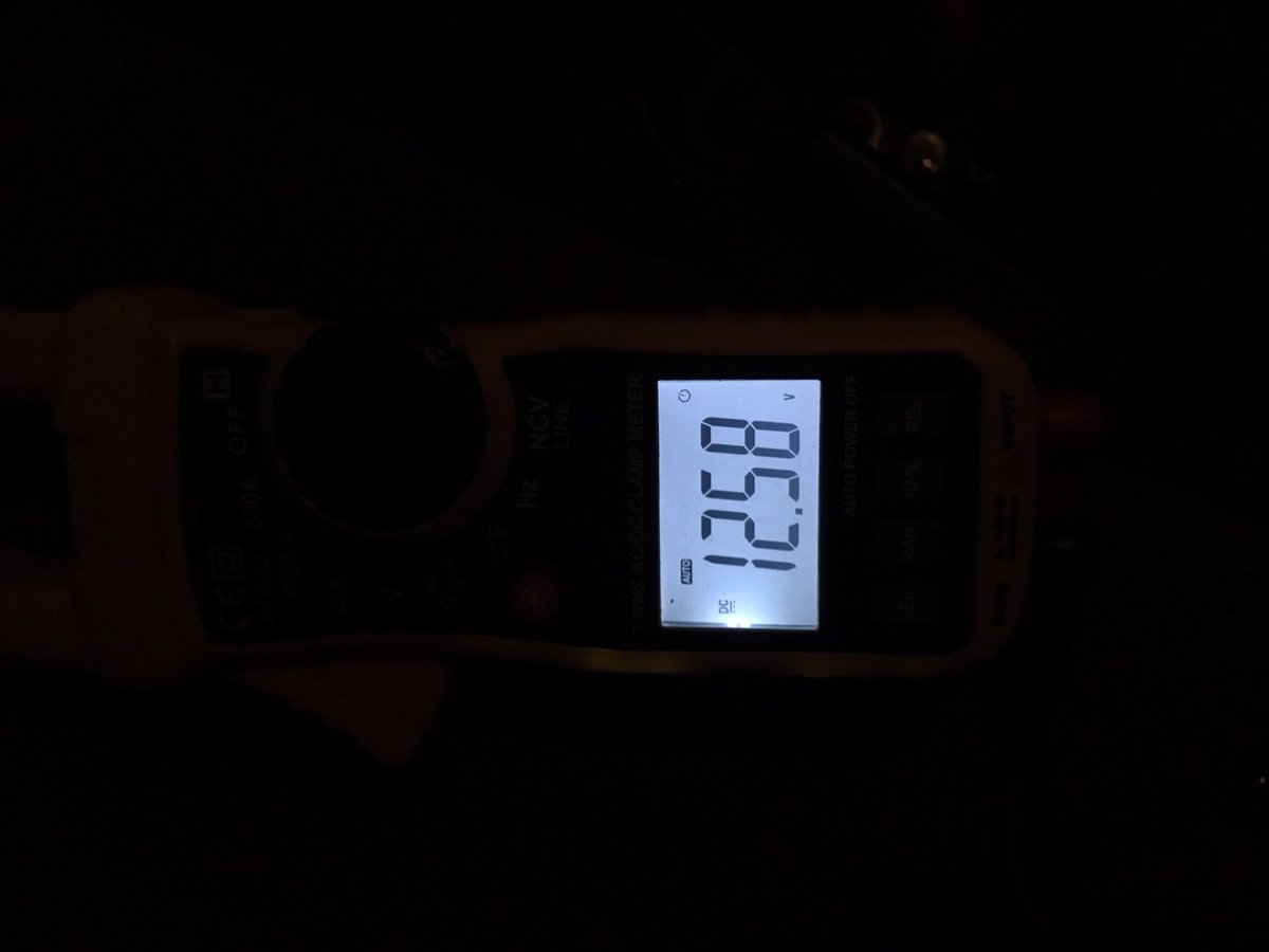

12.58V at the battery

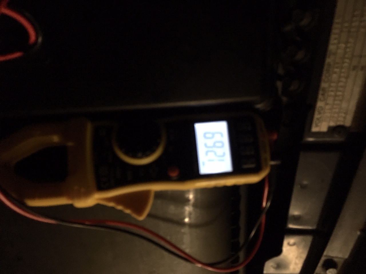

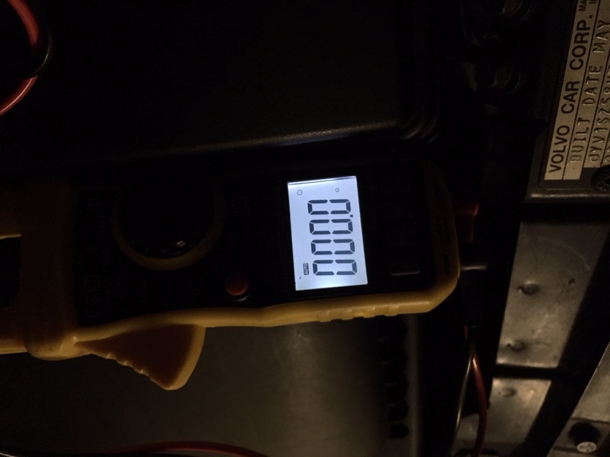

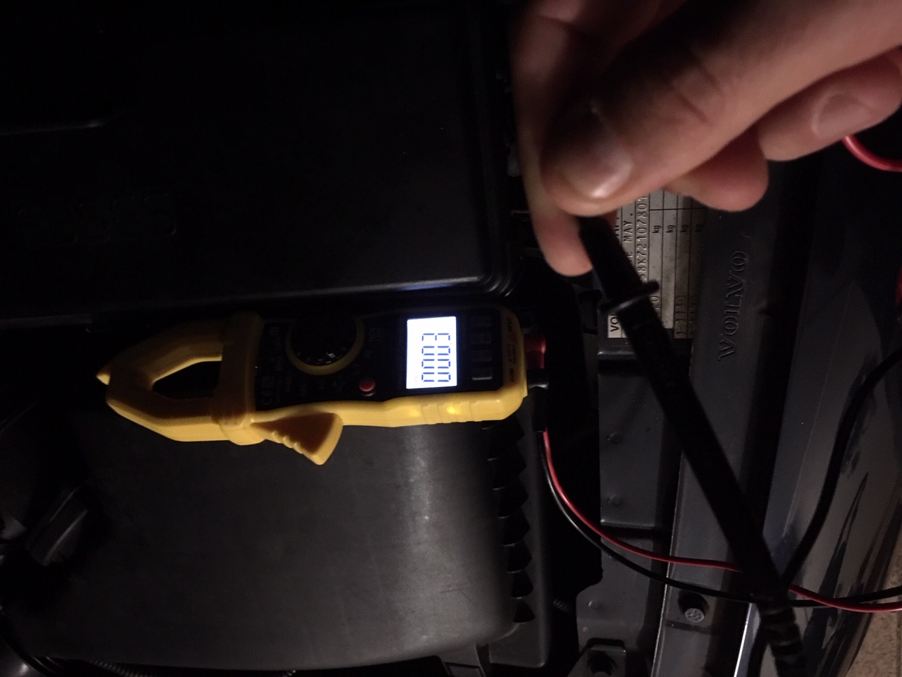

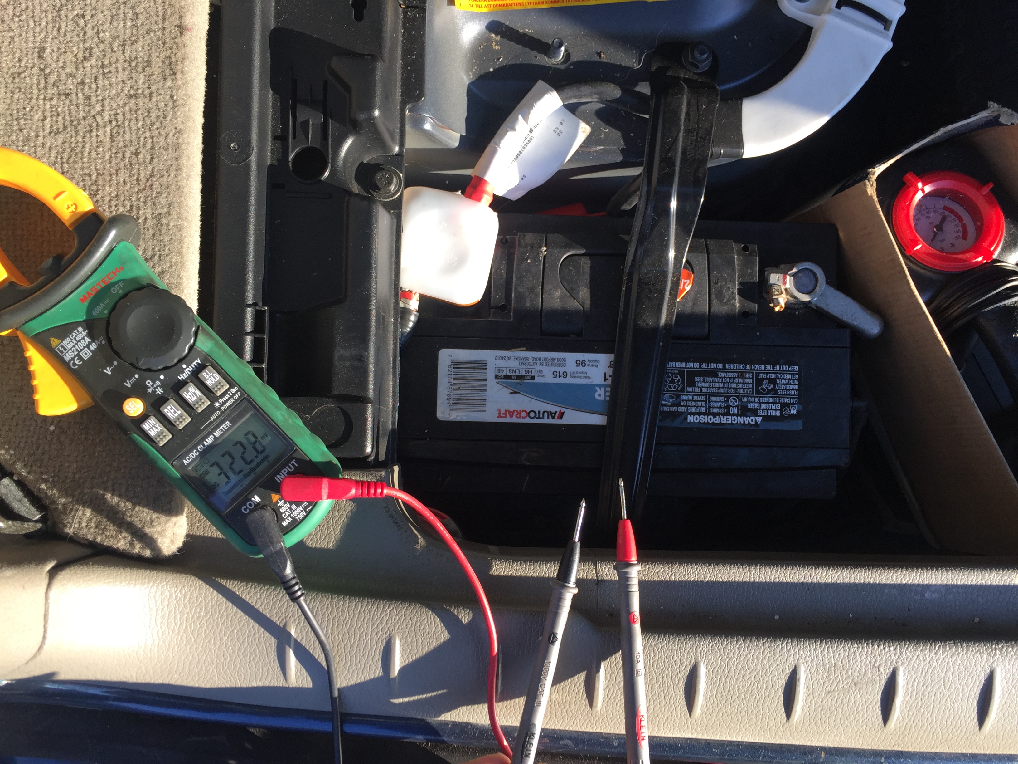

resistance touching the probes together
Resistance at the same points under the hood = 0?

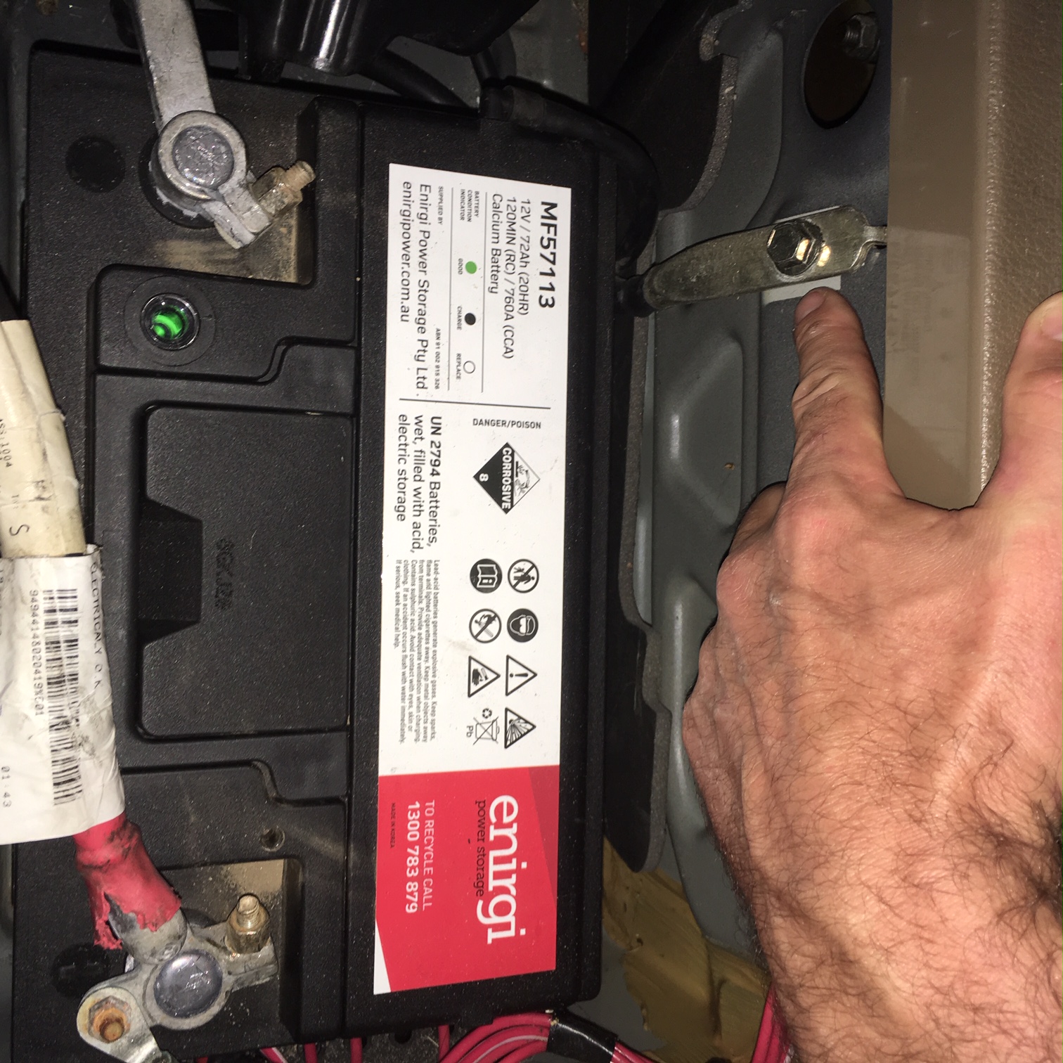

Tried this earth point for the negative in the rear batter compartment - see below - (connecting multimeter from negative to this point) but also reading zero. Tried with both multimeters as well... Where am I going wrong here?
