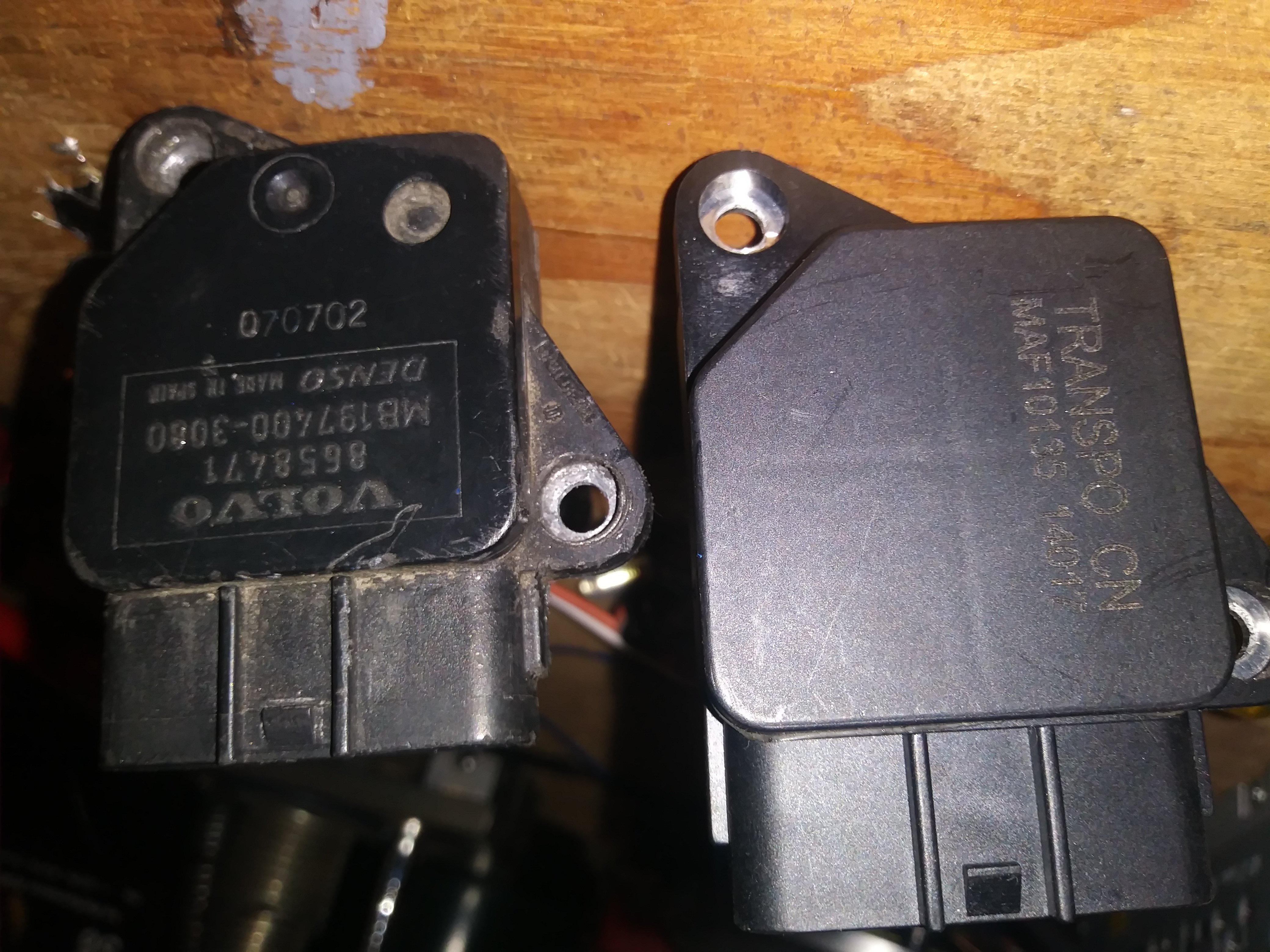

Im sceptical to connect the maf sensor because this is the 4th one i bought last one got fried my fault i tried changing the wire pin out locations because the p0103 code wouldn't clear. I dont understand the reading im getting now .....

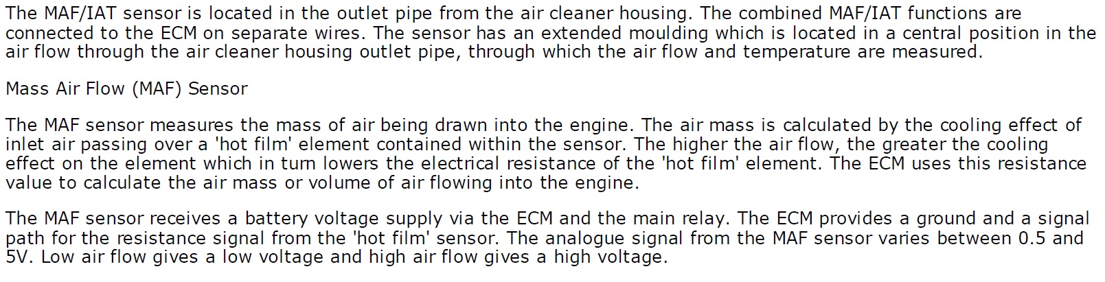

MAF/IAT sensor description from the manual
