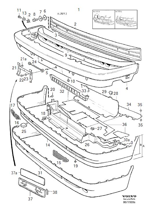

Revisiting this conversation with a followup. It seems that these 850 front bumpers have a "cover" (see attachment, part #4) which looks like the top black part that fastens to the bumper frame. I have not been able to take my bad bumper off yet but was wondering if it is practical to just buy the cover and swap that out. Looking at the parts diagram, the bumper assembly looks like it is modular but I don't know how practical it would be to try to disassemble it and reassemble with a new bumper cover. Wondering if anyone has experience with this.

I have not done this with an 850 but have with a V70. So it should be do-able. The one point that was made was that it looks like the metal part of the bumper has been either crushed or pushed back on the driver's side. You will have to remove the full assembly to check what damage has been done to the bumper mounts at the front of the frame rails and possibly the rails themselves.
With this all removed you will find it easier to swap the cover over.

Good points all! Good to know Neil that if you did this on an V70, it probably is similar with the 850s. I guess the only way to know for sure is to detach the bumper and see how it comes apart. I was hesitant to take the bumper off before the claims rep/adjuster could examine the car, but not sure when/if that will happen and they said they just need to see the damaged parts. Of course I have the pictures.
Forgot about the earlier front rail comment, but I could see it fully exposed and it seems to have the correct symmetrical bends on both sides (if we are talking about #2 diagram above and there is no other reinforcement rail behind that which could be slightly bent).

The bumper if I recall is held on by a couple of long bolts through a bracket on the end of the rails. These need to be removed to be able to slide the whole assembly forward to remove it. The brackets are possibly rotted/bent as well as the bolts. Behind all that there are mounting plates on the ends of the frame rails that can easily be bent, but possibly straightened again.
