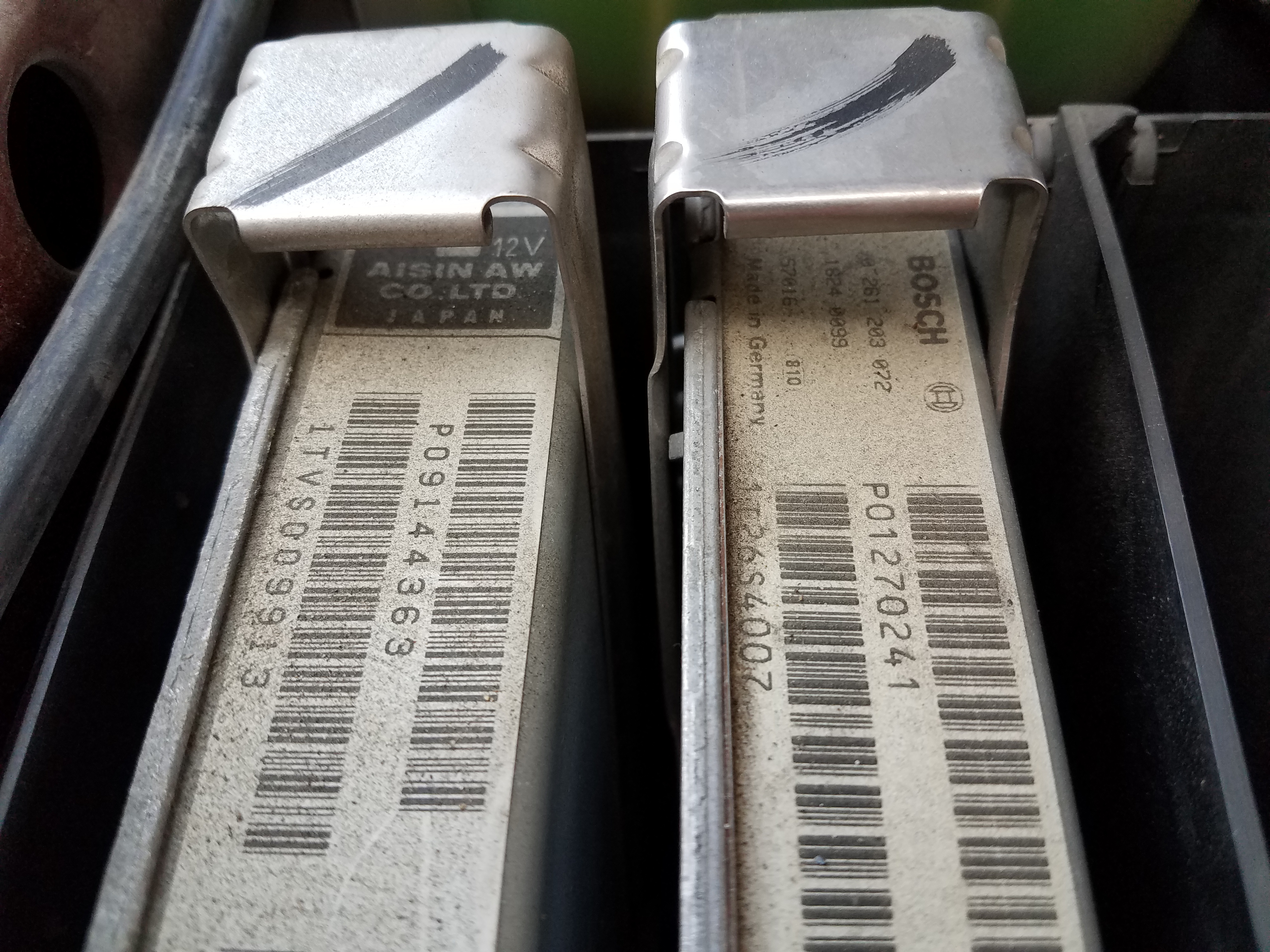

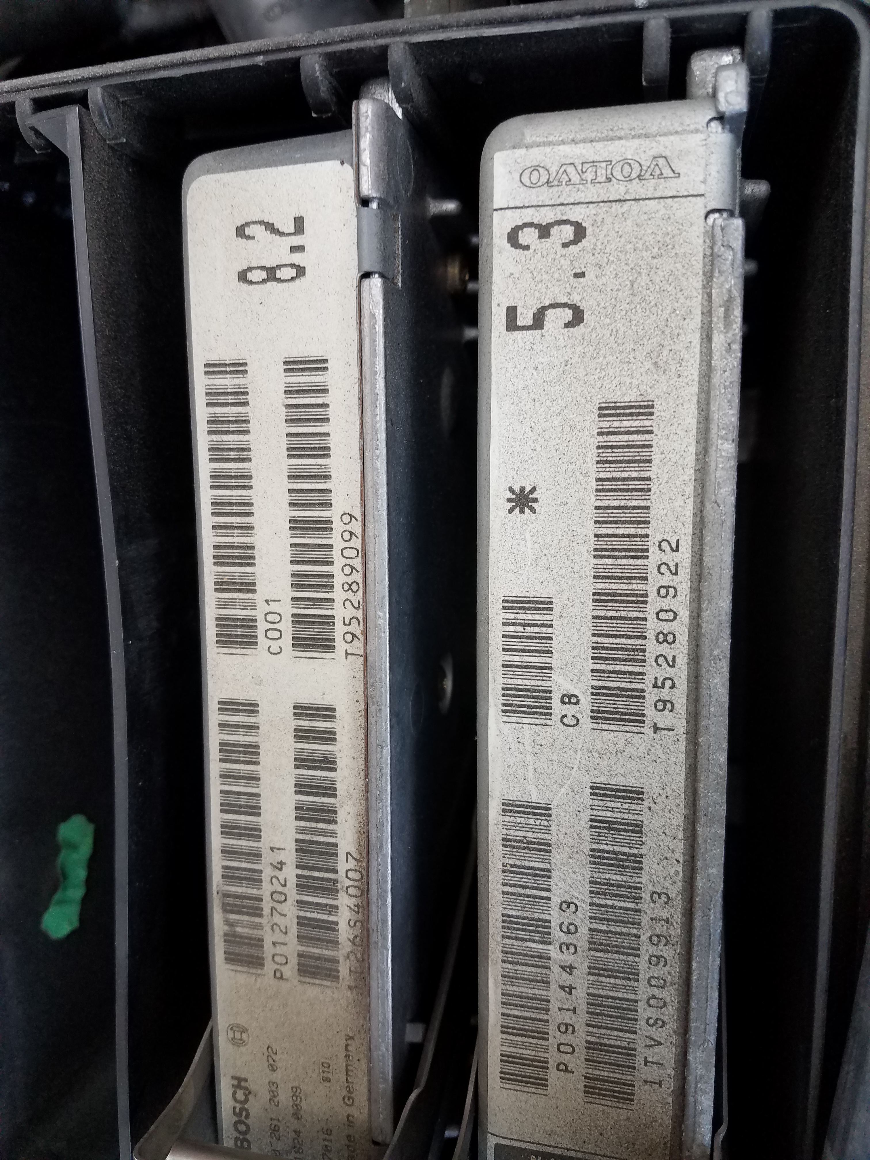

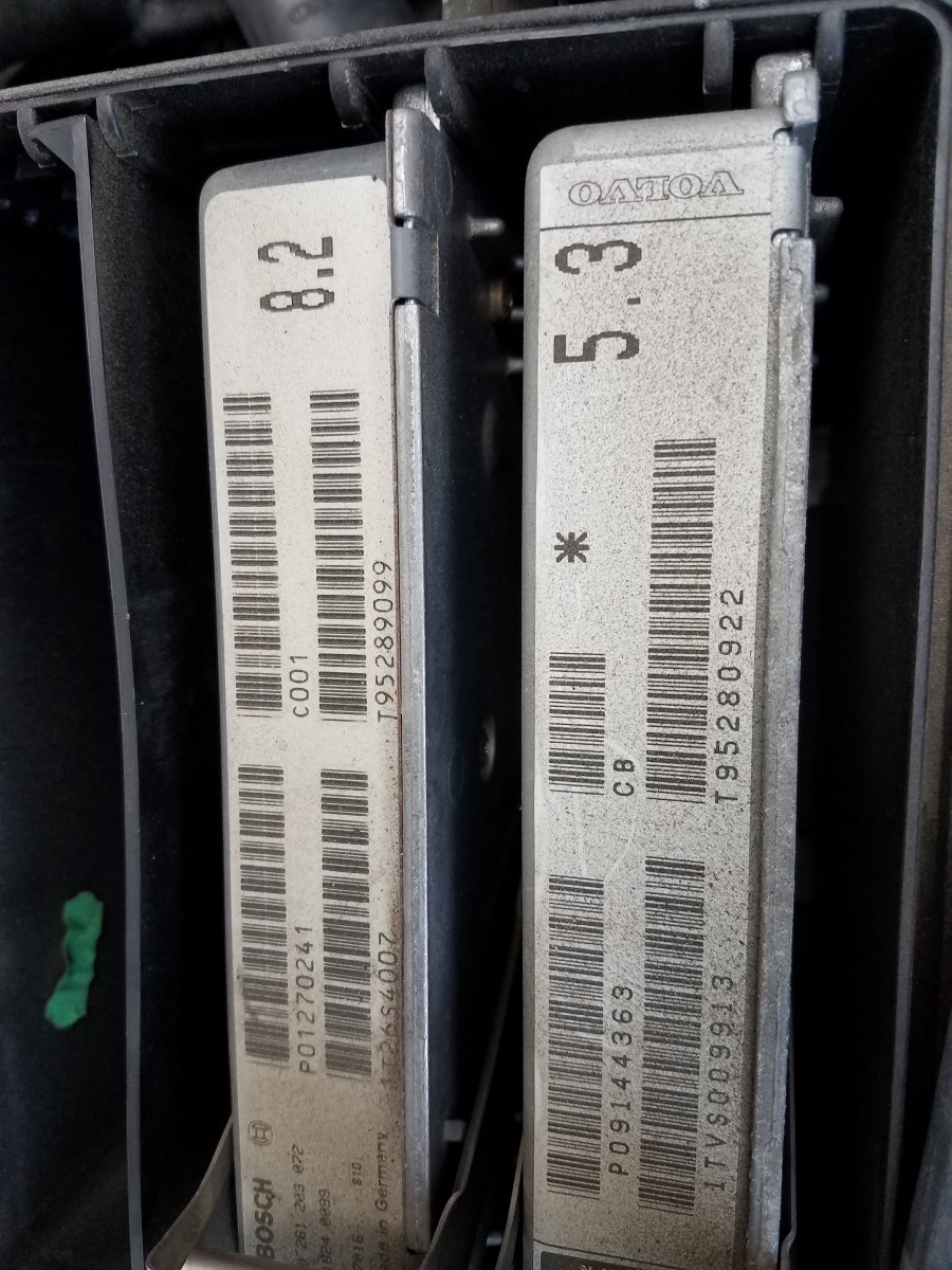

Evap cleared on a full tank this morning. Posting pictures of my ecu just to make sure I have the right ones.
