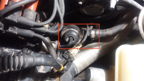

I just saw an N/A 850 doing the same thing and it turned out to be a hard to see cracked vacuum hose in the EGR system (not vacuum line, one of the 1/2" ones). Crack opens car dies and wont start. Crack closes it runs.

What exact hose is it you're mentioning boss? If it's the one next to the intake that may be my exact problem because I'm aware of that and wouldn't expect any pcv stuff to make it stall. I don't have emissions so it's not a problem for me. Unless obviously it makes me stall in the rain lolgreg850r wrote: 08 Jan 2019, 20:29 I just saw an N/A 850 doing the same thing and it turned out to be a hard to see cracked vacuum hose in the EGR system (not vacuum line, one of the 1/2" ones). Crack opens car dies and wont start. Crack closes it runs.

The 1/2" hose on the right side of the red box was coming loose from the round control valve. Vacuum leak here caused it to die and no start.
V70buddy wrote: 30 Jan 2019, 00:36What exact hose is it you're mentioning boss? If it's the one next to the intake that may be my exact problem because I'm aware of that and wouldn't expect any pcv stuff to make it stall. I don't have emissions so it's not a problem for me. Unless obviously it makes me stall in the rain lolgreg850r wrote: 08 Jan 2019, 20:29 I just saw an N/A 850 doing the same thing and it turned out to be a hard to see cracked vacuum hose in the EGR system (not vacuum line, one of the 1/2" ones). Crack opens car dies and wont start. Crack closes it runs.
