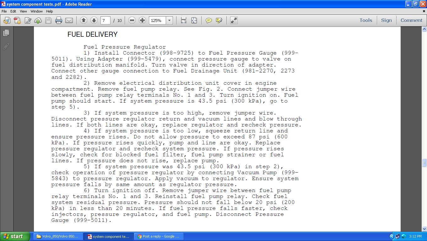

Again, I don't know which "specs" those are. The greenbook says nothing about pressure going down when there's vacuum connected to the FPR. The testing procedure for fuel pressure only says this:
"Turn ignition on. Fuel pump should start. Fuel filler
cover can be removed to determine whether main pump is operating. Fuel pressure should be about 43.5 psi (3.06 kg/cm )."
There's also further points to that procedure, in order to troubleshoot, but only says to not let pressure exceed 86 psi. Nothing about lower pressure than 3 bar being normal.

Fpr is dictating what fuel pressure would be in the system...not the pump.
Fpr is vacuum controlled...that said....pressure varies as vacuum varies....Fuel pressure is not steady in all running conditions.
It's not exactly 2.4-2.5 bar at idle...i said it's AROUND 2.4-2.5bar at idle...BUT it MUST be 3 bar at 1st prime before starting the engine and wot on healthy fuel system...although everything around 35psi is acceptable.
You would have constantly 3 bar pressure in all running conditions ONLY if vacuum line from FPR is disconnected and engine side plugged.
