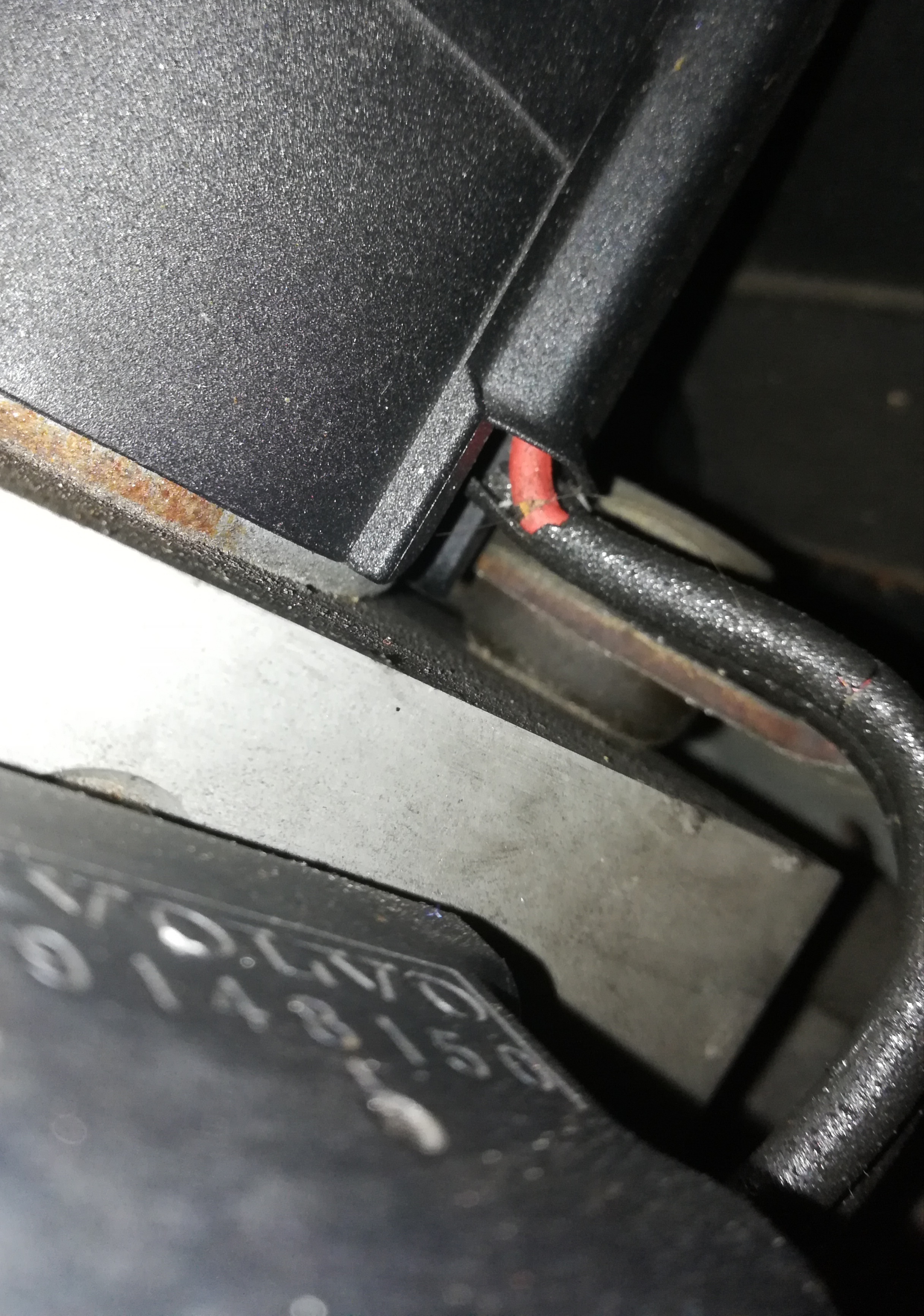

if it is a 96 MY: check the big black insulated wires that run to the ABS module. The insulation tends to crack on these wires, oipening up room for corrosion. A few months back my ABS light came on after already resoldering the module twice a few years ago. Upon inspection, the insulation had crumbled and the copper had corroded green. I sprayed WD40 (or sthg. similar) on the wires and the problem was gone.
Edit: Maybe this bad insulation can be found on earlier 850ies as well, but definitely on 96 up.
