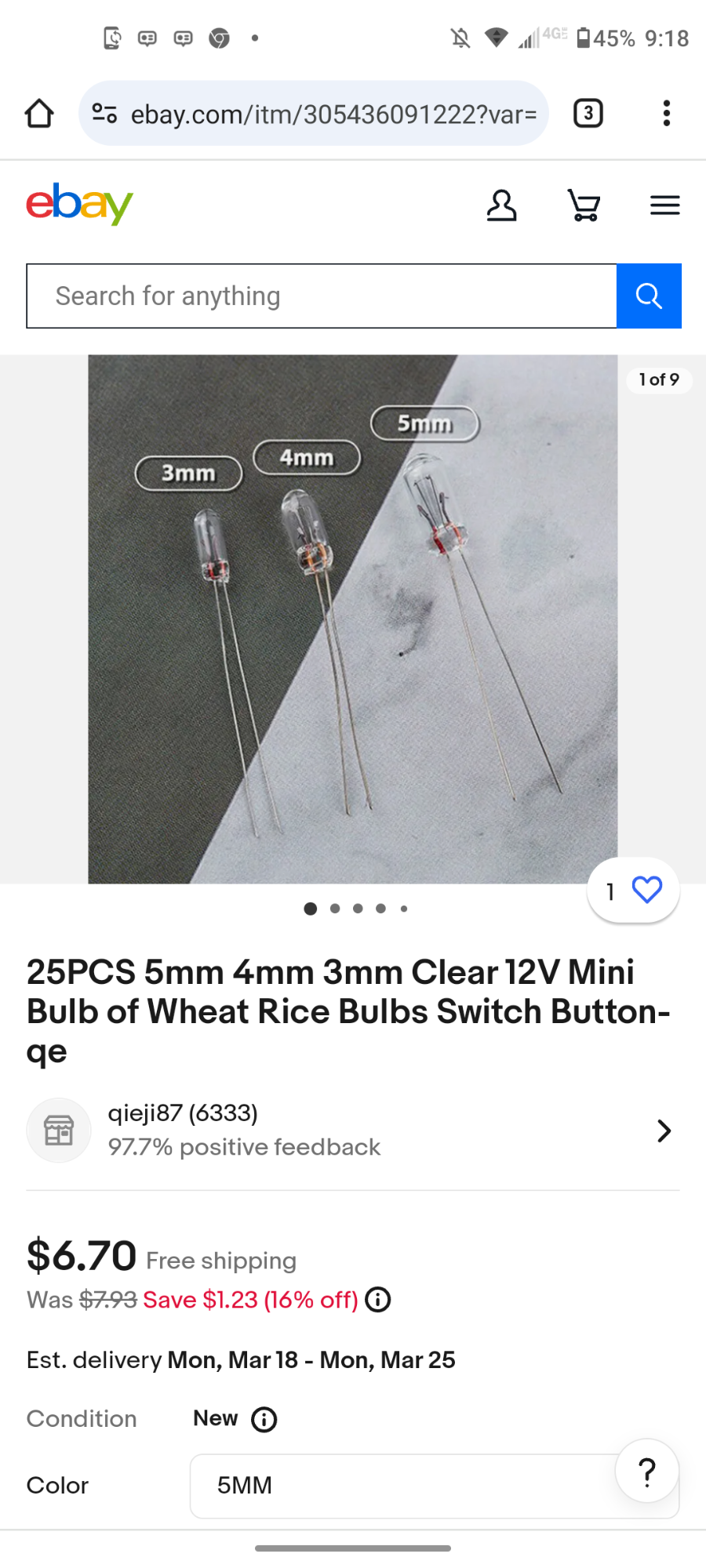

Just stumbled across this...
If you go to eBay and search "Wheat Rice Bulbs Switch"...
You will see sellers listing 25 bulbs (just select size 4 mm or 5 mm) for $6.70 = ~ 27 cents/each.
I have not tried these eBay bulbs yet, but if anyone tries, please give feedback...
