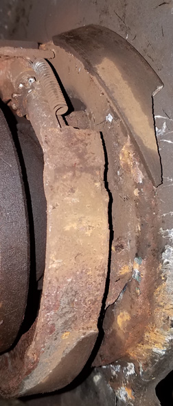

The rear rotors were long overdue, which probably explains why I had to wrestle them over the e-brake shoes, damaging the left rear shoe in the process. Even with maximally loose e-brake cable and star adjuster the left shoe wouldn't clear the thick collar of rotor rust.

And after such a nice set of new rear pads and rotors ... sudden bad noise and I discovered the broken e brake pad shown in the image. The fragment is placed on the inner liner (whatever it's called). Must have been damaged when removing the old rotor that did have a very large rust lip and took a lot of "coaxing". Not surprising given what I went through to get it off. Should have examined more carefully for cracked e brake pad, obviously.
So ... can you recommend a good set of replacement e brake shoes/pads? I don't know if there is much to choose between or if it matters much as long as they fit. Or maybe it does matter. The e brake mechanism seems OK and functioned fine before the pad broke. The e brake cable could use some work but that's another story.
