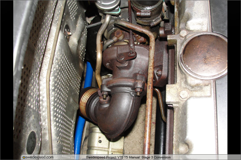

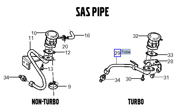

Oh of course!
I've never had a turbo with SAS so I didn't think about it, but on a turbo car the SAS valve mounts into the downpipe (use pipe #34) not on the exhaust manifold. There is no SAS bung in a turbo exhaust manifold. For an NA the SAS valve mounts into the end of the exhaust manifold (pipe #11). I think there are even NA manifolds with the bung further down, as well.
Turbo car setup: and this

The “ dual valve “ picture above is a bit confusing, but Volvo diagrams will show different versions of a system on one page, so that one gets confused.

Case closed!erikv11 wrote: 26 Apr 2019, 16:13Oh of course!
Turbo car setup: 025.jpg

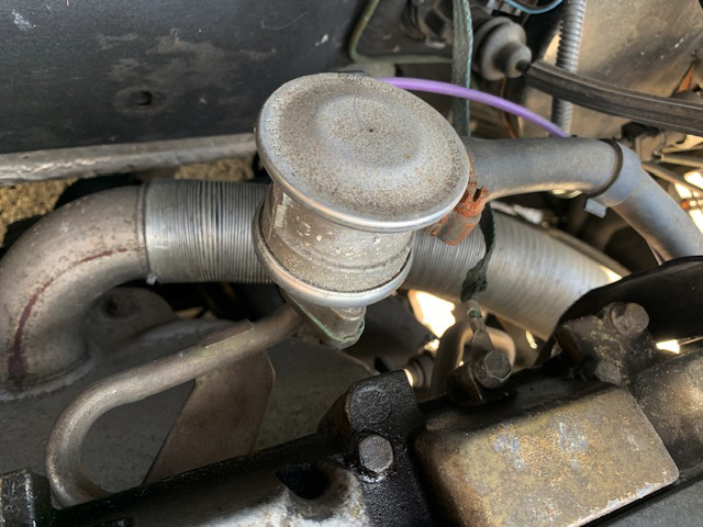

Correct, but I'm used to it idling close to 850rpm in "P" with engine warm.misha wrote: 27 Apr 2019, 12:20 N/a with automatic transmission is idling close to 1000rpm when it's in "D".
Should I just go ahead and service the valve -- hose connections for damage, repair, and replace gasket?
Here is the setup:
- misha
- Posts: 5437
- Joined: 07 Dec 2008, 16:09
- Location: Serbia
- Has thanked: 155 times
- Been thanked: 432 times
Sas valve is not serviceable.
Internal diaphragm is usually burnt over and because of that it gets stuck open.
If it's allready stuck open...air pump is on it's way out too since all condensation from exhaust manifold ends up via bad sas valve into the pump....after that on wot ends up in the air filter messing up Maf sensor.
I got 2 maf sensor failure due to this problem untill i realized where from all that water(condensation) ends up into air filter.
Sas delete is my advice ...since it's useless.
