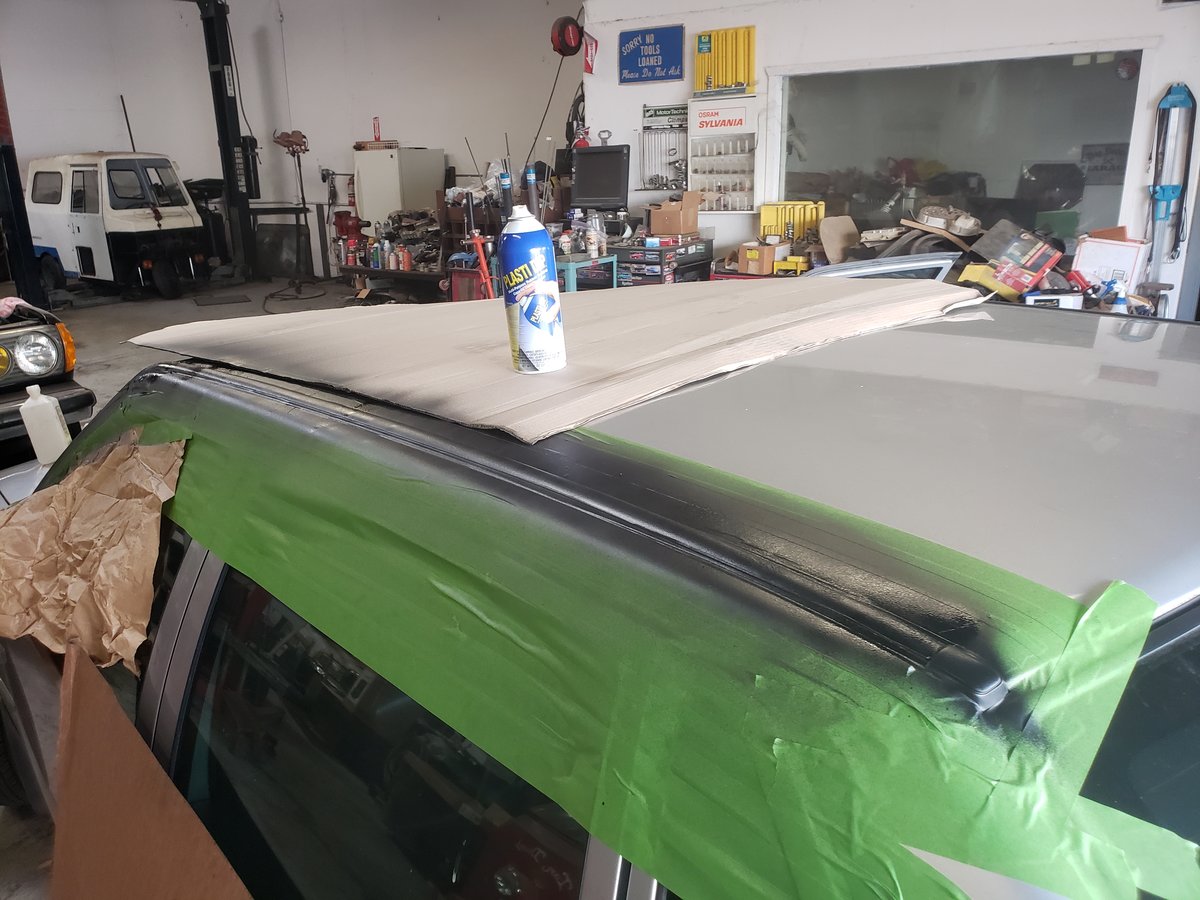

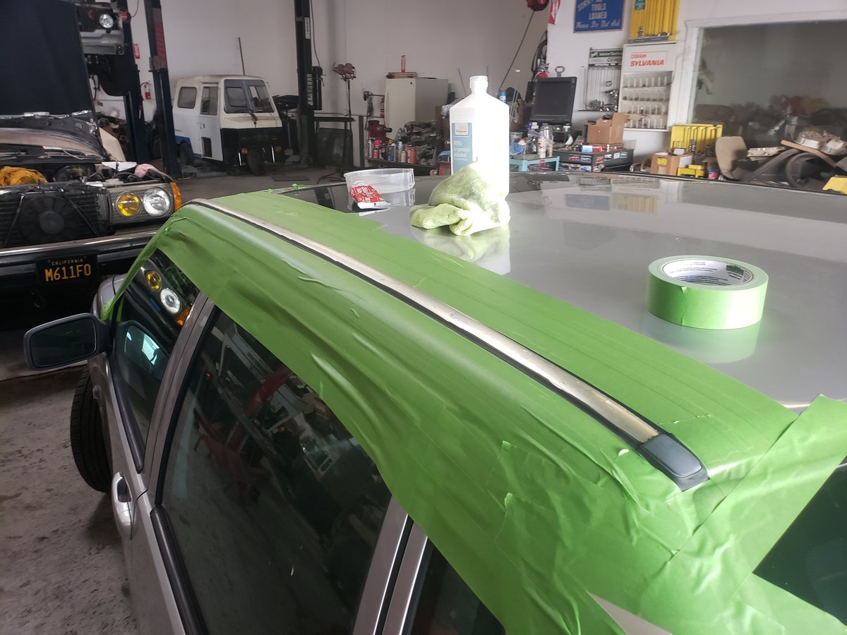

Well I couldn't find flexidip locally, so am trying my luck with plastidip for the drip molding. Just doing one side to start. Pics attached, and yes I know I used too much tape.

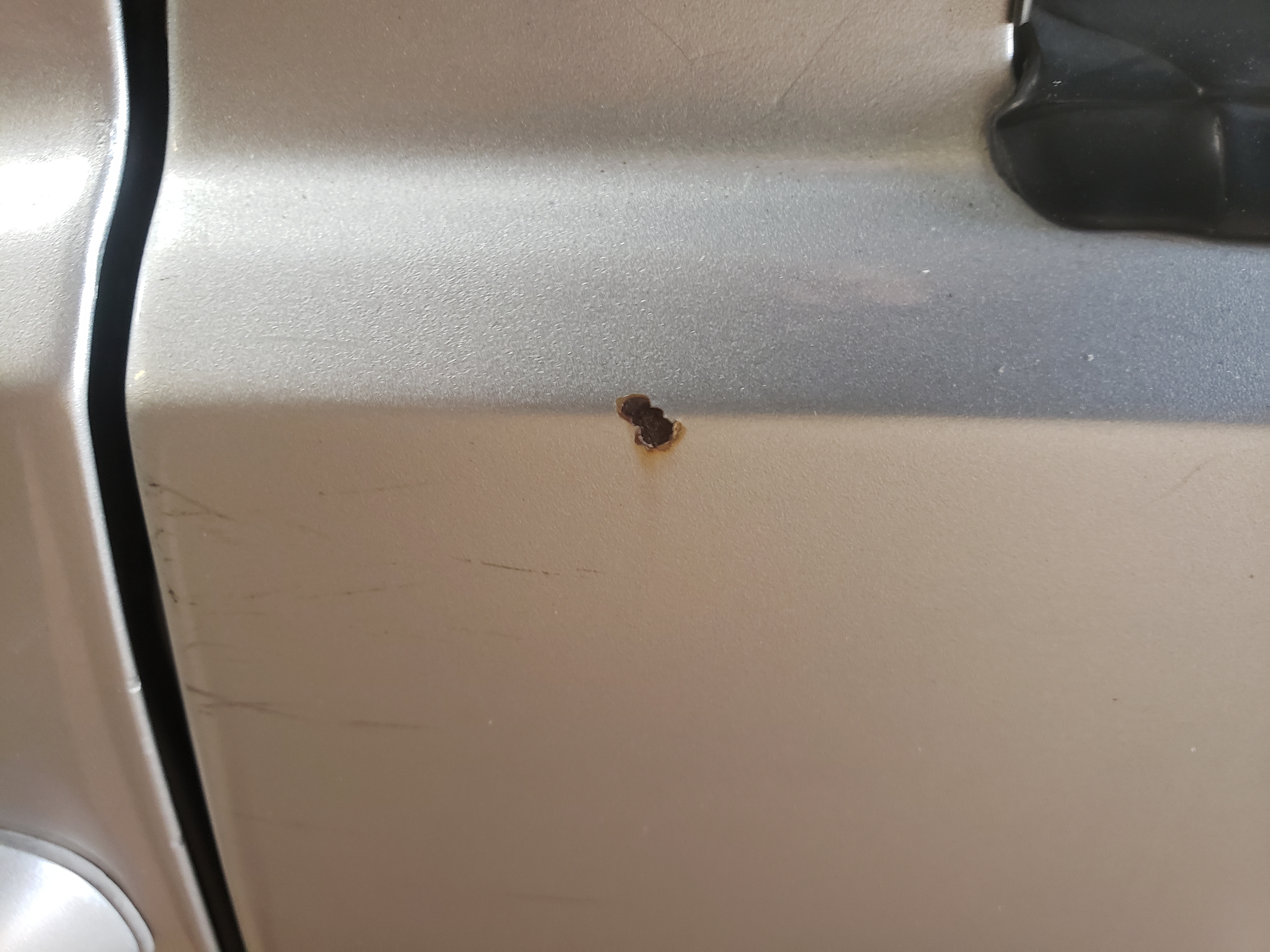

I have a small rust spot where the paint got scratched (only one! whoo hoo!), any MVS wisdom on a good fix? Where to get touch up?

The results of the plastidip were very mixed. Very hard to remove the masking tape without peeling the plastidip. I wouldn't recommend it unless you're much more crafty and careful than I am. I'm guessing good electrical tape would do a better job, and I'll probably try it on the other side.

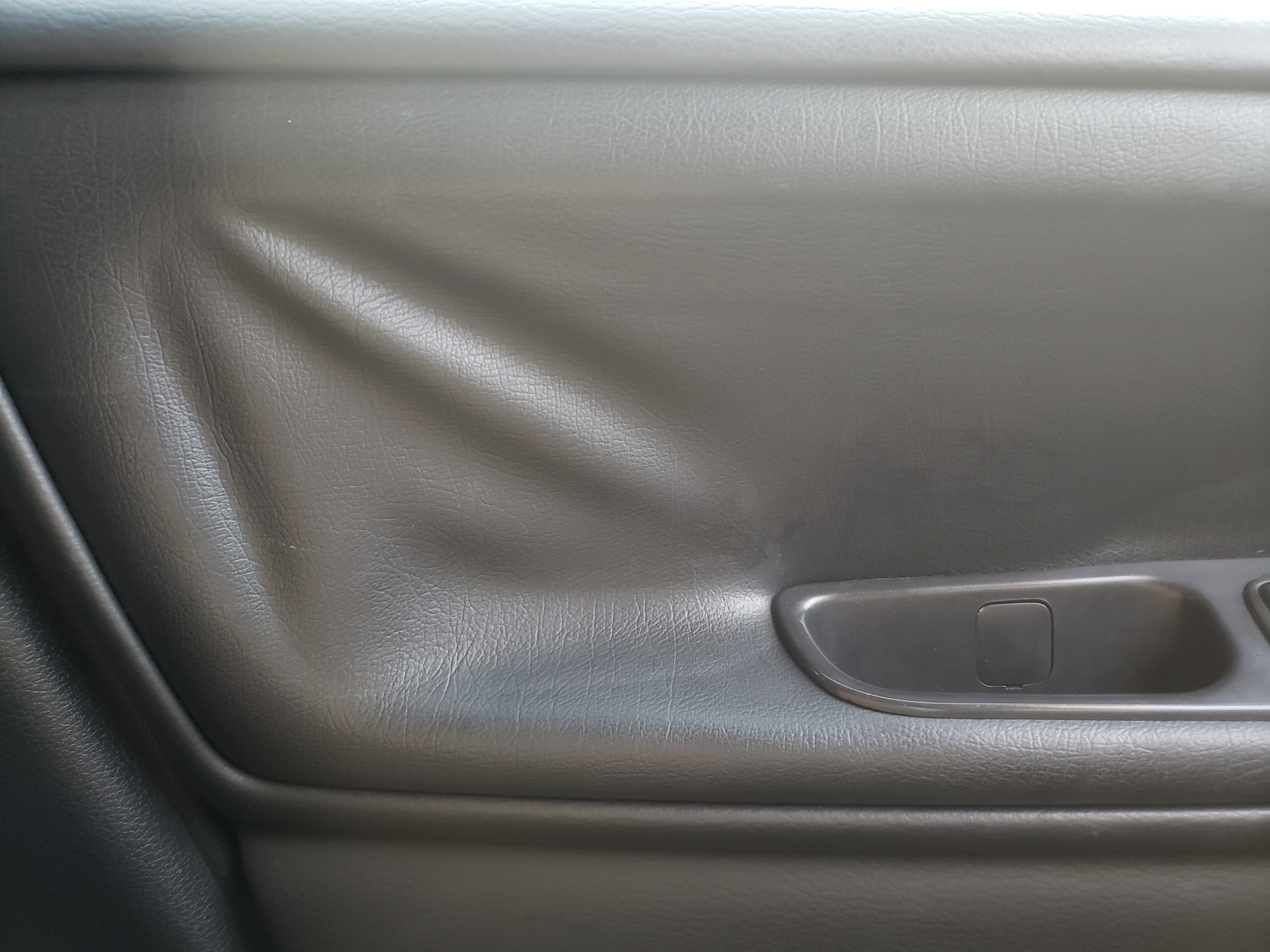

Does anyone have a solution to the shrinking arm rest issue caused by the vinyl shrinking in the door panels? Both my front doors have it, pic attached. I was thinking about cutting a slit and then patching with another piece of vinyl?

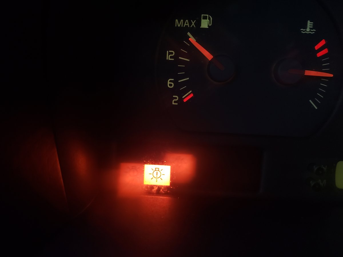

Also, I'm getting a warning light on my dash that a light is burned out somewhere. There isn't one as far as I can tell. Any tips on that by chance?

That wrinkle is a natural part of a Naug animal and the variations in shape reflect its individual character, not flaws.
Someone probably put a mismatched bulb I; one of the holders, which detects current differences, ergo the lamp.

Aha good tip on the bulbs. Argh, this is going to fun to track down.

A burnt out bulb that stumps a lot of people is the one in the center third brake light - is it working on this car?

Since I posted pics of doing the plastidip repair to the drip molding, I thought I'd post a pic of how it came out. At first I thought it came out kind of rough, since it got a little scuffed when I was peeling off the masking tape (under the rack crossbar for example). But I've come to really like it, and I think the blemishes are the kind of thing only I'd notice. This is 4 or 5 layers of Plastidip, prepped by removing the old vinyl or whatever that was with a razor, then cleaned it with degreaser.

To address your "rust" spot I would take a dremel and remove as much rust as you can without cutting a whole. Then get some Rustoleum primer to fill the hole. I would highly suggest brushing that on vs. trying to spray.
For touch up paint I use this company:
http://www.automotivetouchup.com/index.htm
I've had very good results with their paint.
You might have to do some sanding to get it perfect and then polishing of course.
