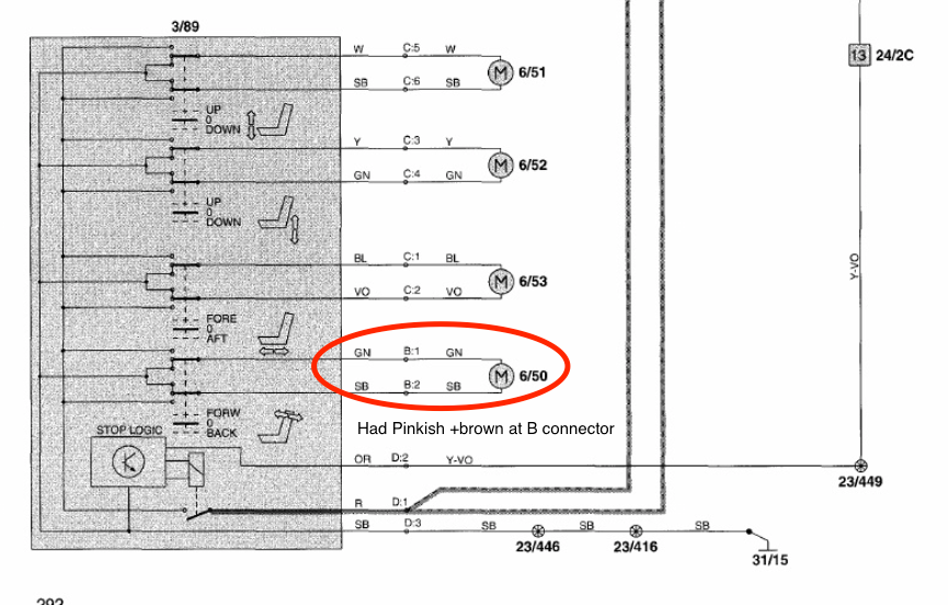

After reviewing my pictures, i realized that the seat recline wire colours do not match up with the schematics for an early 2000 vehicle. The colour scheme i have for connector B (refer to page 292 item 3/89) is brown and pinkish, while it states it should be brown and green. I believe this might be evidence of an earlier repair or something, however when i tested the neutral state of the wires, i had full conductivity between the two.
relay diagram for passenger chair (No Memory)
(it seems the switches just change the "polarity" (which side has the higher voltage) to effect motion in a certain direction. Power distribution is done in the seat controls with a BJT + IC used as a current sensor to detect when the motors reach their limits. )
This matches up with the diagram, leading me to believe that the motor or wires leading to the motor in the seat are dead. I did not hear any sounds indicating a stalled or seized motor so i don't believe that it is a case of a busted switch. However, i mistakenly did not check voltage on the switches so i could be wrong if the switch has a break in its connections to the power supply lines.
