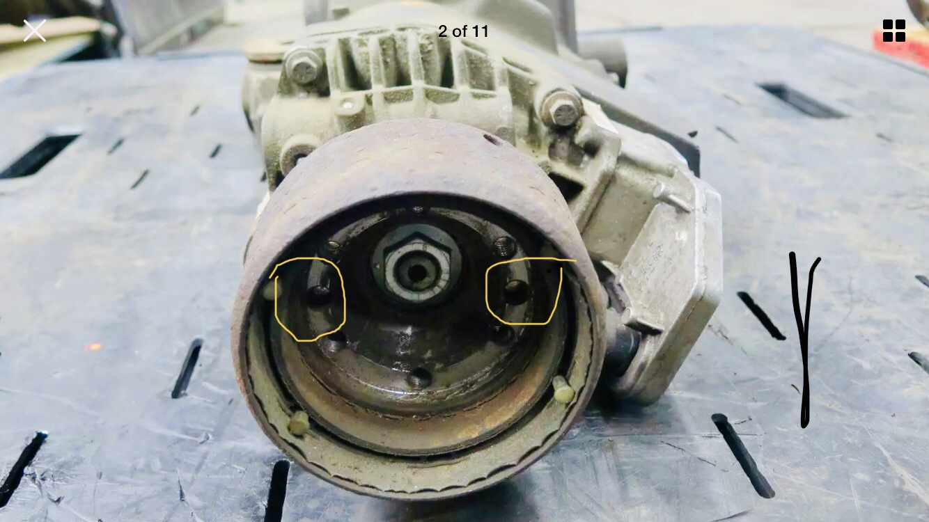

I assume you cut into your oscillation damper cuz it seemed impossible to free the driveshaft from it otherwise?
I considered something along those lines, but removing the front of the driveshaft from the bevel gear output taught me a different trick.
See theses two circled holes on the input flange/oscillation damper? These two are NOT threaded.
I took a bolt about the same size diameter as the 6 that came out (don’t use one of the 6 you removed), about 3” in length, fed it through from the back side of the flange, then used a long pry bar to exert force on the head of that bolt. This forced the CV joint forward, out of the oscillation damper. To get the joint fully free of the flange I had to disconnect the hanger bearing (2 bolts), exhaust center support (4 bolts), and also disconnect the front of the driveshaft from the bevel gear output flange.
Then just blast the 24mm nut off with your impact.
So if your AWD was working why did you remove the pump? Just for inspection & cleaning/filter replacement?

Removed it just for basic maintenance to fully clean out Hakdex oil. The oscillation damper was so badly rusted I knew if I waited any longer it would be impossible to remove the driveshaft. I did get the CV joint out of the bevel gear successfully. I tried your method of prying the rear CV joints out of the damper with bolts but it wouldn't budge. If you read that thread I also threw on new CV joints.

Mine was pretty crusty too, 15 winters of MN salted roads!
After liberally applying Kroil, I first tried smaller pry bars, eventually worked my way up to about a 4’ footer and out she came. Pinion seal remained perfect.
