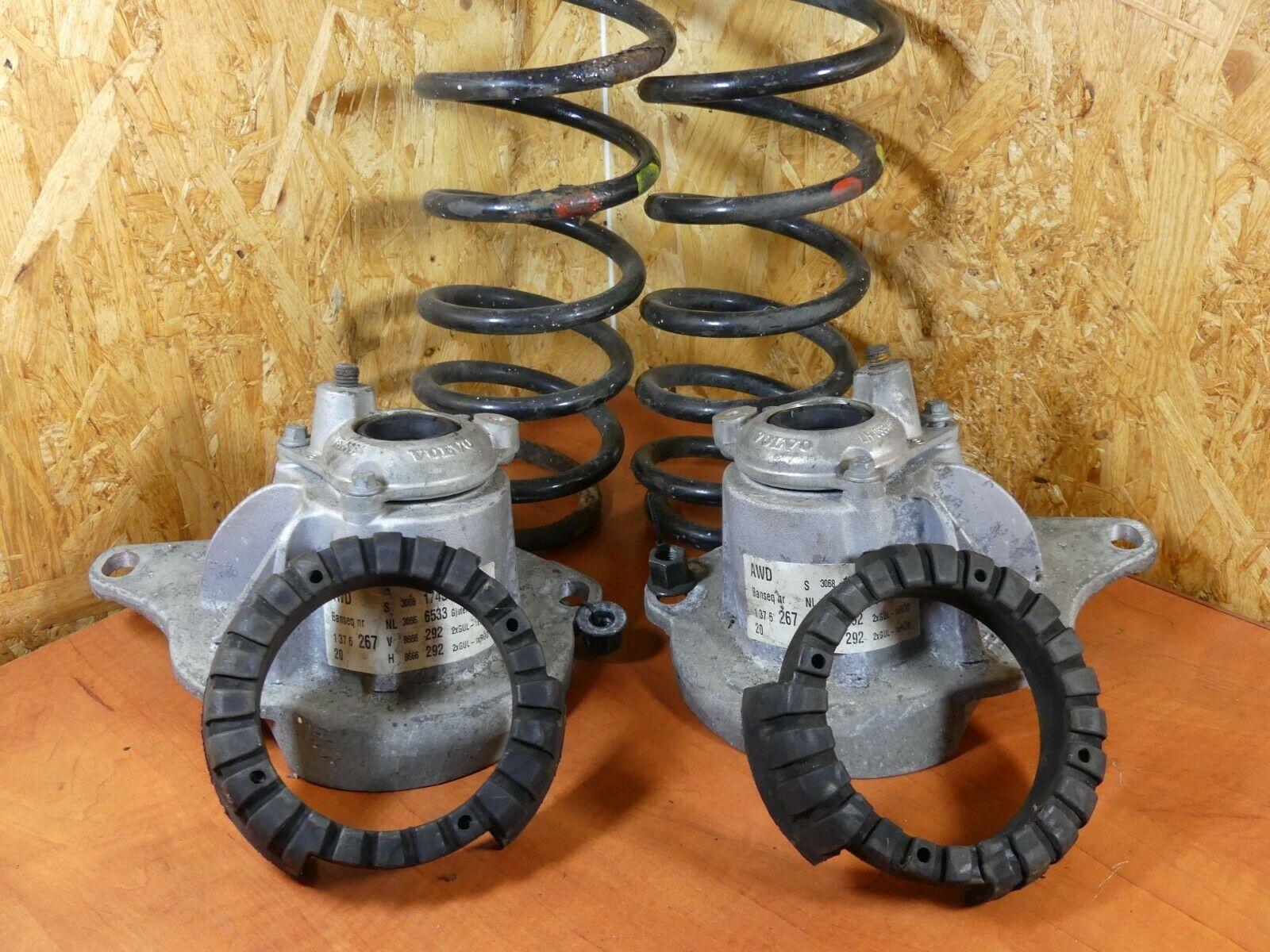

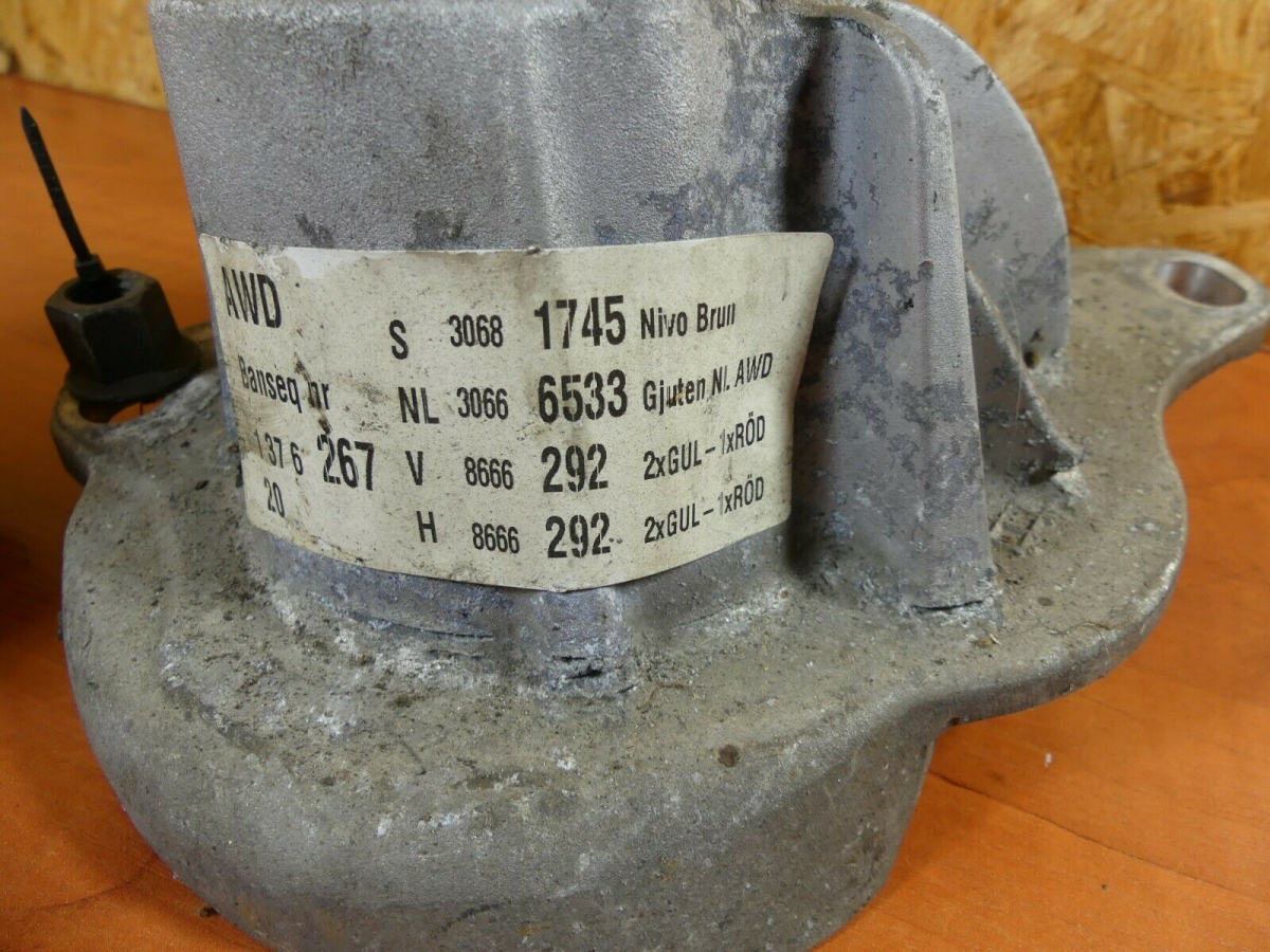

Can anyone confirm this? Is it Nivo? Looks like what we've been discussing.
# OEM VOLVO XC70 AWD 01-07 _ REAR NIVO SHOCK MOUNT SPRING PAD HUB RUBBER.
https://www.ebay.com/itm/OEM-VOLVO-XC70 ... SwBPxchUvJ

Well movolvo... it's not nivomat because according to the photo all you have their is a pair of springs and upper spring mounts..nivomat shock is self - leveling don't see a shock in the picture....hmm
