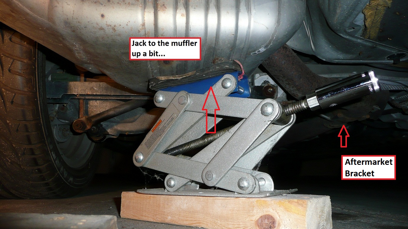

I have a little time to play with the bracket...
UPDATE using Menards hardware store.
But you need an angle-grinder to cut the metal corner a bit.
Items:
1. Metal Corner (Zinc type), 5" x 1".
2. Some Loctite if you wish.
3. Galvanized steel strap, the stuff in the plumbing dept; 3/4" x 10 ft.
4. Stainless Steel nuts and bolts as shown.
Total cost ~ $9.00
1. I cut the Metal Corner a bit. After the cut, the end product is one hole on one side and 2 holes
on the other side.
On the longer side, I bent the metal tip 90 degrees as shown to hook under the muffler edge:
this was done using adjustable wrenches.
2. The bolt is 3/4", a tad too long for the small hole (this small hole is part of the mounting bracket,
look upward and you will see it). So I added another nut as shown.
To counter-hold the nut, use 1/2" wrench.
3. I added the strap around it just to hold it in place. You don't have to do this step bc the bracket
is solid. The metal strap was added just in case the aftermarket bracket (installed on the pipe part
upstream of the muffler) fails...
4. The entire system is now supported by the:
- Aftermarket bracket (installed on the pipe part upstream of the muffler, tons of youtube videos on it).
- This new bracket that I made.
- Now the weight is evenly distributed to avoid stress on the system.
PS: I will have to go to muffler shop to have them weld a sleeve in, just to be kosher.
The muffler is now supported by this bracket.
