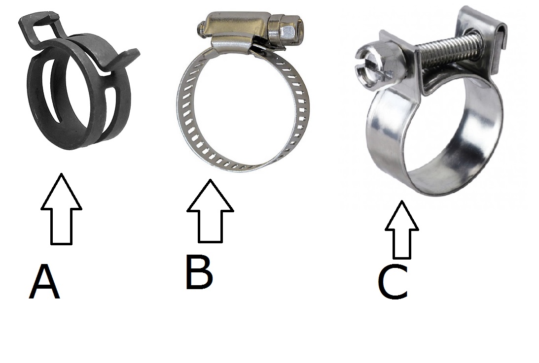

Since we are talking about Clamps
My preference is the Type C clamp shown above.
However for the hose in question that this thread is discussing I just reused the Type B clamp and I reused the hose.
Don't worry about the plastic Ribs, when you buy a new Thermostat you will get new ribs.
In case you are wondering I haven't had a problem with this hose coming off on either of my 6 cylinder Volvo engines.
I suspect that your thermostat failed and that the failed Thermostat caused the over pressure condition that forced the hose off

I'm with xheart . The clamp looks too low on the hose and it promoted the hose to come off . The pics of the 3 types of clamps shown in the pics above , I prefer the spring ( constant tension ) type clamp for coolant hoses . I would install a new hose / clamp and use the clamp with a small amount of hose exposed at the end .

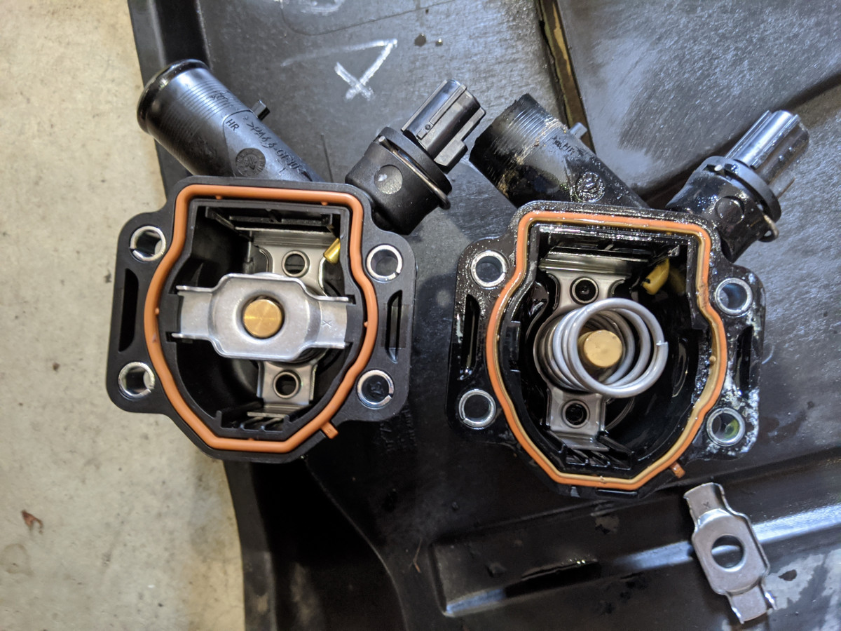

As you can see by this picture, the Tstat unit failed hard. The metal spring retainer is only held in place by about 1/16" of plastic on either side. The far right side has totally given way. Also note that the the smaller / top valve is now missing it's retention bulge - it was blown out when the hose disconnected.
Both the hose and the clamp look to be in very good shape, although I am replacing both. The clamp was still in the correct place on the hose (there's a painted indicator to show you where it belongs), but I have no way to tell where it was along the valve itself.

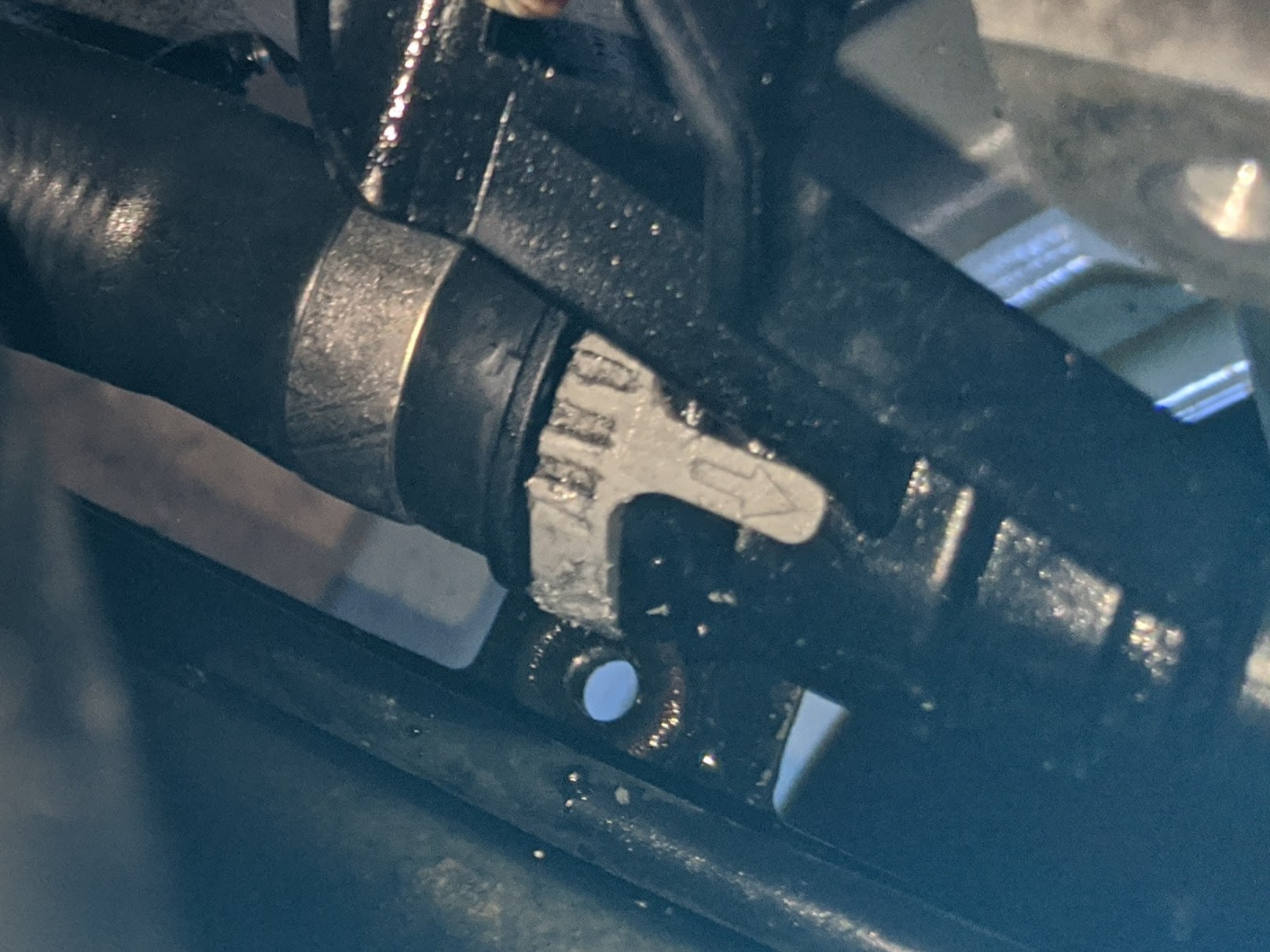

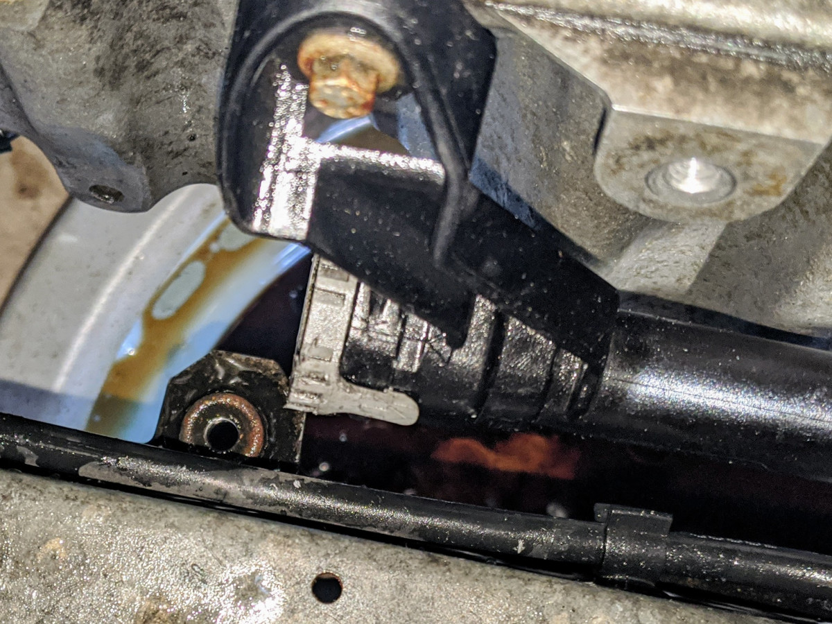

On to the learning. #1 is that the Twist II lock is a total pain in the ass to disconnect. There appears to be a tool you can use, but a helper with a screwdriver above along with me + screwdriver underneath got the job done. The ring doesn't have to be move more than about 3/4", but what a distance that is! When moved, you'll hear a barely audible click. Pic below for locked and unlocked.
Locked
Unlocked

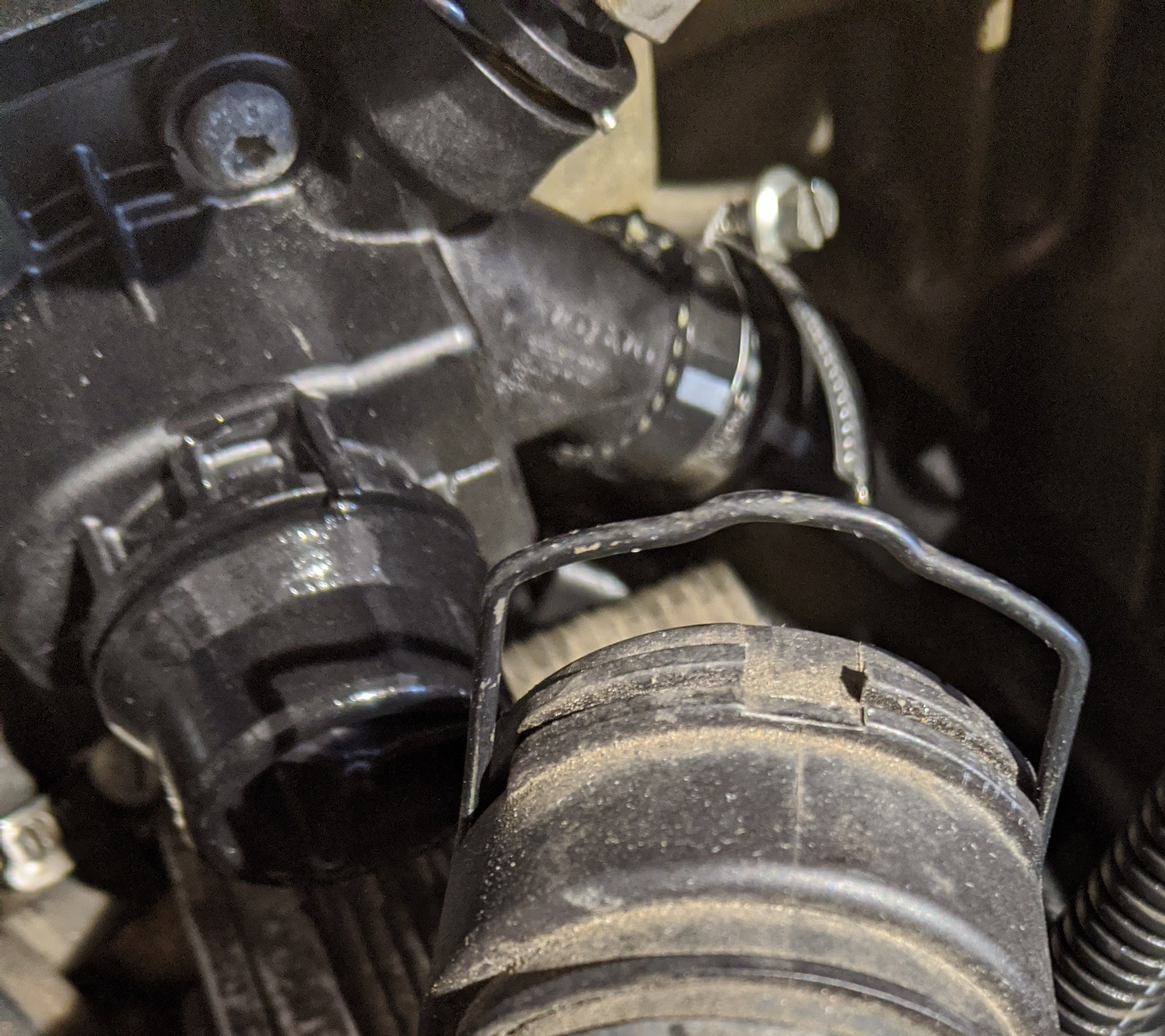

#2 is that the larger hose has a wire lock that is pretty easy to open - just slide a pick under the top of it and pull up. No issues on that one, once you know what to do.

The Thermostat on on 2010 S80 failed in the exact same location.
Note: for my 2008 LR2 (with the same Volvo 3.2) I replaced the Thermostat before it failed....but it did fail about 5 minutes after removal.
