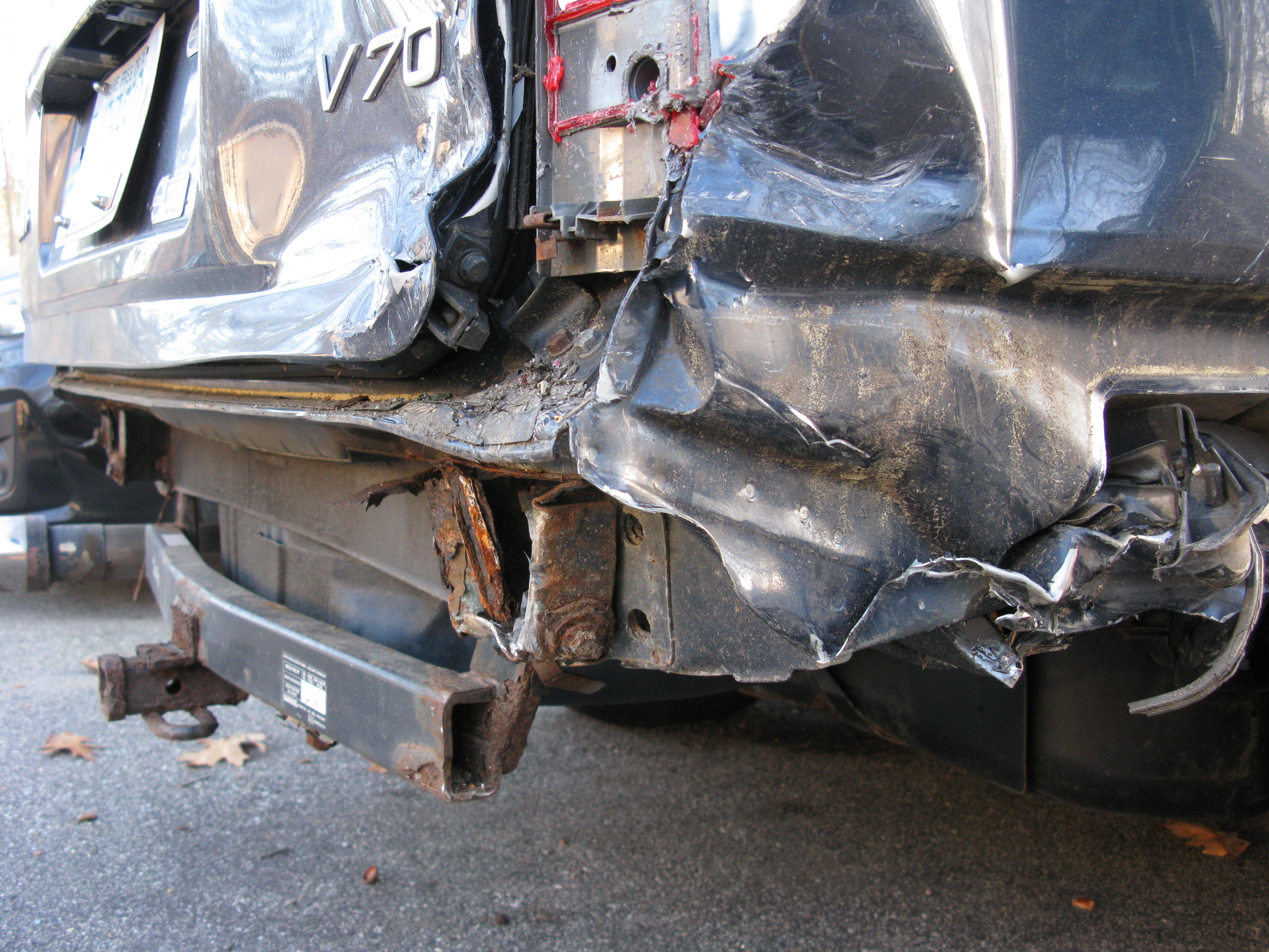

The one thing I don’t like is the right side of the hitch is bent. Hopefully that just slid on the frame member and didn’t deflect it. If NH will let you drive with new bumper, tailgate , lights she will live again

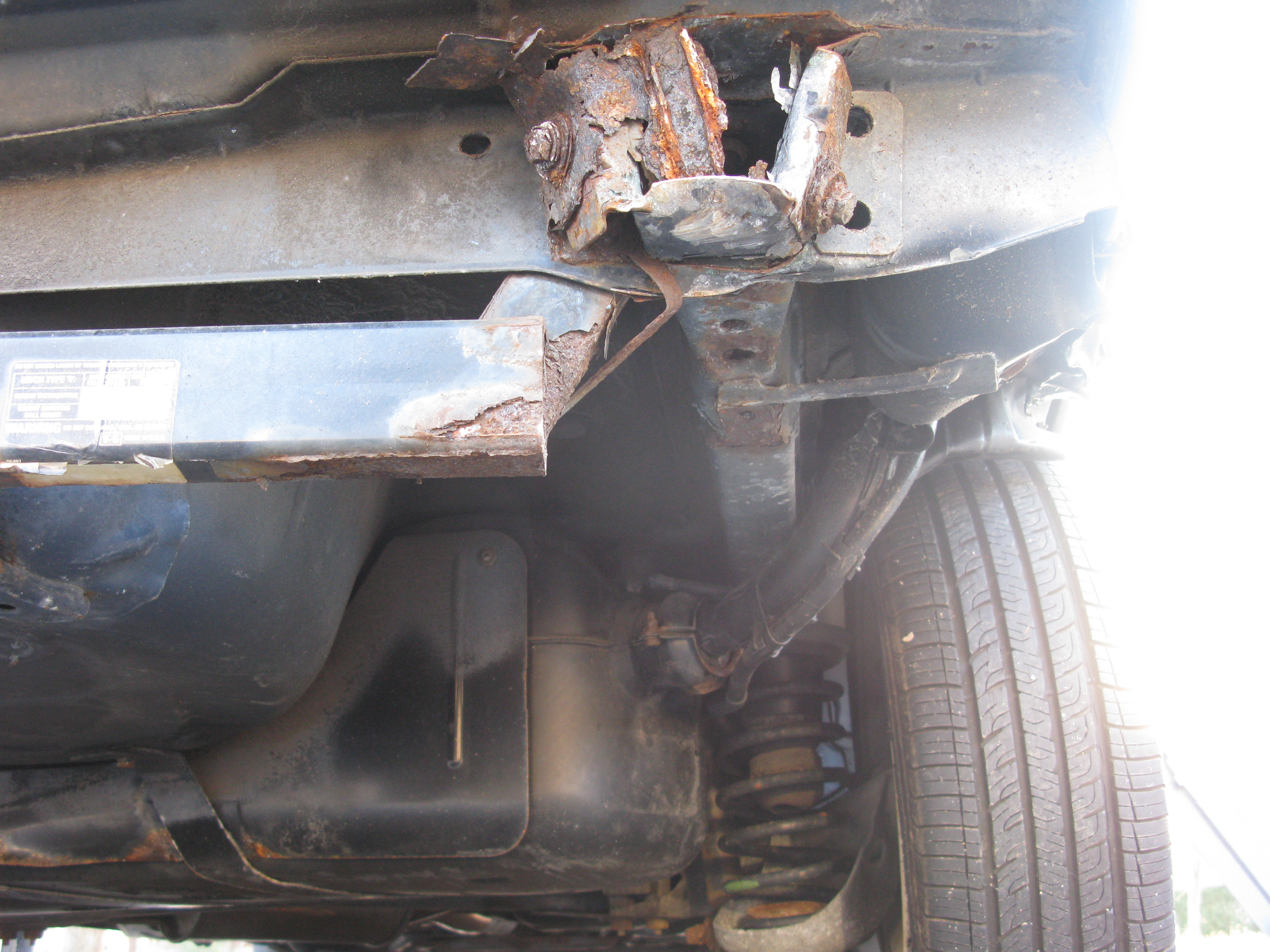

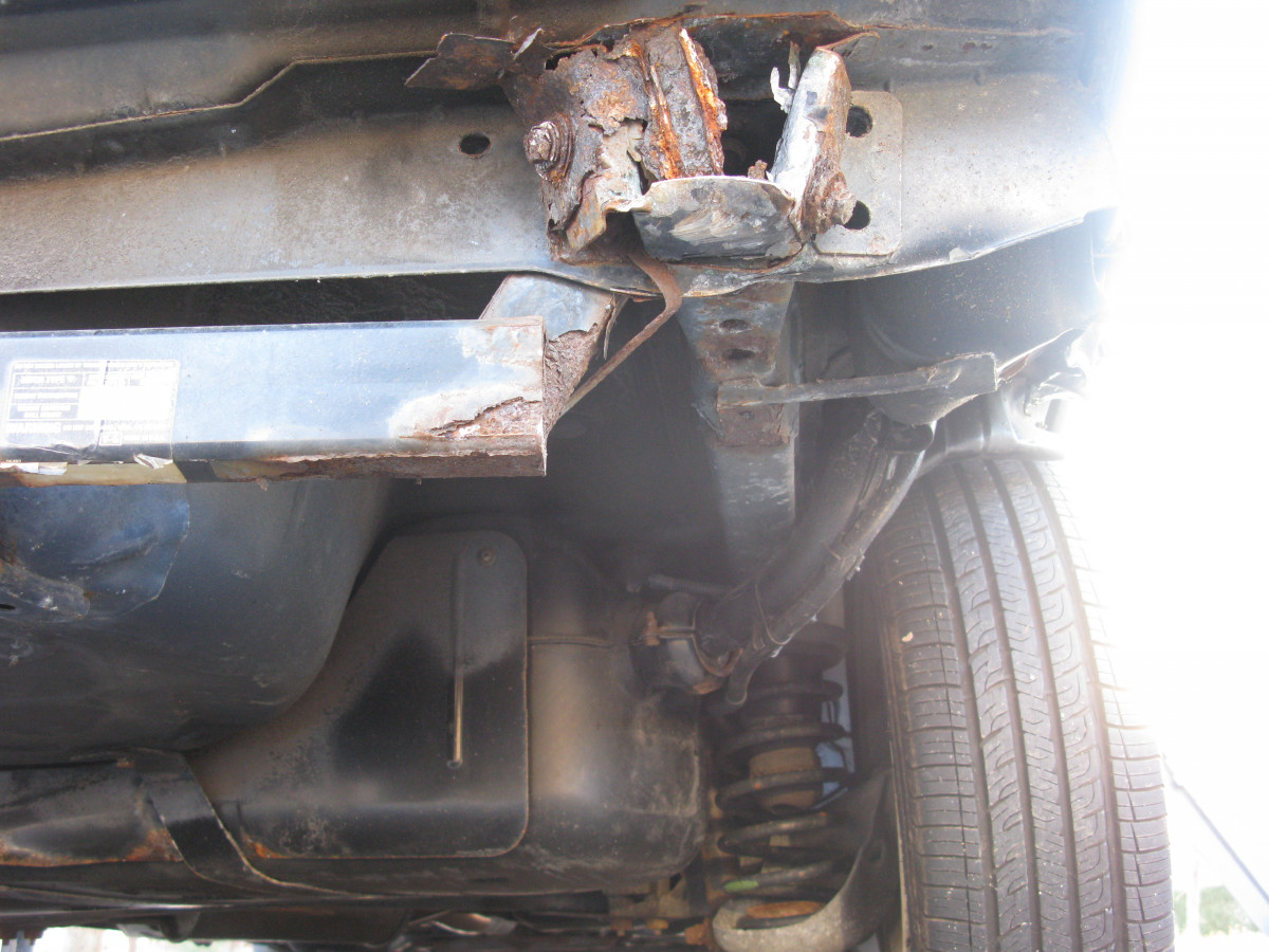

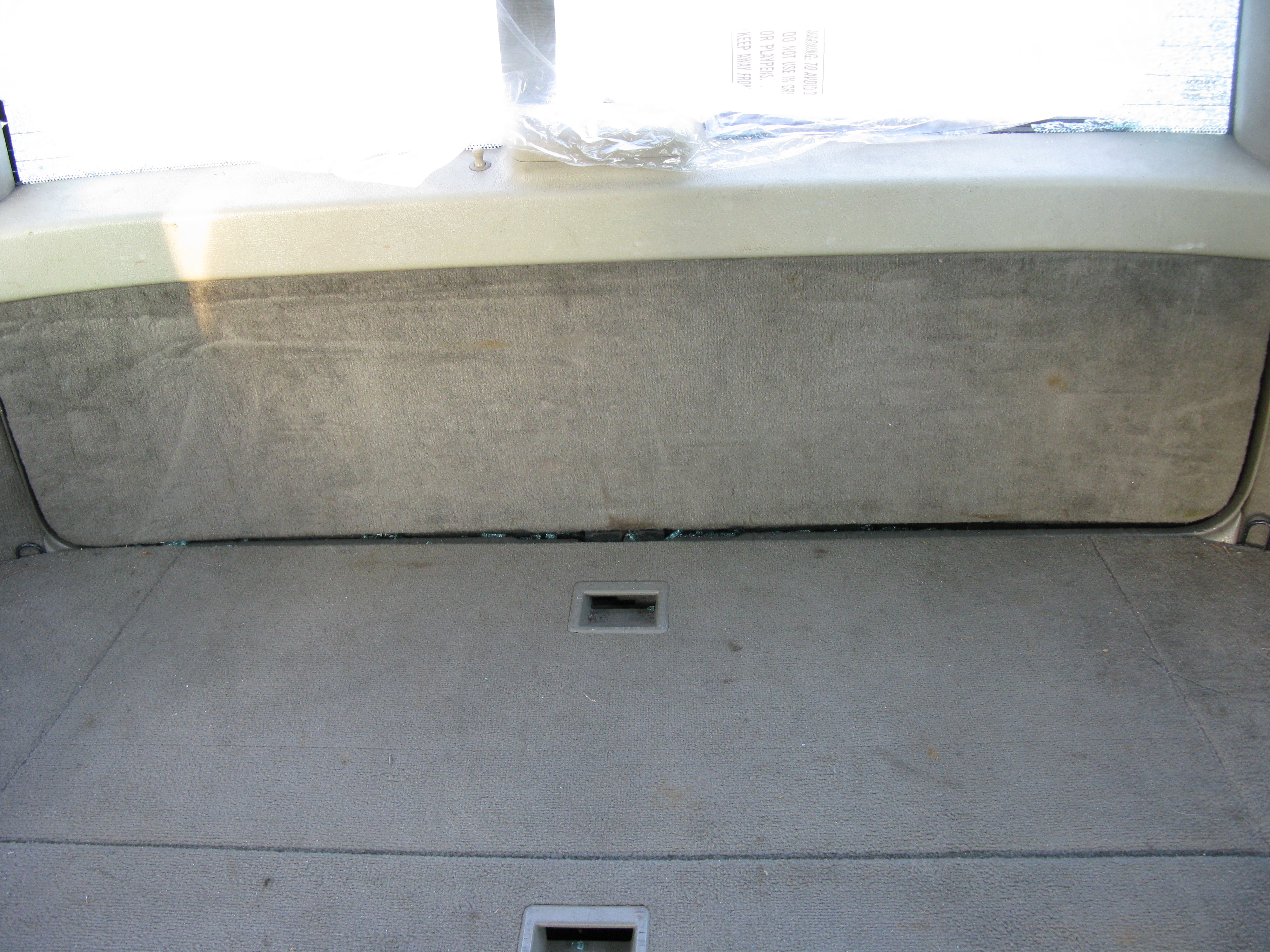

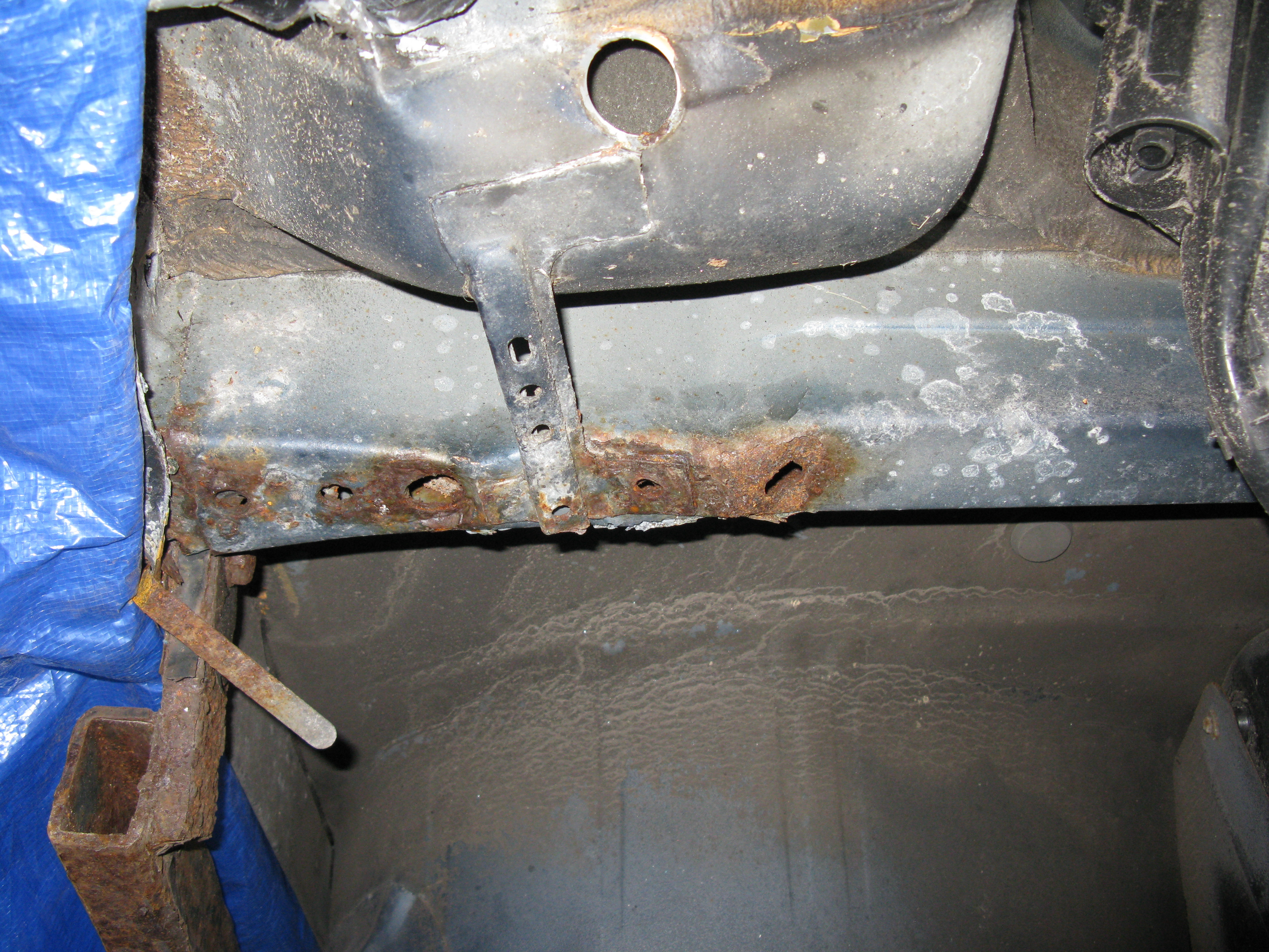

Here are some pictures after I got it home and cleaned everything up. The right bumper bracket looks like the only frame component that's damaged. I'm hoping something could be fabricated and welded into place. The tailgate doesn't seem like it was pushed in to the body and the hitch bar seems entirely unaffected. However, from the inside, the cloth trim pieces on both sides of the door appear to have moved. That suggests that something large shifted. But the spare tire well looks perfect and inside the wheel well looks unaffected.

Been there, done that.FireFox31 wrote: 24 Nov 2019, 18:49Public service announcement: I recommend people in rust-prone states check their bumper brackets and replace them if they are rusty.

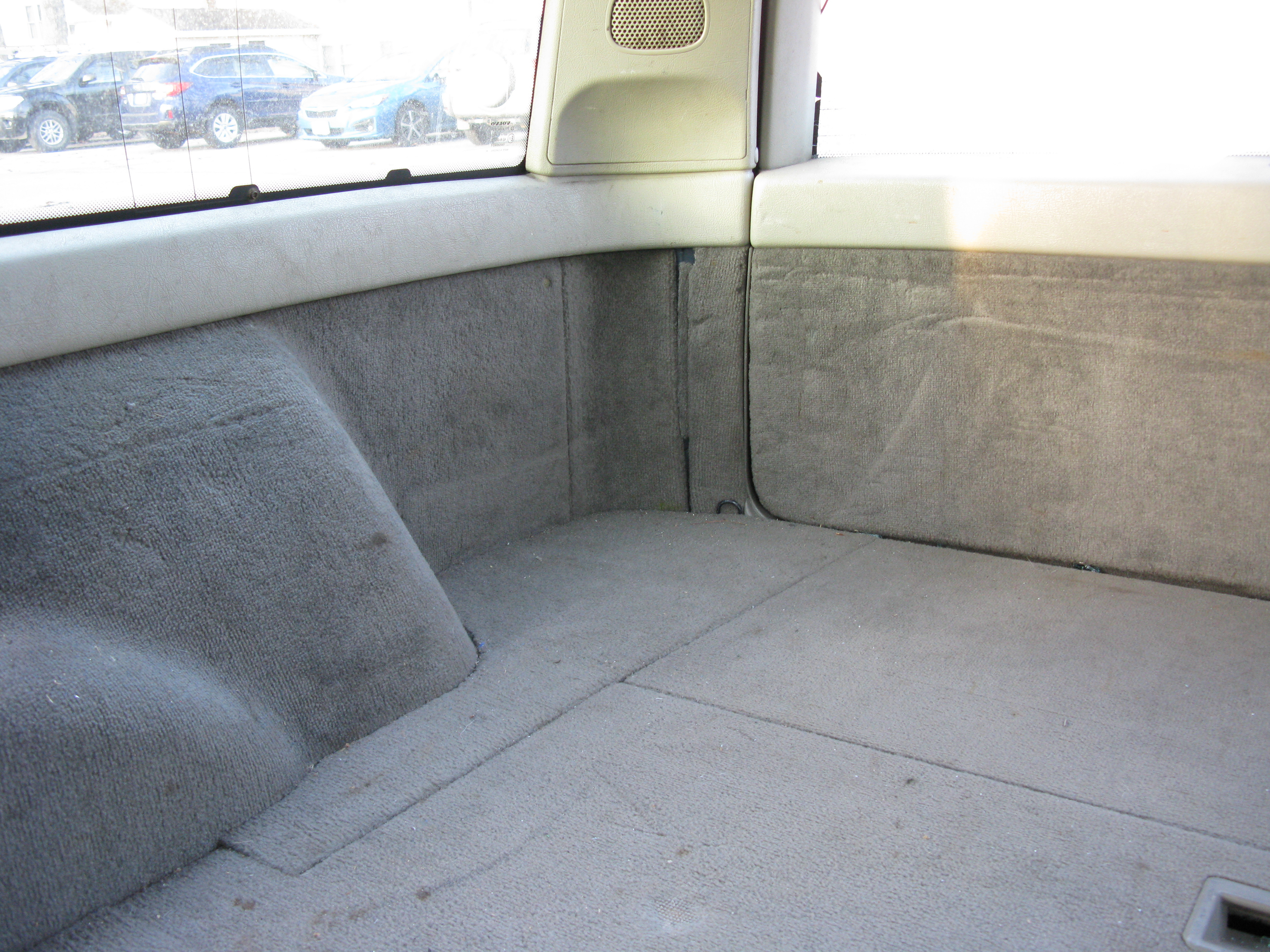

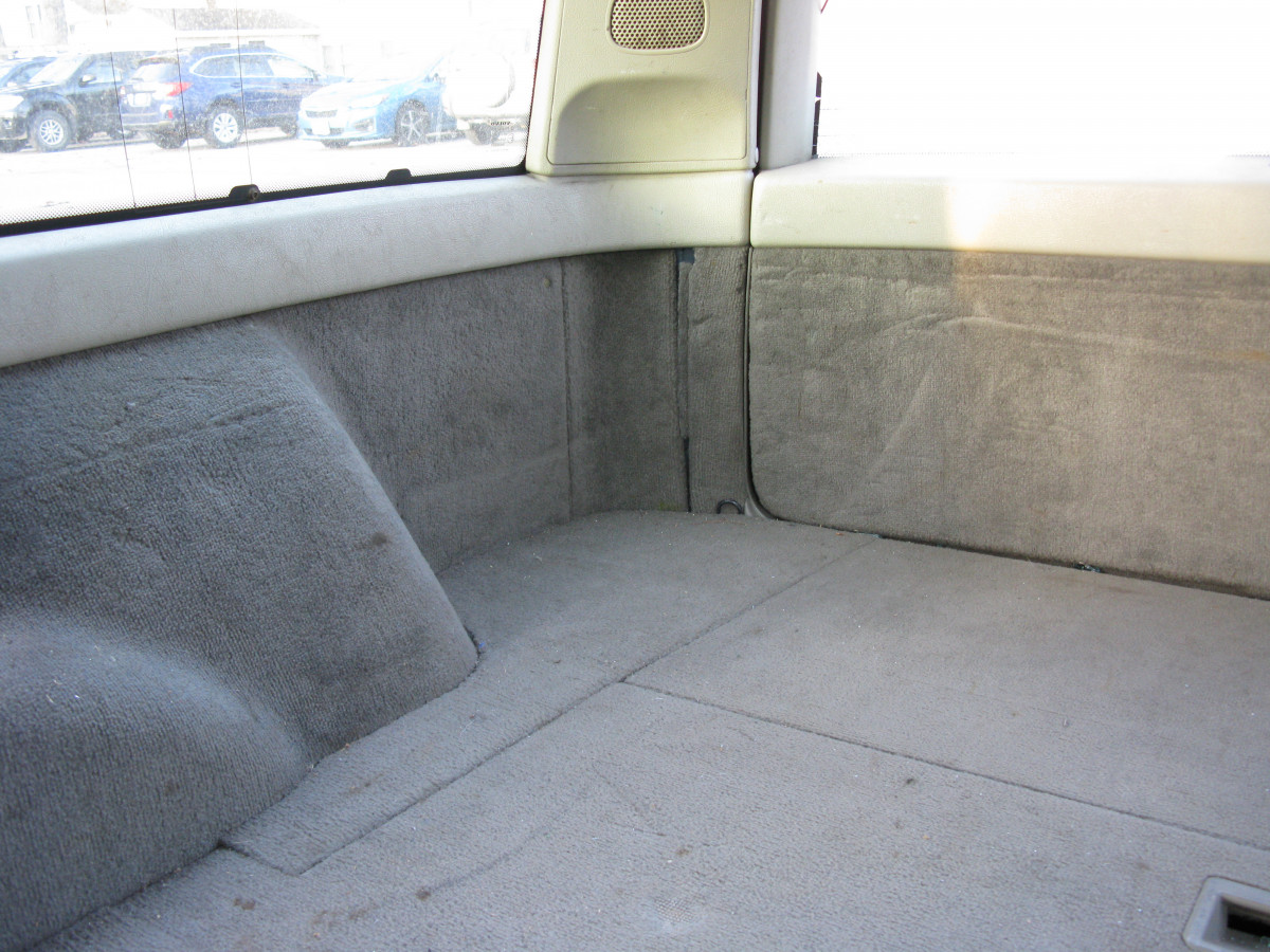

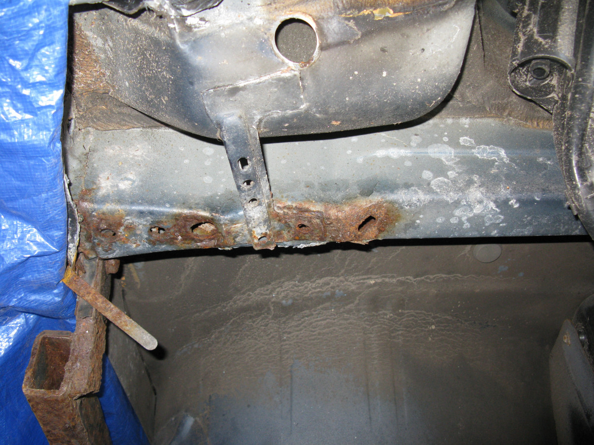

Other 2000 V70 owners, could you please post the following two pictures of your wagons so I can compare to mine? I'd like to see the inside bottom of the trunk door where it meets the floor, and the right rear frame rail behind the wheel. My frame rail may be more crumpled than it should be, and the gap at the base of the trunk door looks wrong.
