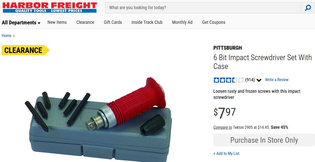

Try using one of these manual impact tools. They are cheap and work very well.
vololugnut

@Volvolugnut : Yes, that's the tool i'ma actually try to find in one of my toolboxes ! :) Thanks to all !
