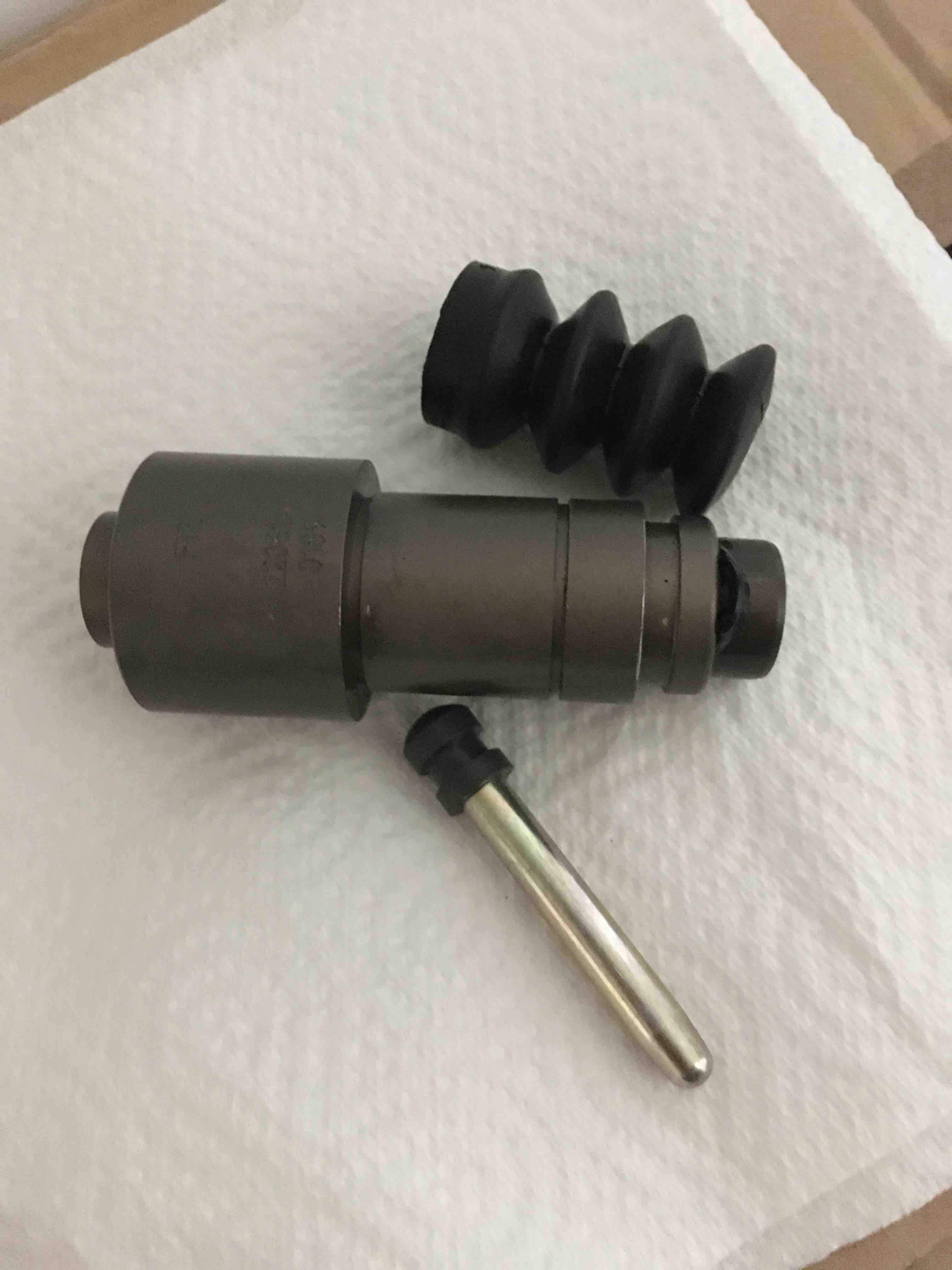

Could you post a photo of the slave cylinder when you get it removed?

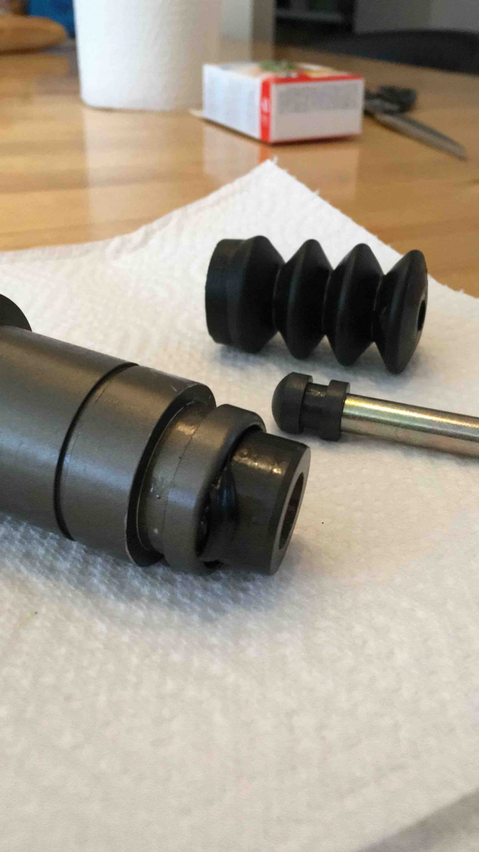

So, here is the part sended by Skandix.
I've used the way shown in the video just above to bleed the system.I don't understand how a small pressure of oil can has been able to push out the seal so far. The first bleed was fine, not enough, but fine...

I think you may have gotten a bad unit, which is why the seal was pushed out.
The only thing the reservoir does is keep the clutch master cylinder supplied with fluid. Mine only has a single nipple on the reservoir to feed the clutch system. It points straight down. Again, as long as the reservoir is full, either should work.
There is more pressure in that system than you think. However, it's possible that the piston was pushed in too far and was able to snag the edge of that seal and help force it out of its seat in the bore.
