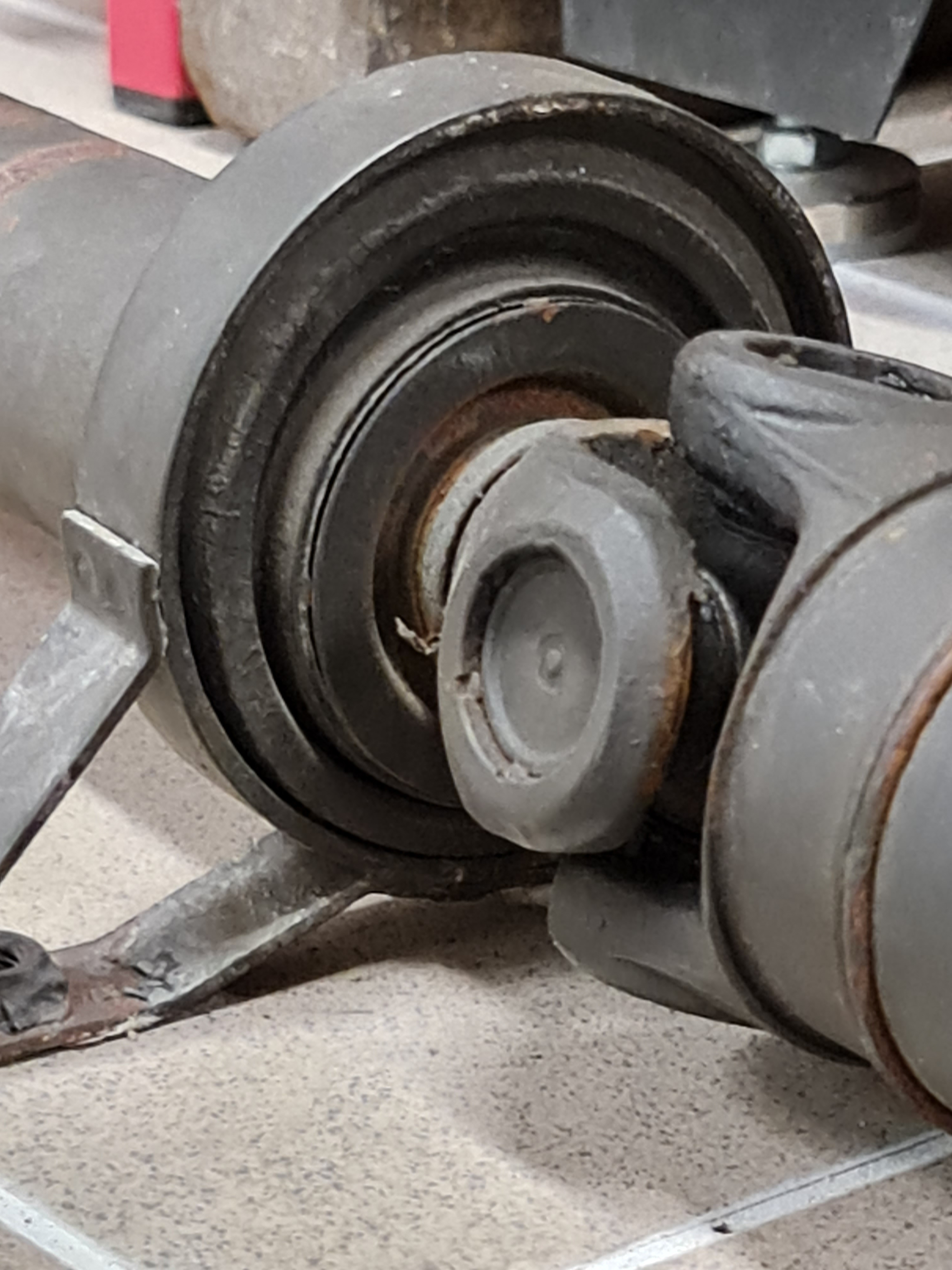

Propshaft is out and now the "fun" begins.
The bad bearing sound is completely gone, can't be heard with the car in the air or driving hard on the road (all with the Haldex fuse in its place.
Feeling the output flange in the bevel gear there is no radial och axial play, like som bad cases on Youtube.
1. Bevelgear bearings are starting to fail
2. Supportbearing on propshaft
3. Haldex/back diff
What would be a good way to pinpoint the source?
Picture of the saggy support bearing......could this be it ??
3. Haldex/back diff

So this is the problem with the bearingsound ?
Just to test it could I install 10mm shims to conter the saggy bushing ? Just to make the bearing sitt in its orginal position ?
