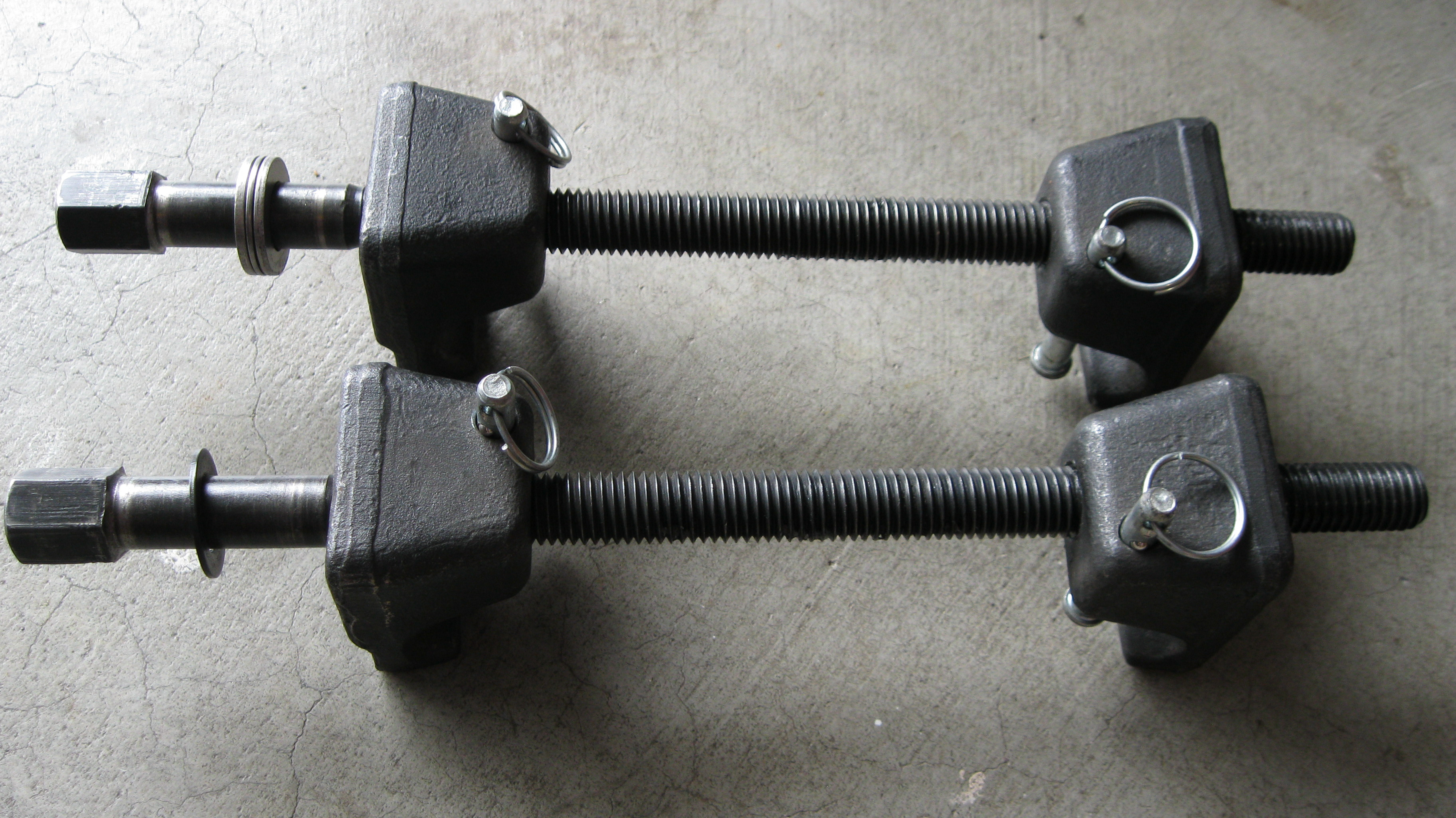

I usually reserve that type of spring compressor for non-strut springs-only I have to remove where the body gets in the way on one side. I have seen that type of spring compressor slip and pop out. Spring compressors can break, slip, etc., though my preferences add work & time, it also adds safety.
I personally like redundancies when working at home because the home-use type of tools are not at the same capacity as professional tools, thus why I like to use 3-4 threaded rod type like these which have safety pins: https://www.amazon.com/ABN-11-5-Strut-S ... 637&sr=8-7 You can buy one, and then [free] rent a set from a local auto parts store. Remember to lube the threads before tightening the spring compressor so it doesn't bind.
If you are not sure about doing the work, do the job with a neighbor/friend who has done it before. Or take the strut assemblies to a local shop and pay them to replace the struts and mounts. Also, never let the spring face you. Keep the assembly on the floor facing away from you.

I've seen this version of compressor but never tried it.
I took a pair of inexpensive compressors and added a couple washers plus a thrust bearing (top item in photo) then I lube the threads before use:

I've done spring replacements on older GM cars a bunch (the jack method), but never attempted a strut. I'm confident in my ability and am very wary of spring power, indeed!
I like the design of those compressors you shared (especially the locking pins. Is the idea with these to have them on either side of the spring once the strut is removed from the car. Then alternate tightening the sides little by little until the top nut and spring seat nut can be removed?
ggleavitt, does that thrust bearing just help take the friction stress off the head of the compressor screw?

^ yes.
As you'll soon see, it'll take quite a bit to compress down to where the seat has no tension. I went from a 5 cylinder to two V8s, have done more than a few 33 springs with these. You can use them no problem with just the washer they come with (lower part in photo), I chose to go the thrust bearing route because I saw the washer was getting deformed and another option came to mind.
