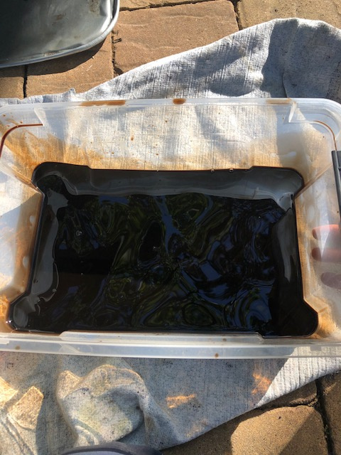

Did the drain and fill procedure x 3 this evening. I only got about 3.2q per drain, so that is what I put back each time. The fluid was black and not-to-fresh smelling, but was not burnt. I got pretty close to nice red after the 3rd drain. Immediate improvement in manual shifts between P, N and D and R (smoother) and MUCH smoother shifting between gears under driving conditions. Feel much better about the tranny. Thanks!!
