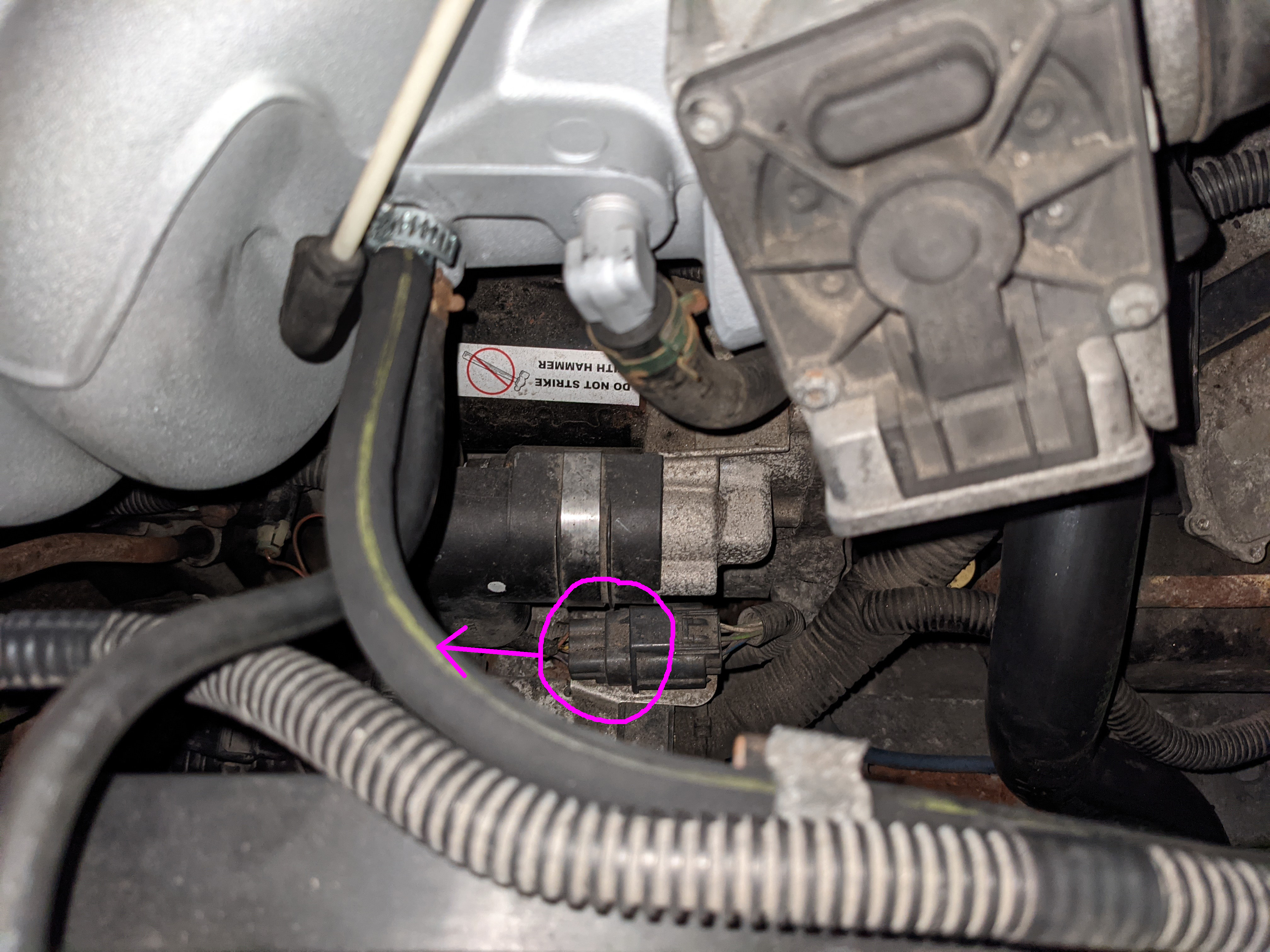

The used throttle body worked! As instructed, I connected it electrically without mounting it. It clicked and hummed as expected. After 18 years with this ETM, I finally know what it's doing when it powers up.
The throttle body wiring harness was rather easy to disconnect. It's in front of the starter, easily accessible from above by two carefully placed hands. It is affixed to the metal plate, but can be disconnected where it sits by pressing the tab on the right half and pulling the left half to the left.

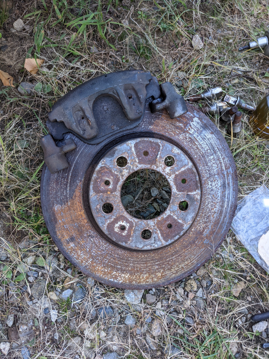

The next challenge is breaks. Any advice for how to free the pads rusted to the rotor? That's penetrating oil on the rotor, having tried desperately to free it.

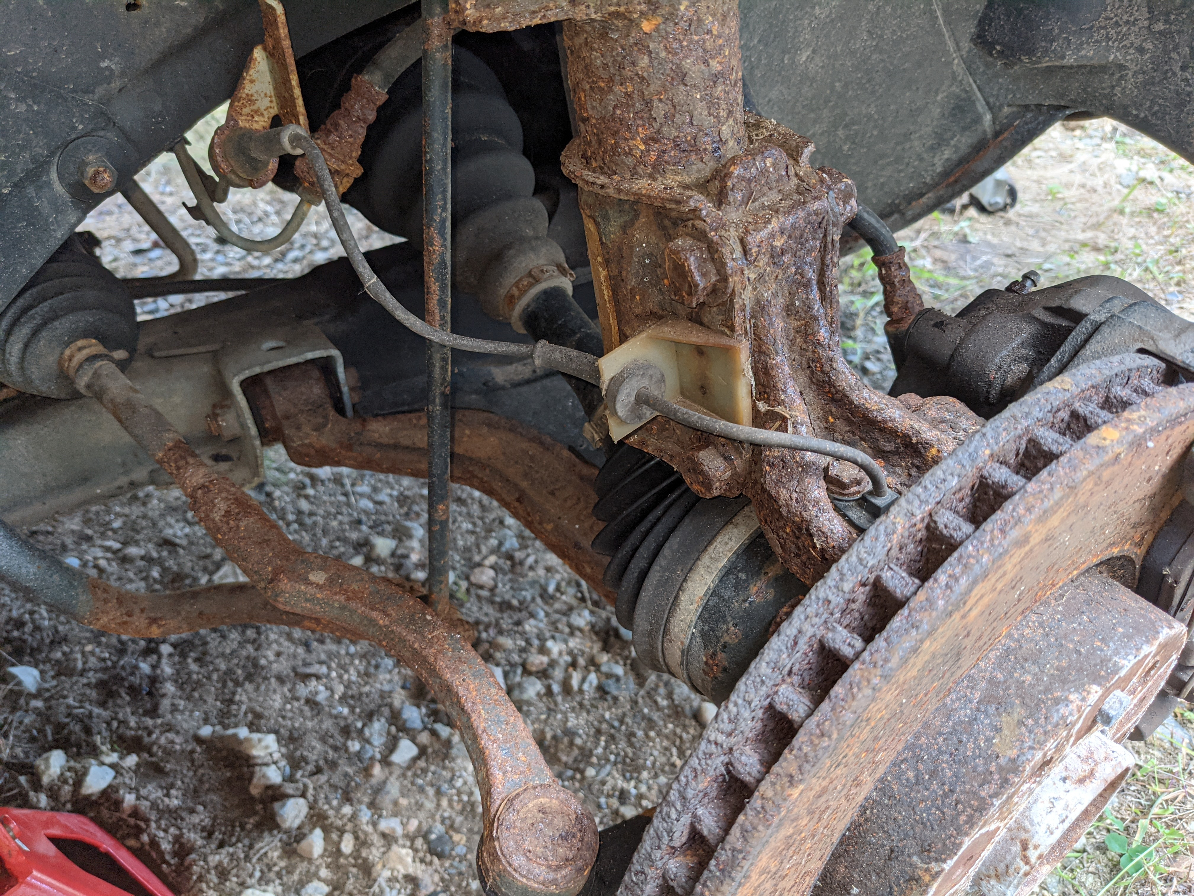

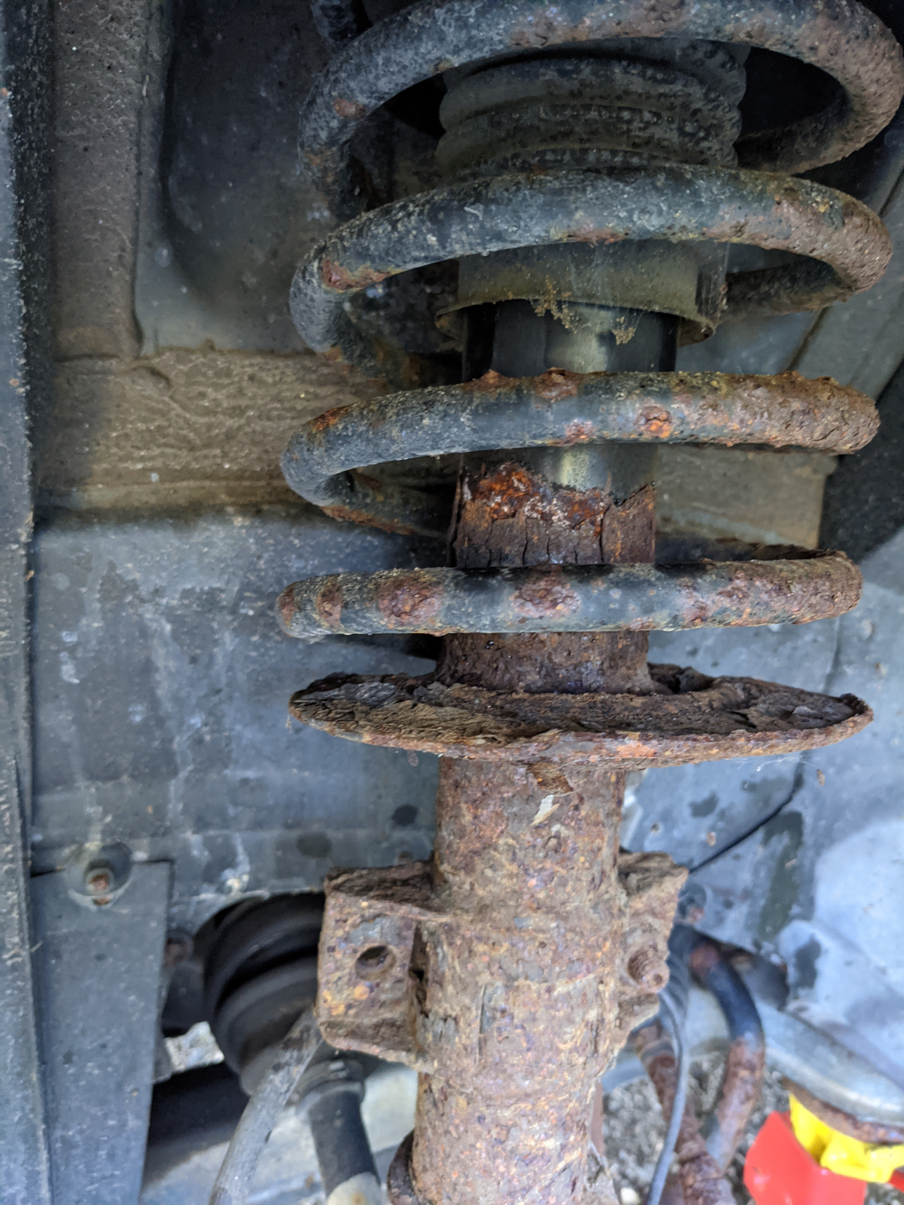

The front suspension is more rusty than any I've seen. Is it more than just surface rust? How much of this should I reasonably replace?

That suspension is gnarly but if the struts and springs are doing their job that can wait for the last step when you know there are no deal breakers. I think rack and transmission are your last two big things.
