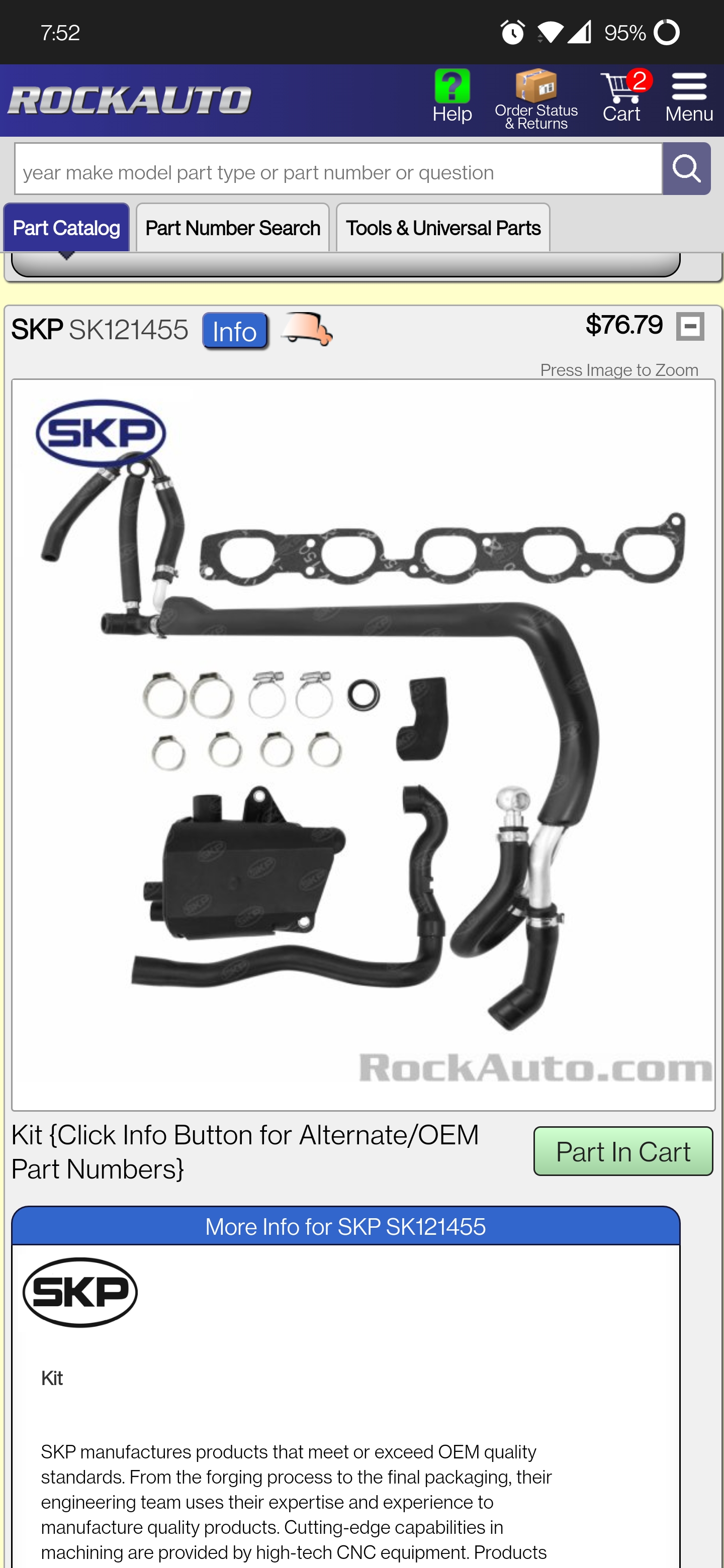

Correct there is no PCV valve. The "PCV system" on these cars consists of hoses to recirculate oily fumes, and an oil trap (separator) to catch the oil and drain it back to the sump.
There's a billion threads on here about how to service the PCV system, essentially you need to replace all or most parts in that RockAuto kit, but if you buy a cheap kit from RockAuto the low quality rubber will turn to mush in about 14 months and you will be back to square one. Due to the work involved don't cheap out on the hoses. You can buy Volvo branded ($$$) or another option is read the DIYs here at MVS using generic fuel line or other oil resistant rubber for the longer/expensive hose, then buy Volvo on the short hoses. Don't use generic heater hose it won't last. The oil trap itself you can almost always just clean out, but sometimes it is too full of gunk.
Maybe do a "glove test" and if that points to bad PCV, start by doing a PCV job. It is super common for these cars to have a blocked PCV at this age. Gradually eliminate oil leaks and see where they come from. Maybe the turbo drain return line is leaking. The TD-04L turbos are indeed super hardy, could be the problem but less likely.
