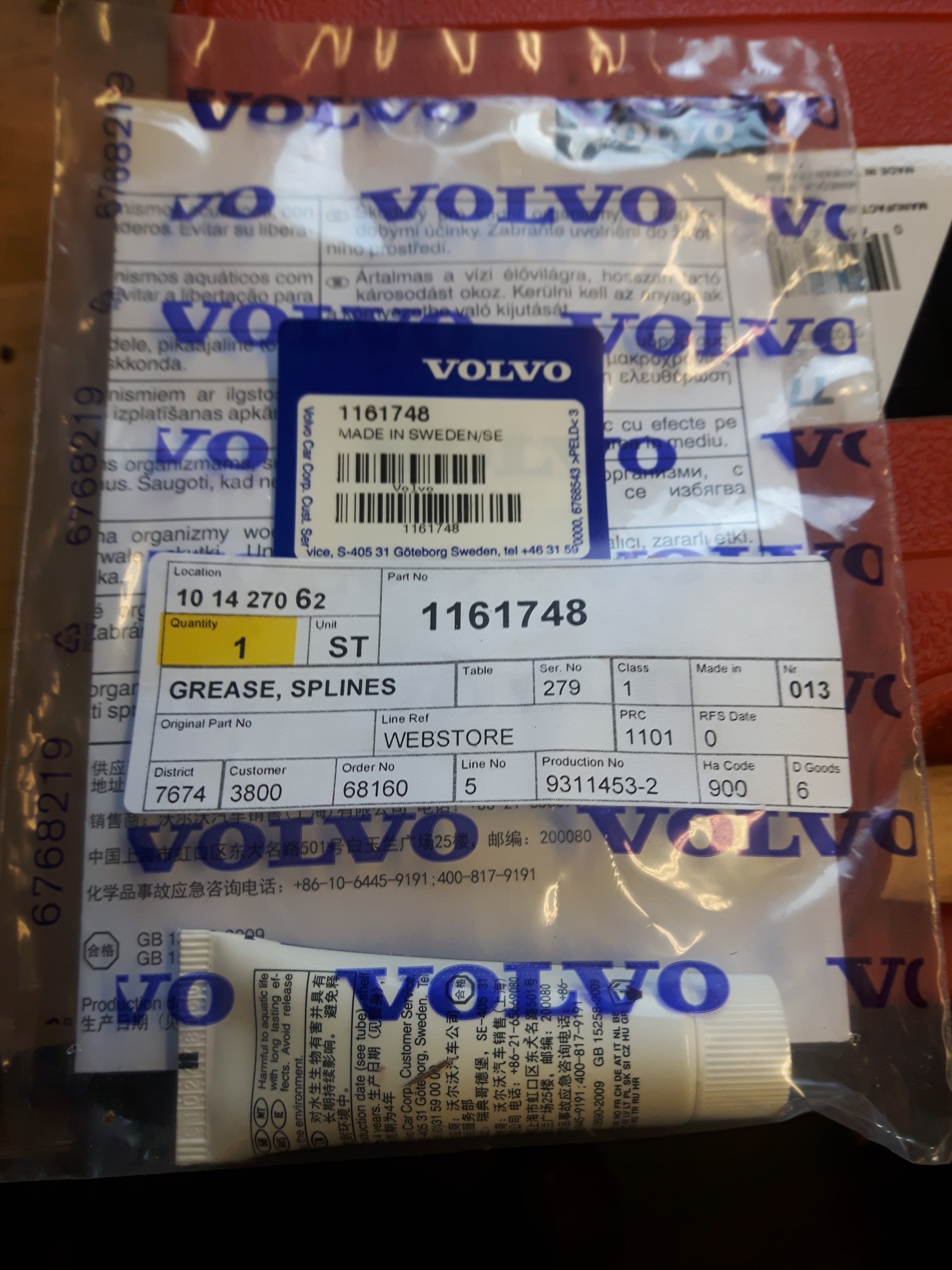

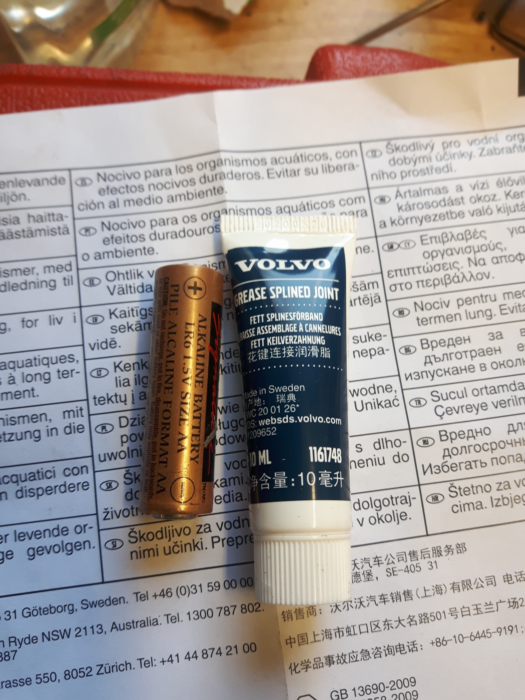

Volvo does sell a spline grease specifically for the collar sleeve on P2 cars, I mentioned this point a few posts up. it is part number 1161748 aka 31437986. Good chance it would also be appropriate for a P80 collar.
https://www.fcpeuro.com/products/volvo- ... se-1161748
