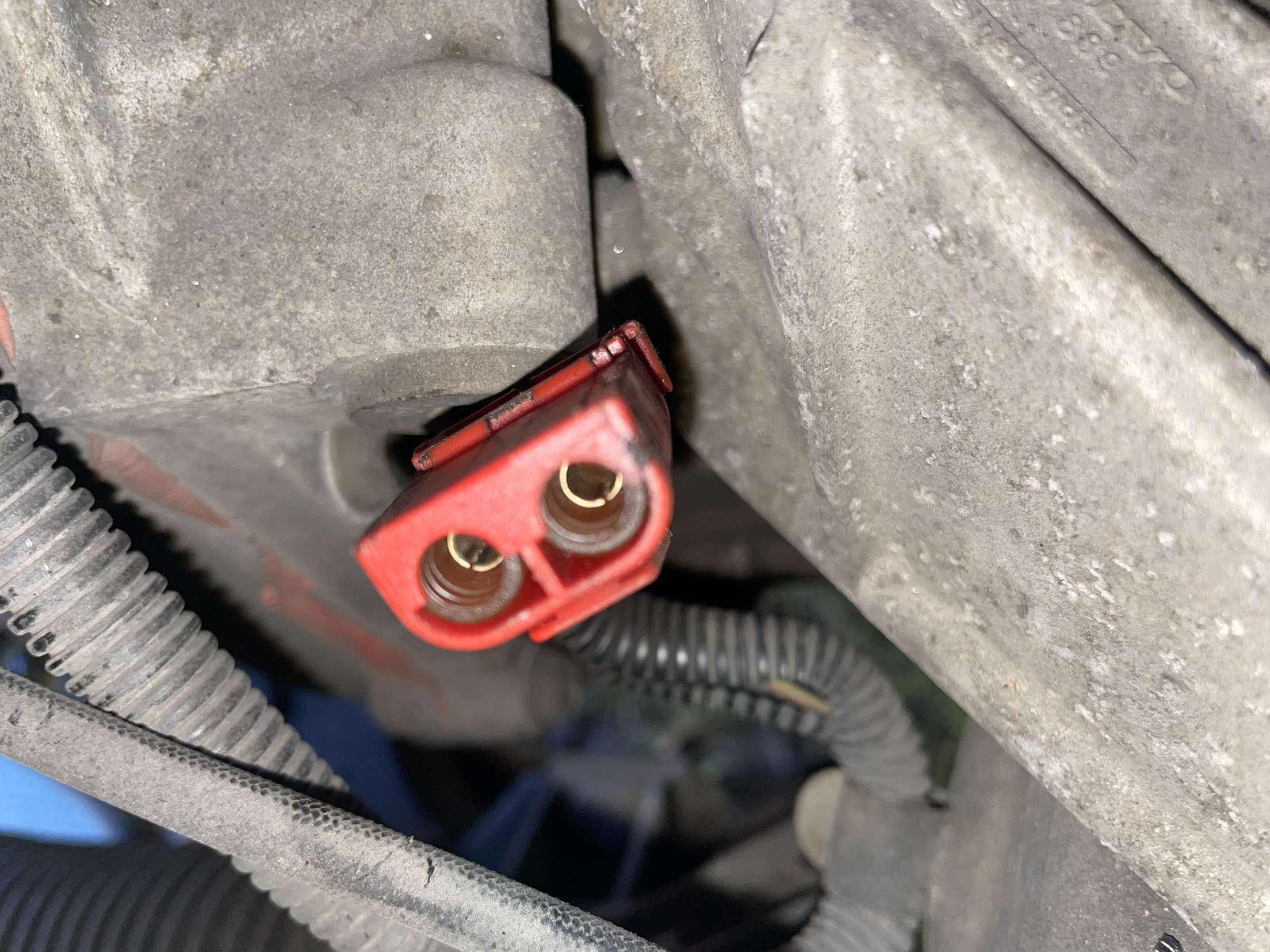

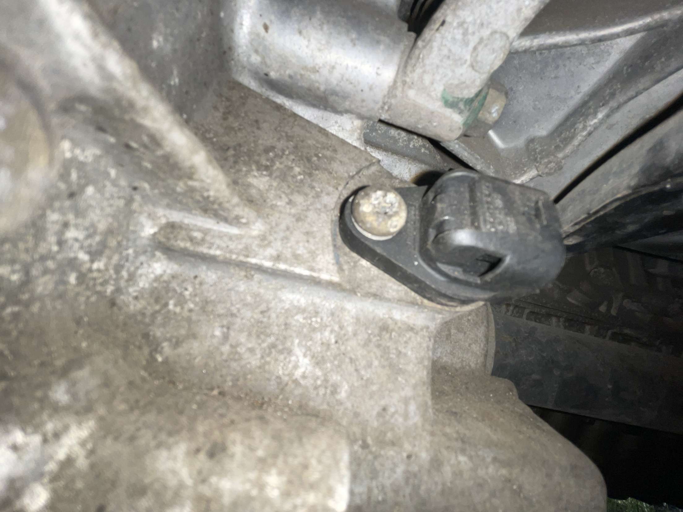

Tried to find the speed sensor. Couldn't remove it. But u took a photo, anyone that knows if this is the sensor? So I know if it's worth the hassle to remove it
- Sensor
- Snapchat-152509580.jpg (216.58 KiB) Viewed 281 times
- Connector
- Snapchat-1419037371.jpg (316.4 KiB) Viewed 281 times
