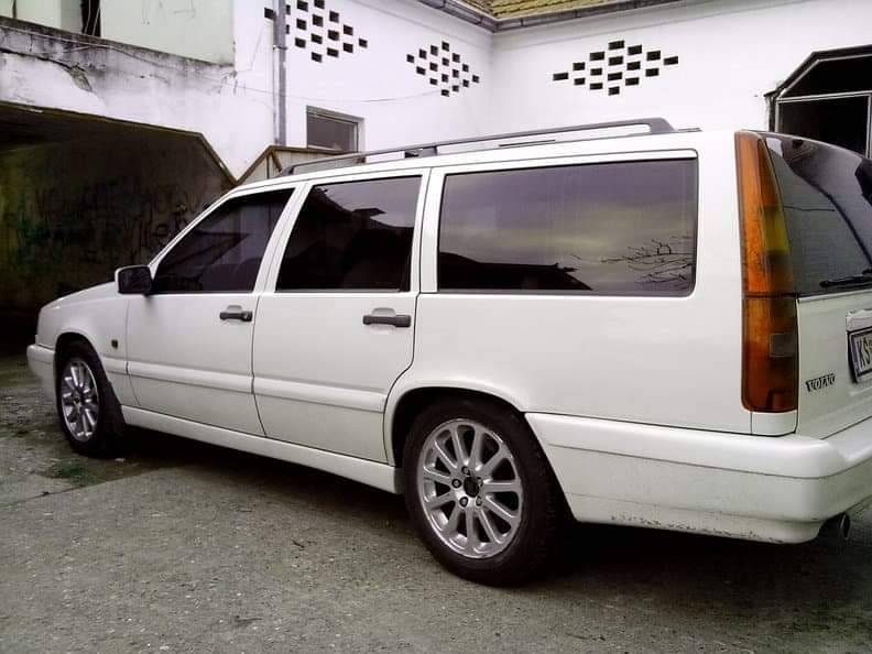

Teaser: accidentally found this on Facebook in one of those shorts.
