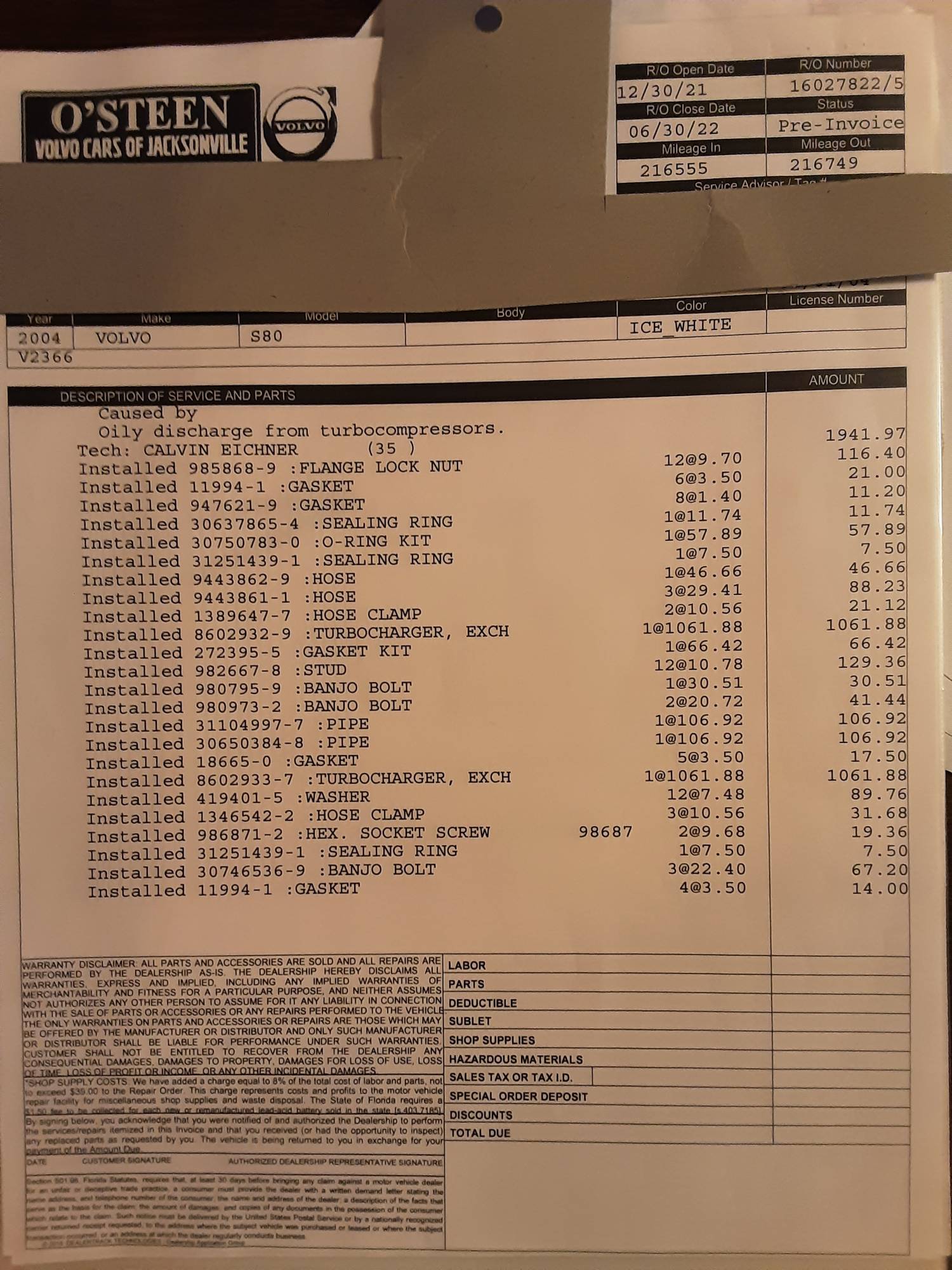

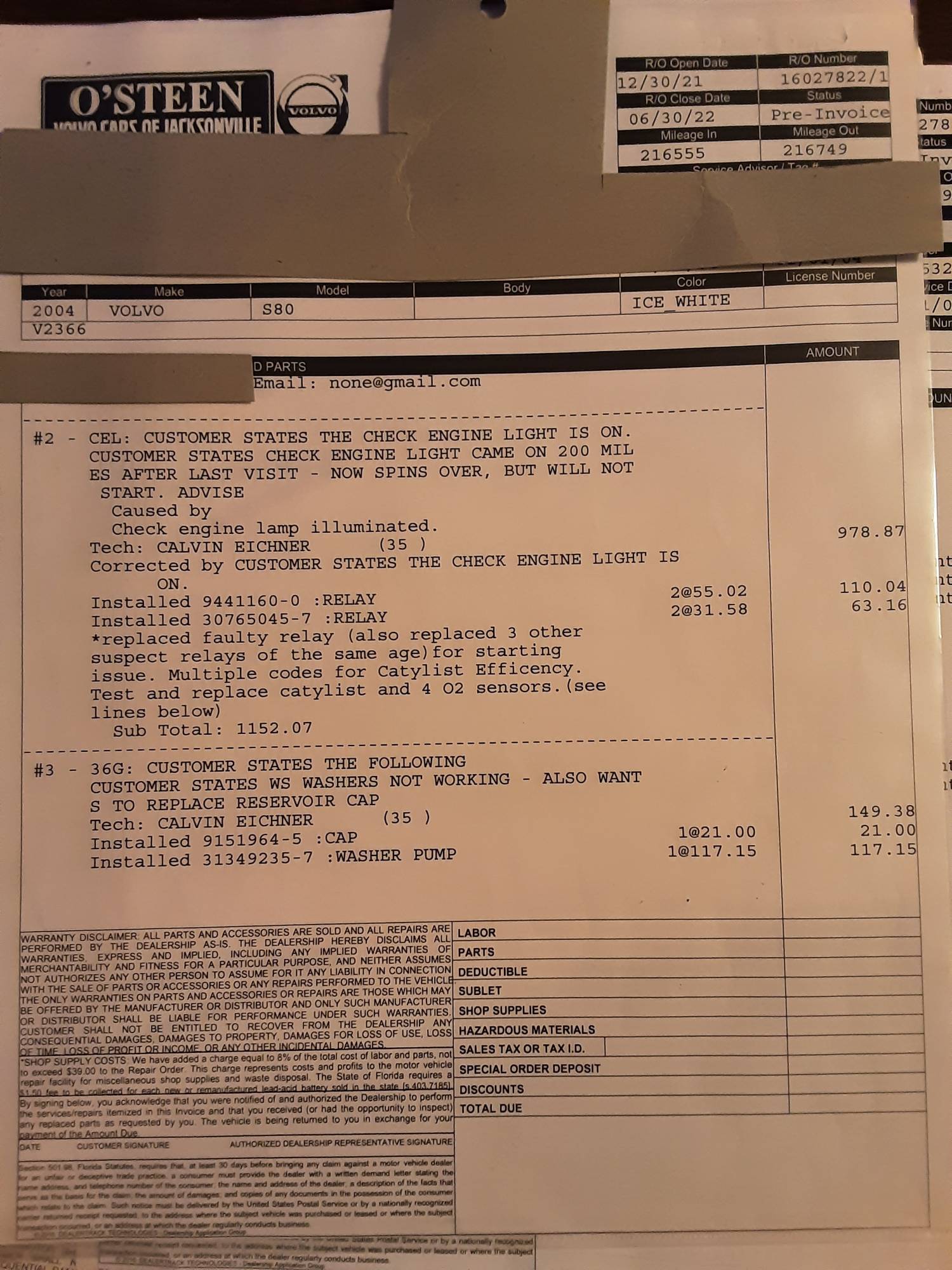

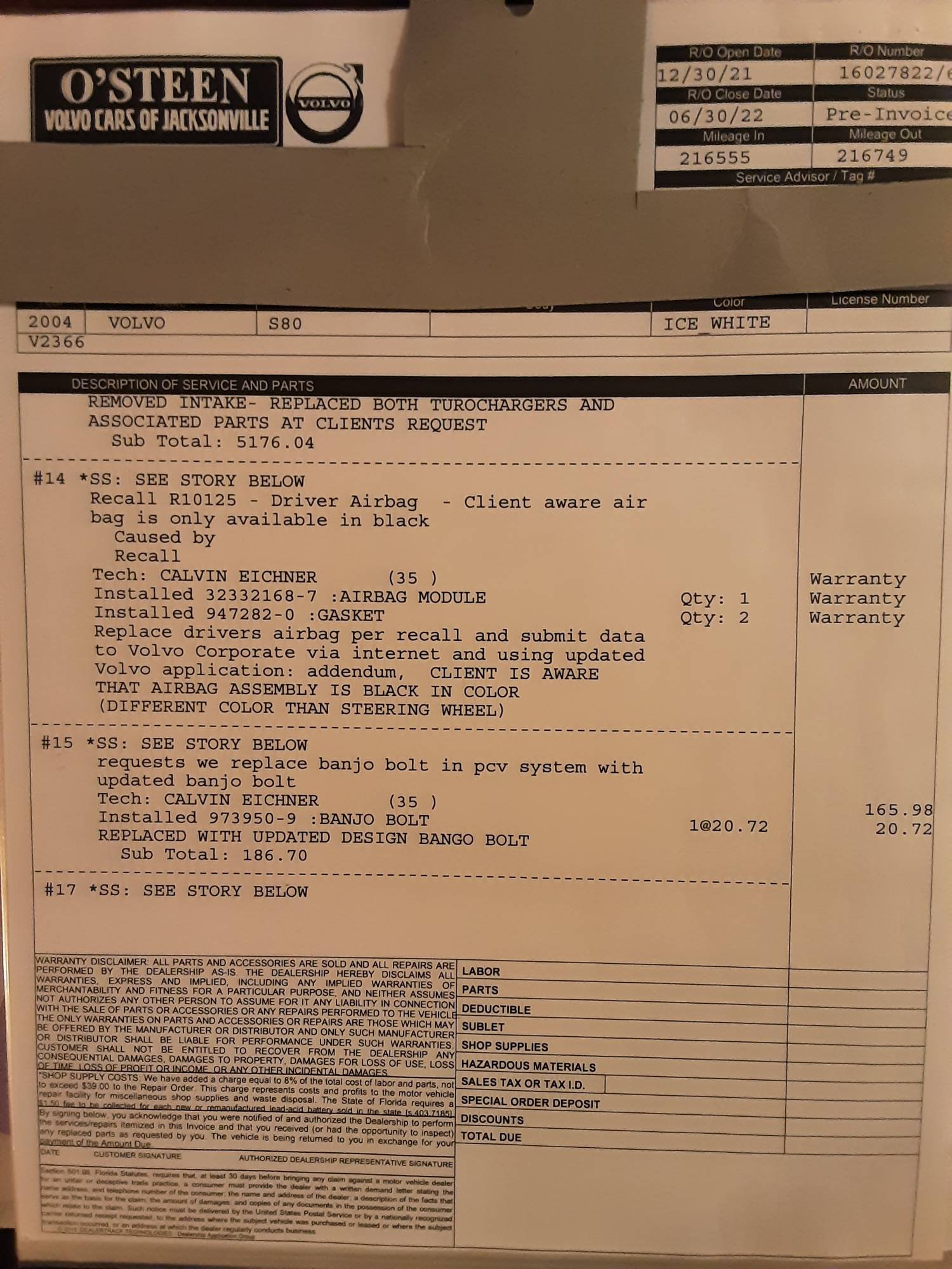

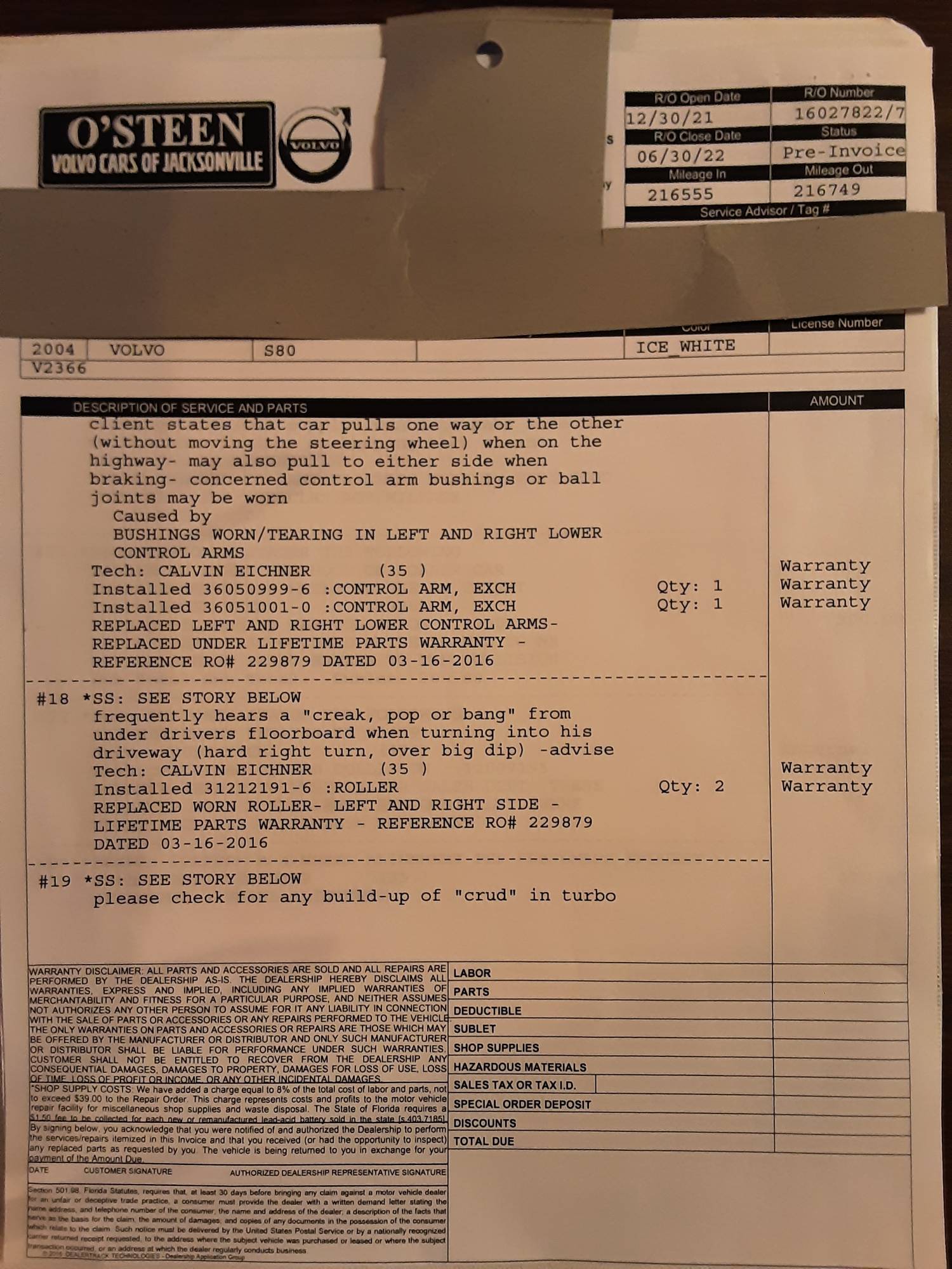

06/30/2022
216,749
$16,850.17
2004 S80 T6 Ice White
