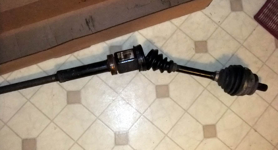

One XC90 back on the road. Started a week ago with my sibling lodging one of several typical complaints I've become accustomed to over the years: "The car started clunking a week or so ago, can you take a look at it? I'm afraid to drive it."
Replaced with a rebuilt OE shaft from Detroit Axle. Loose needle bearings mixed in with the grease and dirt. Outer is still good. I'll pack rat it away in the basement. One does not simply walk into Mordor and throw a good (outer) OE CV joint into the fire.

Classic!!One does not simply walk into Mordor and throw a good (outer) OE CV joint into the fire.
Fear alleviation, $115 per hour + shop supplies."The car started clunking a week or so ago, can you take a look at it? I'm afraid to drive it."

Got a full tank of gas in my car/S60 for doing it. It was nearing empty.
On RH side with AWD I discovered it's far faster/easier to remove the wheel speed sensor and top strut bolt. Loosen, but do not remove the bottom strut bolt. The brake hose is just long enough allowing the hub to pivot out just enough to change that right side axle shaft without the trouble of disconnecting the ball joint or removing the brake caliper. I was having trouble getting the ball joint to release it's grip on the LCA out the cold. So I put my thinking cap on and came up with plan B. I was out there for about 3 hours. Had I approached it that way from the beginning it would have taken about 25 minutes including getting the front end up on stands and taking the wheel off. Neither strut bolt/hole is slotted like it is on my S60. So no concerns with messing up the camber/wheel alignment doing it that way.

How much was the rebuilt axle? No core involved?
