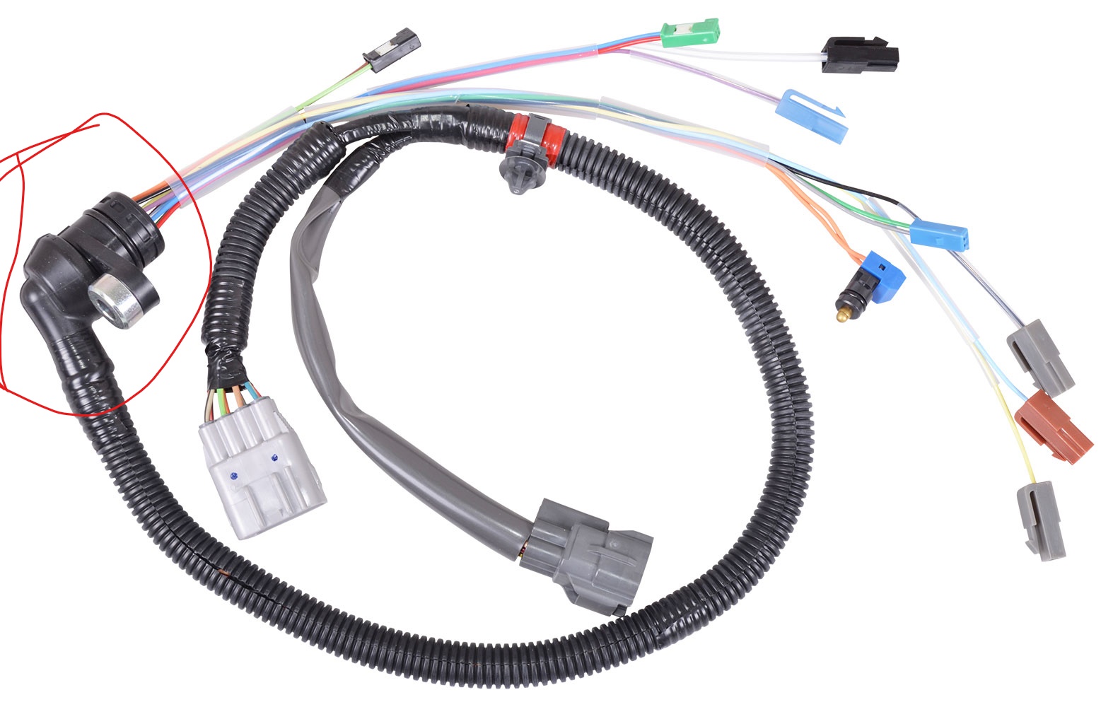

I'm really interested where the wires change color, just to see if there is a bad contact in that spot.
Must be where I put a red circle in the photo.
Just to confirm, the open you measure when warm is with the D connector unplugged and when you're measuring between the D connector D3 and D4 pins and the SLT solenoid, which would mean the open is somewhere between the valve body wiring harness D connector side and the SLT solenoid, is this correct? If this is the case then unless you find something obvious externally like a problem with the D connector or a obvious bad wire there's a good chance you may need to drop the subframe again and get the VB cover off. The color code wiring difference is a mystery at this point but I think you're measuring the SLT correctly and you're seeing the problem you're getting an error code for.
Like you mentioned a solenoid coil failure in the solenoid is a rare event, it could be a bad connector or a broken wire that's affected by the heat. A sticking solenoid is a different problem that the signal missing problem you're having.
About the 3-4 shift flare problem, what's ID mark on the servo pin?
Edit, adding picture of valve body wiring harness and suspected junction where the wire color coding changes.
greffel
Posts: 127
Joined: 10 Jan 2020, 08:39
Year and Model: 2003 S60
Location: Sweden
Has thanked: 11 times
Been thanked: 8 times
Post by greffel »
Hey
You have understod me correctly.
Measuring in the D contact the circuit is open when warm and 5.5ohm when cold.
Possibly problem:
* the red circle area
* bad contact to the solenoid
* the coil
Any tips on creative testing whiteout removing the valv body cover ?
I'm thinkin removing the red circled area for the gearbox, and wiggle around the cables. If I detect a open circuit then it should be a harness problem

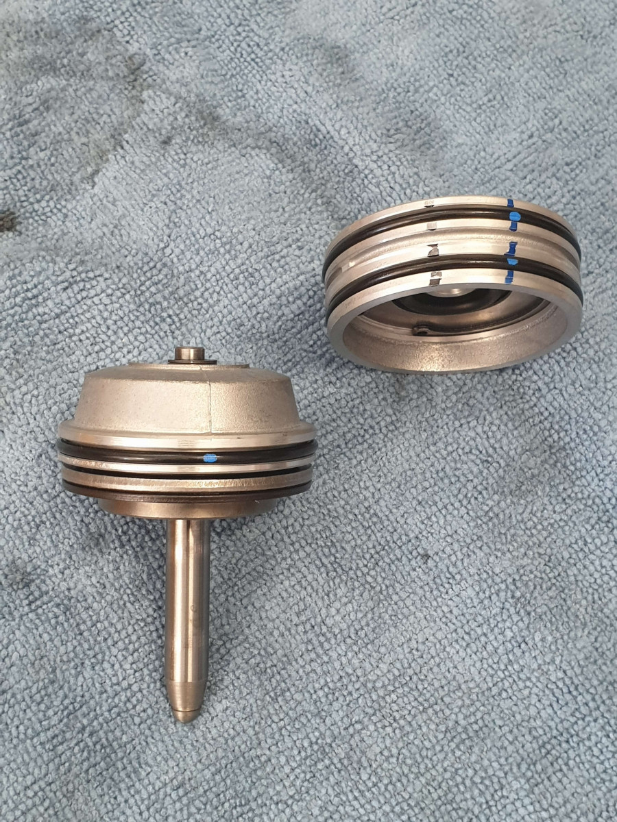

greffel
Posts: 127
Location: Sweden
Post by greffel »
Downshift from 4 to 3 is perfect, every shift is "perfect" except 3 to 4
I guess I have ID1 ?
Polestar 2 - All electric daily driver :shock:
S60 2.5T AWD with a little bit more power :evil:
firstv70volvo
Posts: 575
Joined: 06 Mar 2010, 08:37
Year and Model: V70 T5 2001
Location: Sacramento, CA
Has thanked: 52 times
Been thanked: 123 times
Post by firstv70volvo »
greffel wrote: 08 Jun 2021, 09:16 Downshift from 4 to 3 is perfect, every shift is "perfect" except 3 to 4
I went back and I see that had missed you saying it was ID1, sorry. You could try a pin with 3 or 4 ID ring marks based on your measured values and servo travel out of spec. See the previous post for GM part numbers or maybe you could find a used one.
