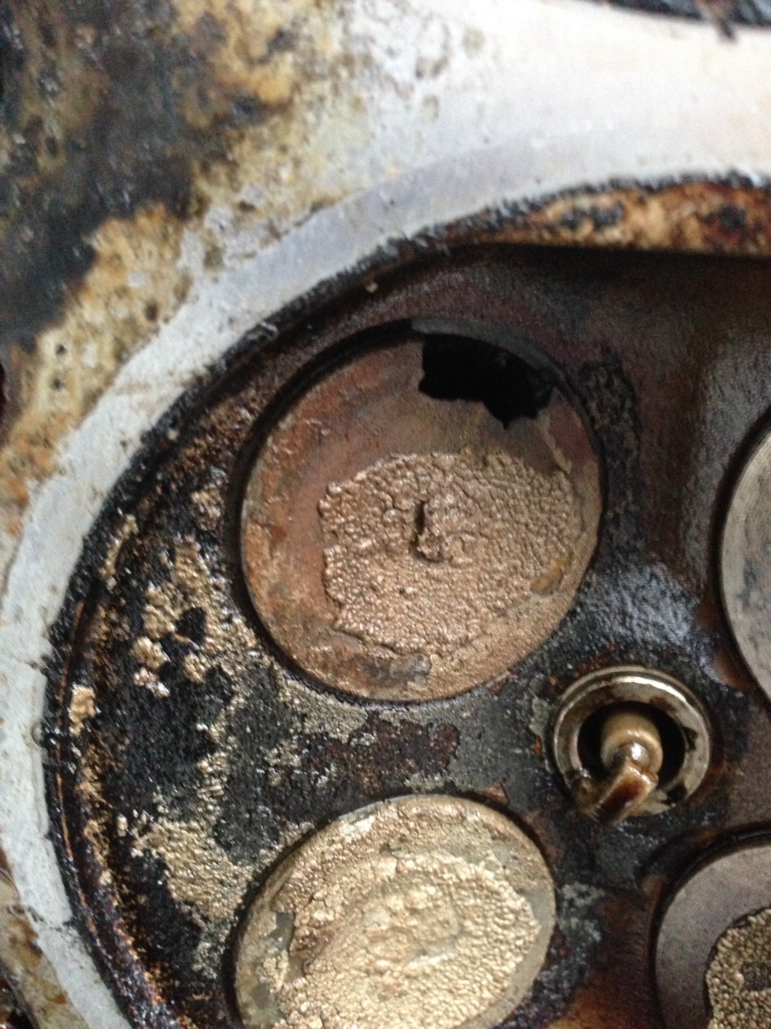

misha wrote: 08 Feb 2021, 14:31 Additional 2 were about to burn?
I'll be in a head rebuilt job soon because of bad valve stem seals(still original).
Will need to check compression first to be sure the engine is in good shape or is that not necessary?
All info you can provide is welcome.
Per machine shop, Hunts in Schenectady NY, two more were Too damaged to seat. I’ll try to get them back and show pictures
The third one , of course, had a pie piece missing. That’s not going to buff out...

There is a lot of carbon build up in that head. I am wondering if the issues we are having with valves burning is due to stem seals leaking into the cylinders and burning causing hot spots taking the valves out?
As to misha's questions. Warm engine for cylinder compression tests. Based on results, if you have a low reading, then a wet test with a teaspoon of oil in the bore and re-test. If the readings improve especially in a low reading cylinder from a dry test it shows the piston rings are an issue in that cylinder. If the wet test shows no change in a low reading cylinder then a valve is bad. Usually an exhaust valve.

Here is another question. Are the engines with hydraulic valve lifters worse for valve failure than solid lifters? Could it be failing hydraulic lifters or low oil pressure not allowing the exhaust valves to not open sufficiently allowing them to overheat?
I think this exactly what happened to me. I didn’t burn a lot with Castrol High Mileage Synthetic but the Pennzoil synthetic burned nasty.
I started smoking on overrun at about 180k miles, 80k ago.
I got lucky in the valve drop, 5 miles from home on a 500 mile round trip, didn’t even need a tow.
