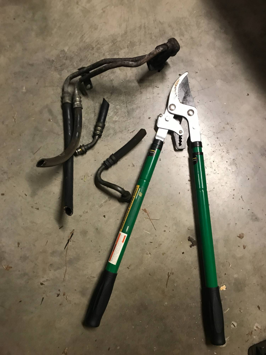

You already know the why, but since I no longer bend in the same places I used to, and given the overall aggravation of wrestling stiff, uncooperative stuff out of tight spaces, this is the how...

That’s an efficient time on task…
