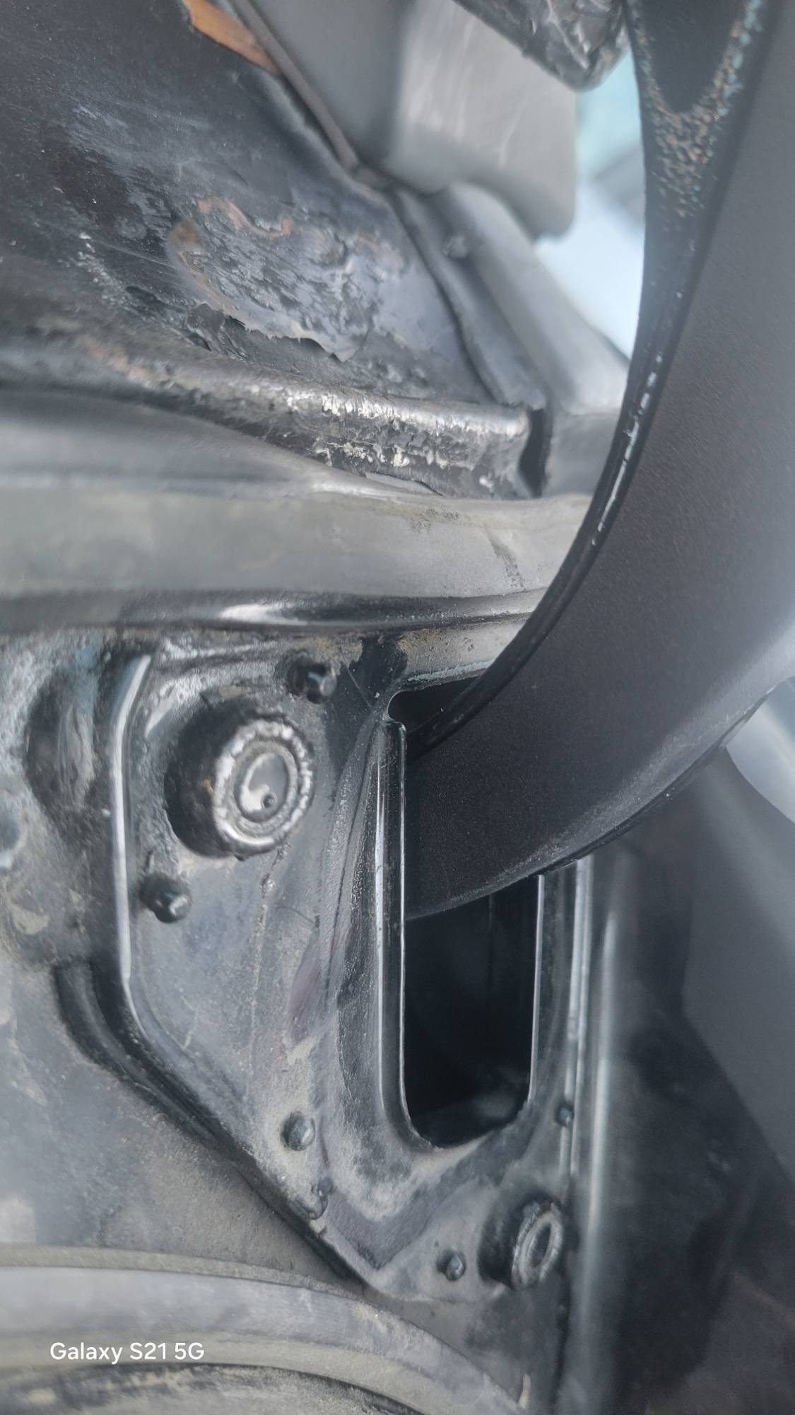

And now, as most people with an AWD know, the unique parts are no longer made or only available from brands like Uro. But I'm noticing this with more and more parts not just for the AWD.
Yesterday I tried to hunt down the source of a leak into my rear tailgate. I think water is getting in through the hinge and dripping down from the D pillar. It seems the seal that presses up against the body of the car is not up to the task anymore or being interfered with by the shrunken rubber seal that runs along the top of the door. It has shrunk back from the corner it is supposed to sit in.
Car also has a dent in that corner of the roof from a branch that fell, supposedly while the previous owner had it for sale. I don' think this damage would lead to a leak. Also potentially the screw for the roof rail is leaking, but it started getting too cold to feel my hands.
The water appears on the rubber trunk mat underneath the D pillar speaker. I'm afraid to take any plastic trim off the car with the temperature hovering around freezing.
Edit: a picture is worth 1000 words

I've had the roof trim/rail mounting screws leak in the past. The Volvo part is a small piece of one side sticky tar-like tape that 'heals' when the screw goes through it. Over time the material dries out and leaks. Some silicon should fix that or panel bond.
If that corner seal is stuck down fully, water should not get around it. It may have got loose when the branch hit it?
Have you checked the tail light seals are in fact sealing?
Good luck!
