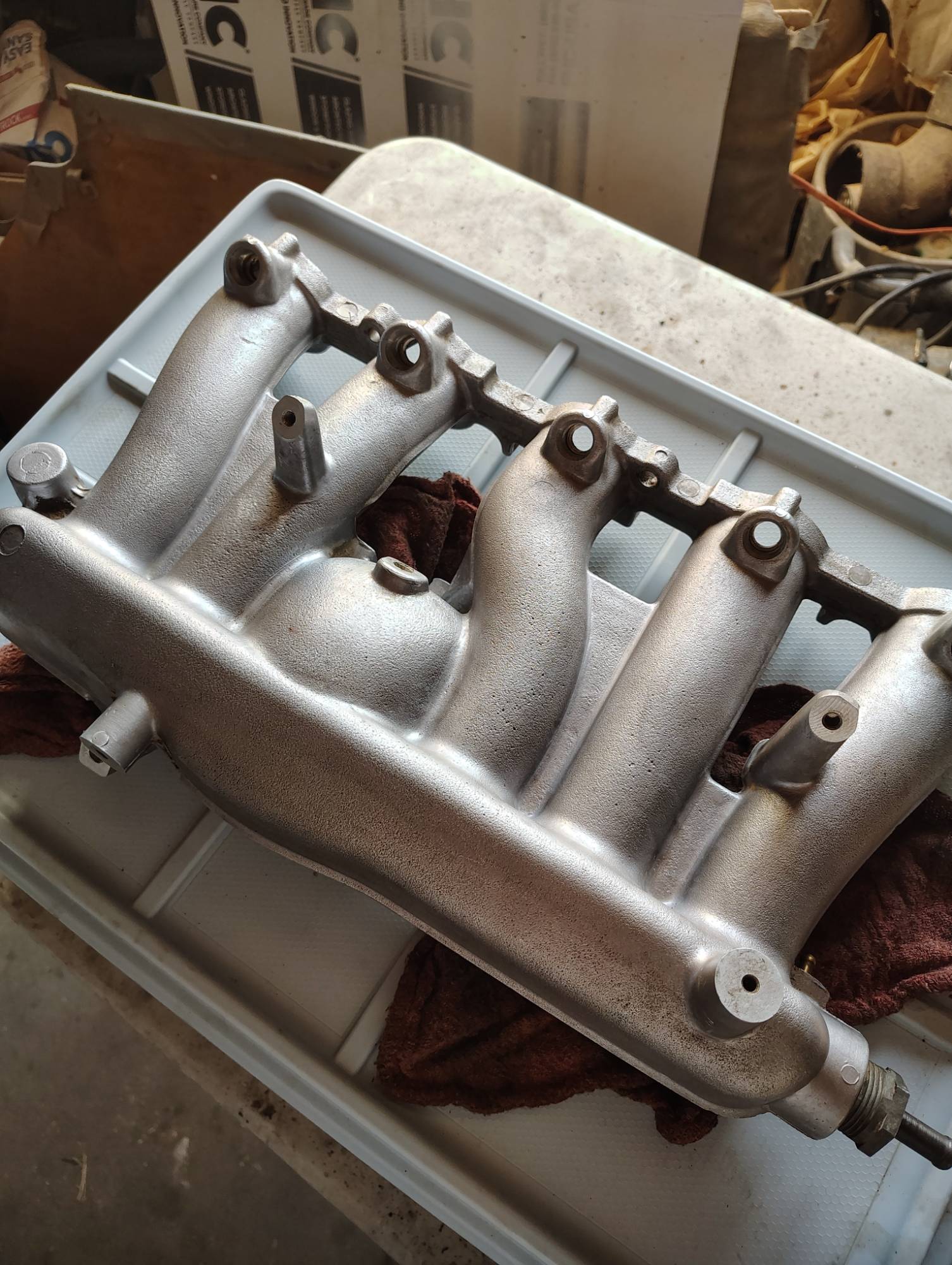

While waiting for parts I decided to try and clean up the intake manifold, used different cleaners, alkaline degreaser and regular degreaser as well as hot water.
I still can't get that last bit off but it's probably corrosion. I am thinking about trying a mild acid solution on the exterior. Citric acid most likely.

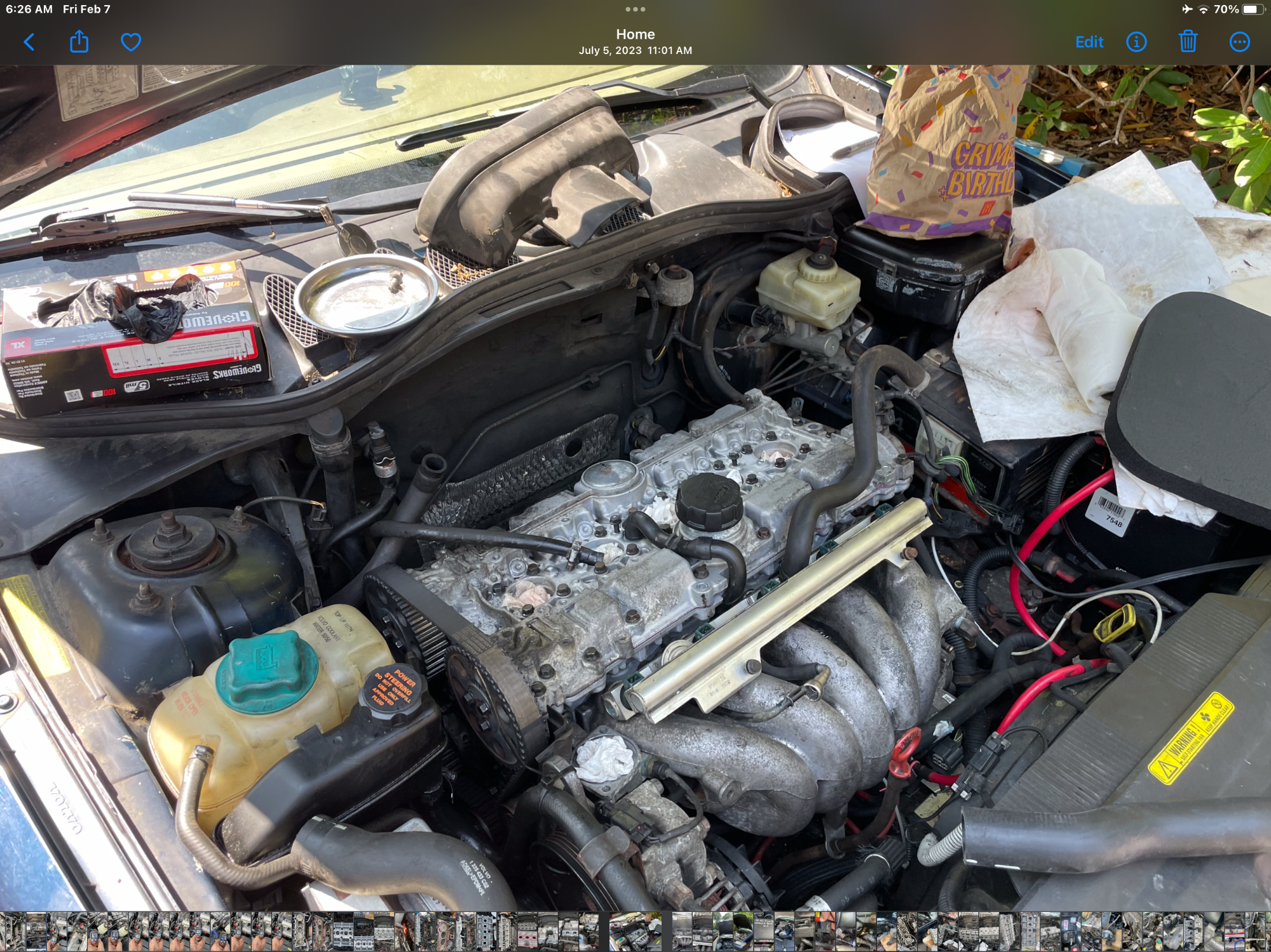

Those are hard to get shiny clean, indeed.
Here’s the best I could do with my T5

You could try aluminum polish to see if it removes any of that staining.

I've seen somebody polish one before, it looked amazing. The only problem is the amount of work required to make it like that

Brake cleaner and typical strong solvents often stain raw aluminum black - very frustrating. I have been using a home brew cleaner of 2/3 vinegar and 1/3 Dawn liquid, heated up so it will mix. Shake it up in a spray bottle. Use stiff scrub brushes, brass brushes, and brass toothbrushes to scrub scrub scrub.

If that doesn't work, you could check to see if you have a shop locally that would "vapor blast" or "vapor hone" the intake for you. It's basically a wet media blast. I've had it done to some valve covers, but the shop I used hadn't perfected their procedure. I think most shops that get the really nice finish, usually use a dry glass bead first, then the wet blast. If you don't want to risk glass, then maybe look into soda blasting, but that won't look as nice.DennisCA wrote: ↑06 Feb 2025, 21:50 While waiting for parts I decided to try and clean up the intake manifold, used different cleaners, alkaline degreaser and regular degreaser as well as hot water.

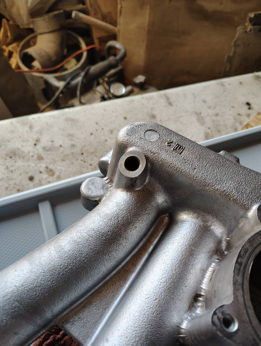

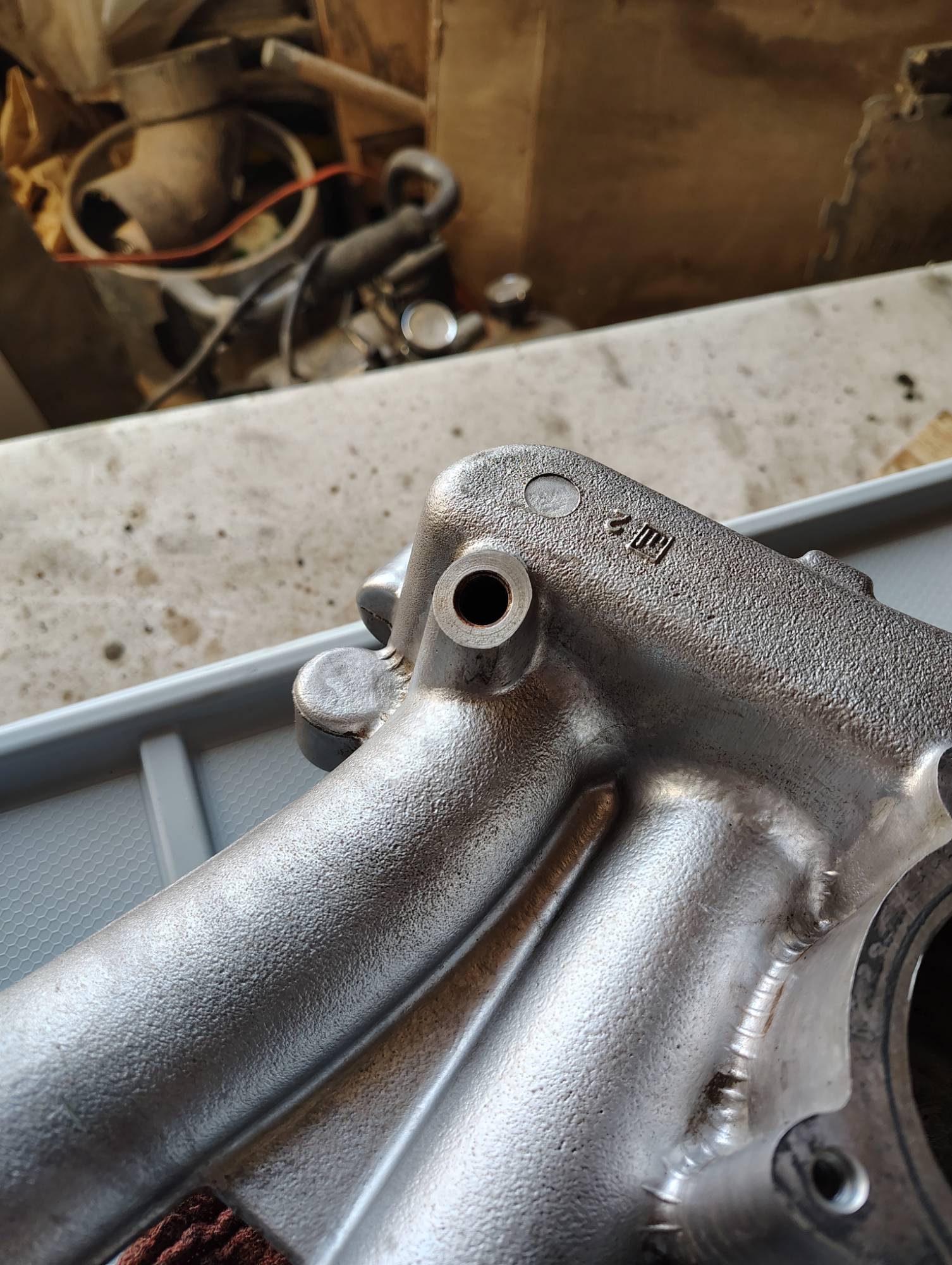

I use throttle body cleaner and a plastic brush.
On a side note; what connects to this threaded opening on the underside of the intake ? Just to the left of the ETM if installed on the car.

That's the banjo bolt fitting for the PCV.Sveedy wrote: ↑08 Feb 2025, 16:29 I use throttle body cleaner and a plastic brush.
I've never seen this car together, so I'm operating in the dark.
