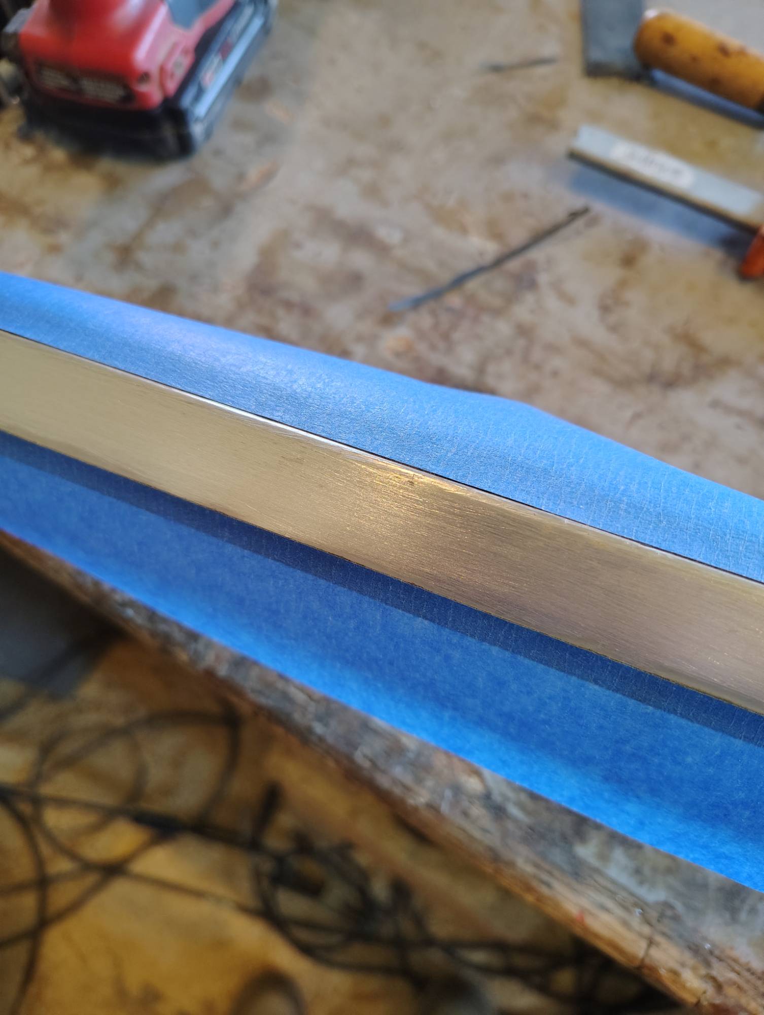

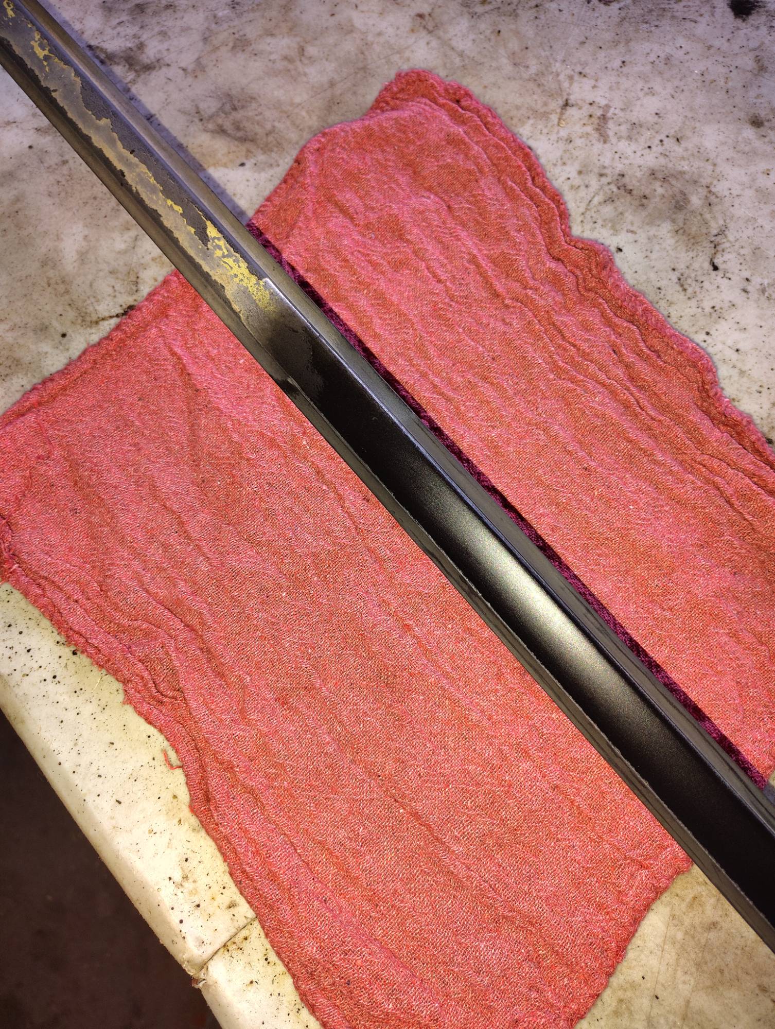

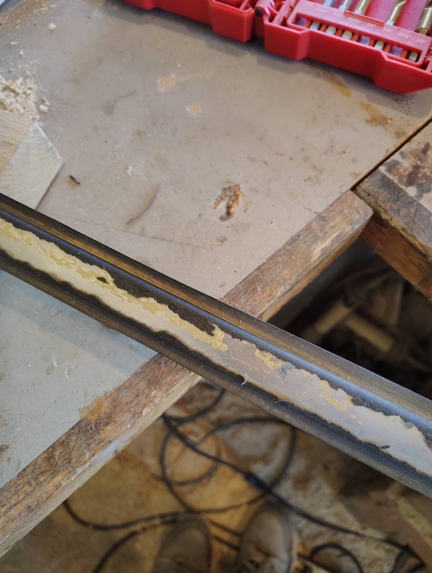

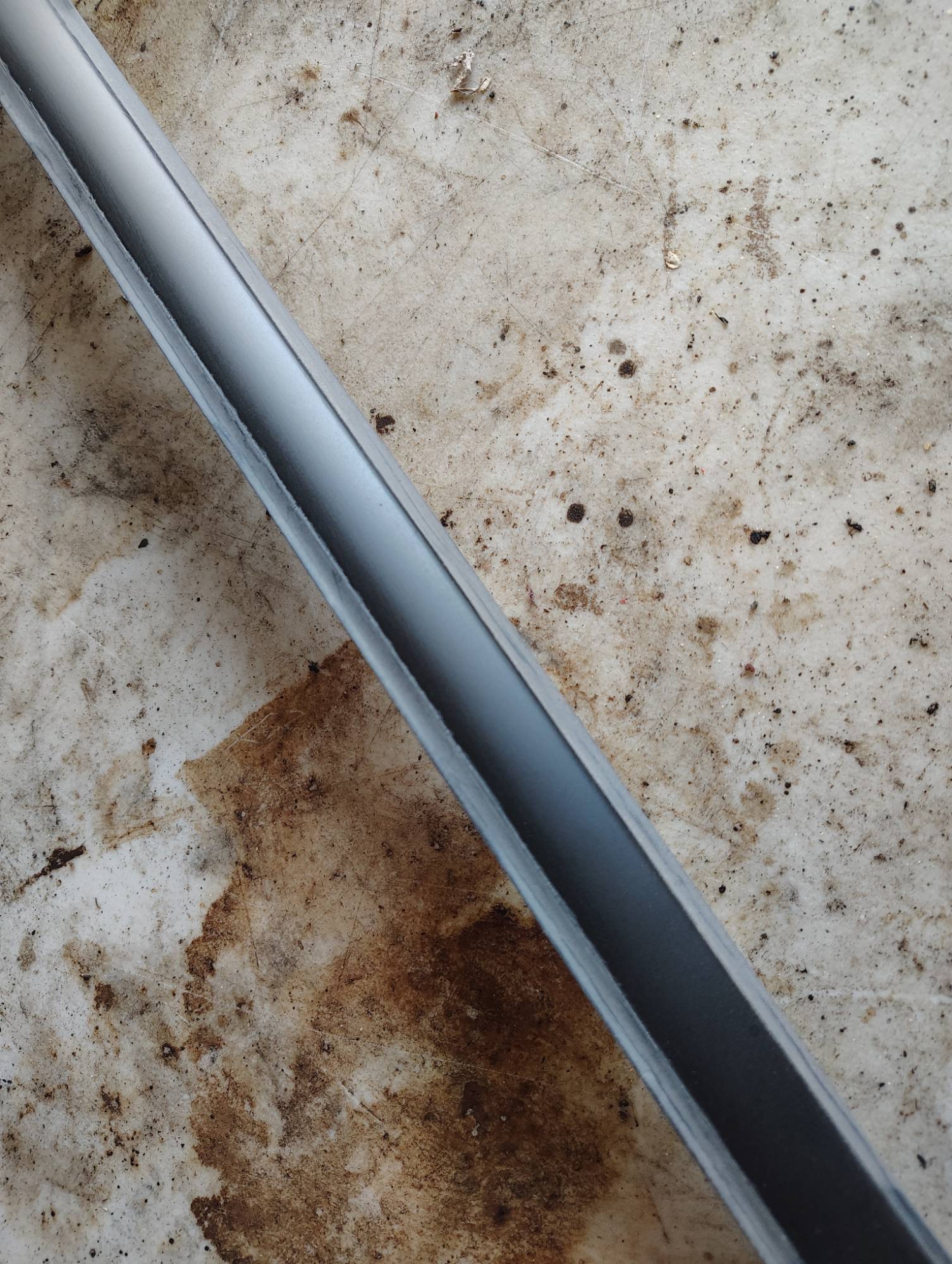

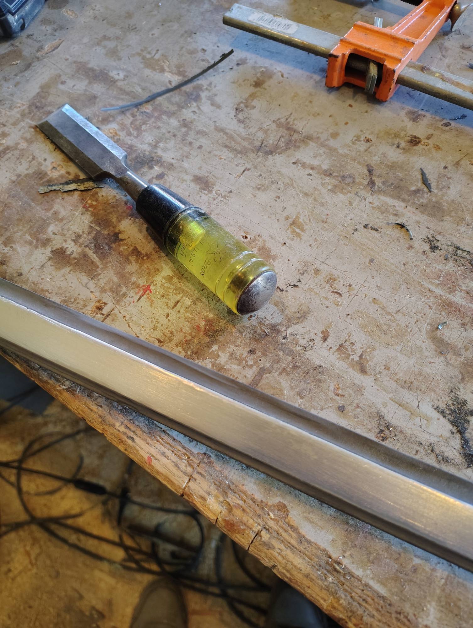

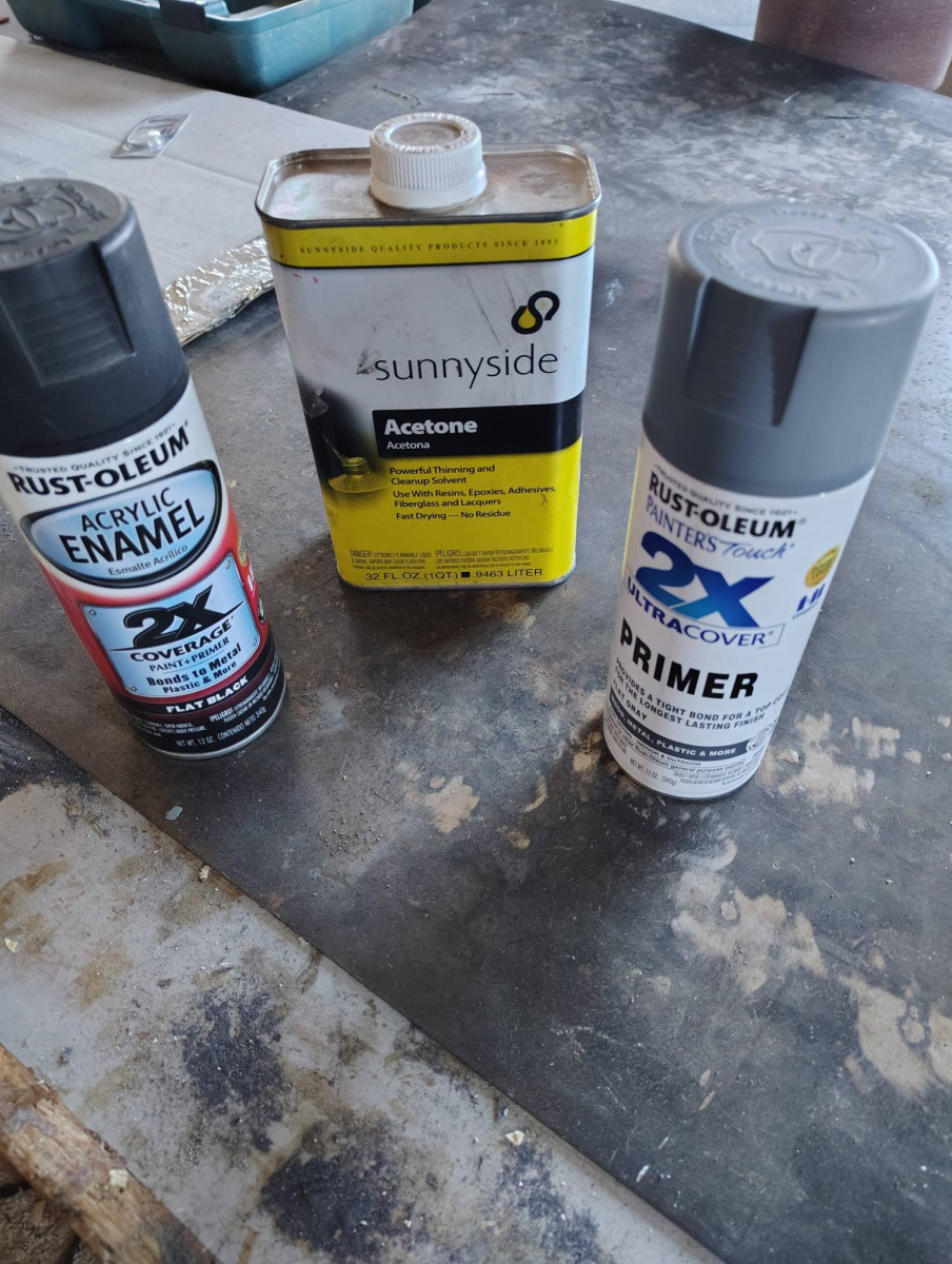

Decided to see what I could do with the roof trim. I found a set of remarkably good trim pieces for the V70, so I have a set to play with. But the 850's are beginning to crack. I read about Plastic Dip etc, but decided on just primer and paint to see how that might look. I just used a sharp chisel to shave away the old coating, sanded, cleaned, and painted. Once the paint is fully dry, I'll freshen up the rubber and stick the whole thing out in the sun and see how it fairs, but so far I'm good with it.

Nice job on those. Good to know that works and looks good. Can you tell us what paint and primer you used?

Nothing special with the paint. Just what I had laying around the shop. I really just wanted to see how hard of a job this might be, but based on what I've seen, I think a good quality paint/primer would yield good results.
I touched up the rubber a bit with some 303.

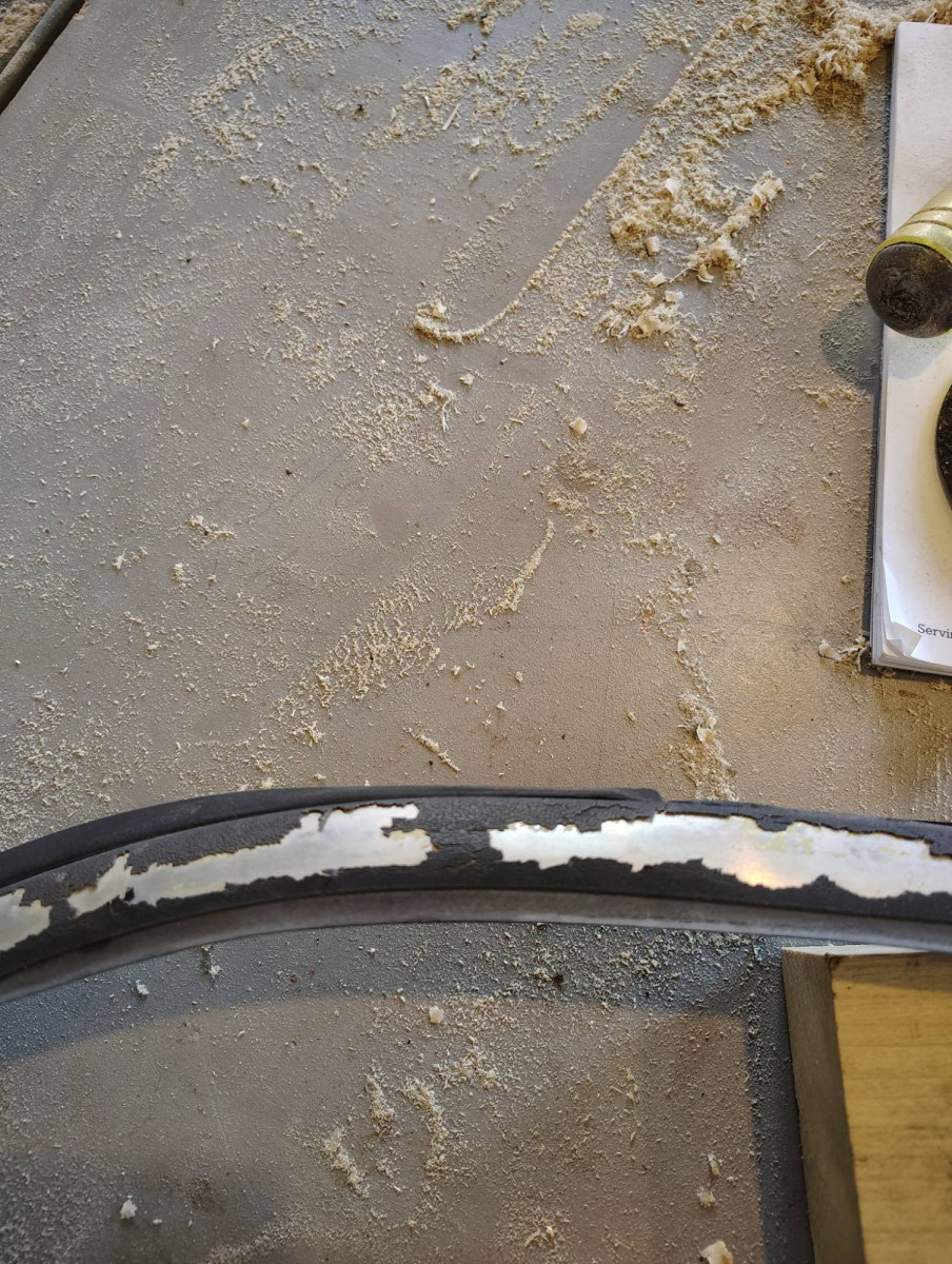

This is a really bad piece of trim that I'm playing with as well. Even the rubber is missing in parts due to it being so dry.
