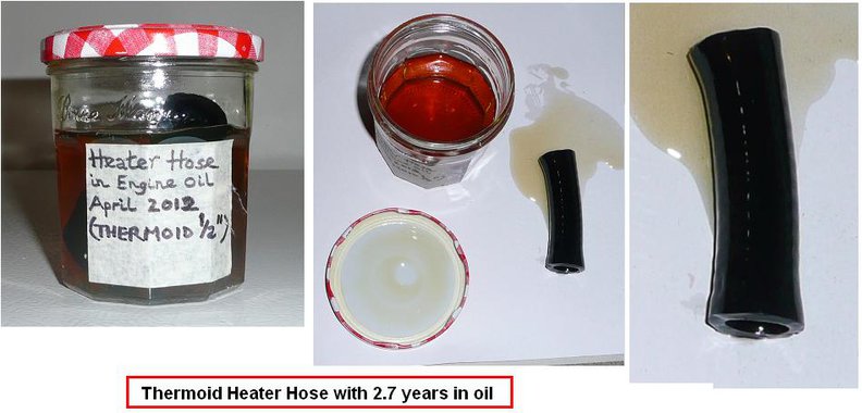

As promised, I finally finished brewing the heater hose in oil.
I originally soaked this heater hose back in April 2012 (brand name is Thermoid, same as the 5/8-inch heater hose mod in this thread).
This is to see how the generic rubber hose reacts to oil over time.
Well, after 2.7 years sitting in the garage, completely submerged in oil, it still looks good, soft, pliable and no issues at all.
This is to prove my point that I have been using heater hose for PCV purpose for some 25 years and have had no issues (other than the rubber hose eventually got brittle and broke after some 12y/150K...).

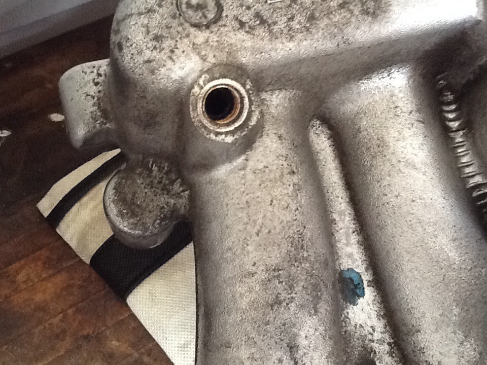

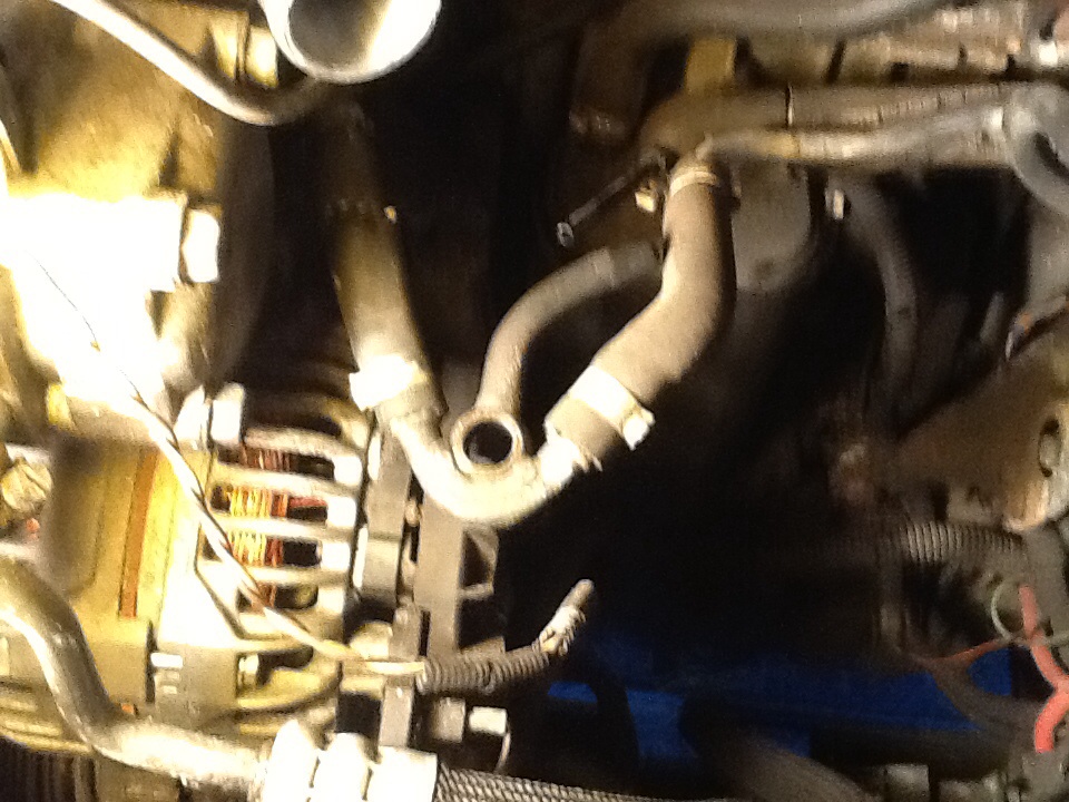

The 2000 V70 it uses the coolant to keep the hoses warm. Can I just plug up the coolant lines connectors on the thermostat and the block. Put a barbed fitting on the intake manifold then run that line direct to the PTC? I have used CN90's steps on the 94 850 and the 98 V70 and they work great.
- Barbed fitting here then direct PTC nipple

- Eliminating this part's useage
- image.jpg (231.96 KiB) Viewed 2564 times

This makes no sense to me, room temp oil on a rubber hose??? At any rate, if you have been using the heater hose for 25+ years, that's another story.cn90 wrote: Well, after 2.7 years sitting in the garage, completely submerged in oil, it still looks good, soft, pliable and no issues at all.

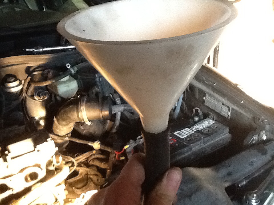

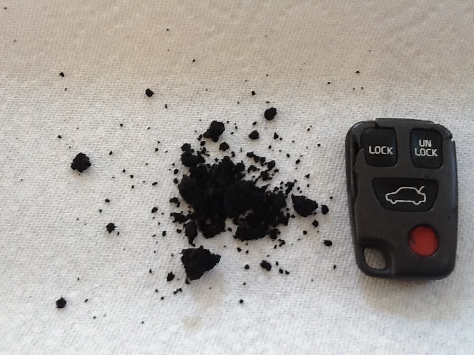

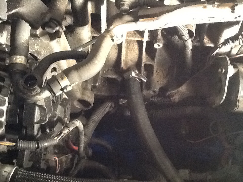

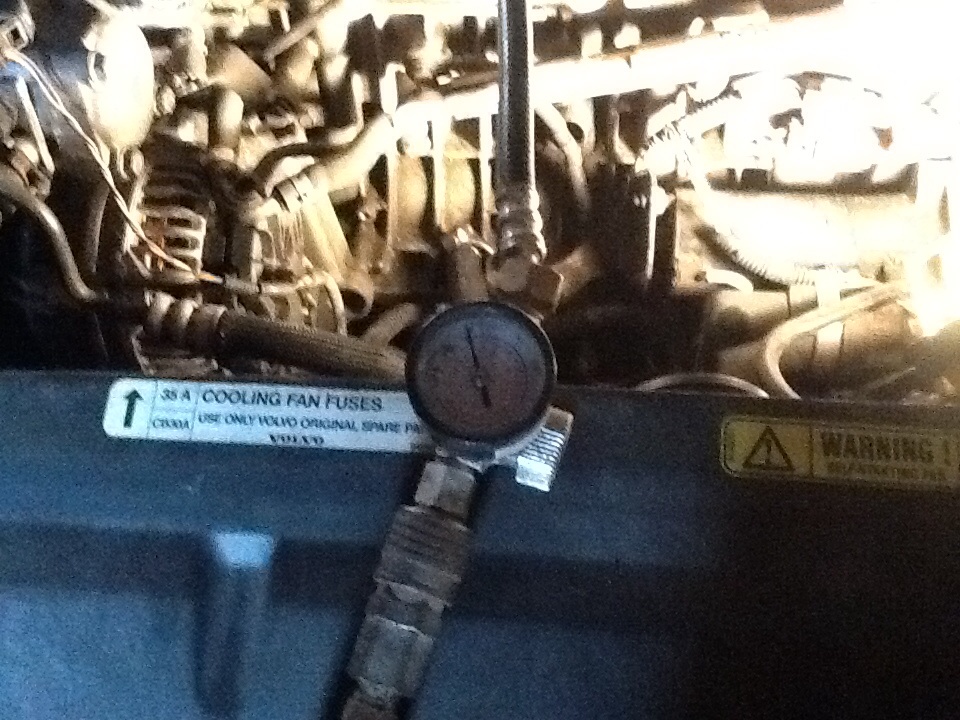

It seems on every car I do the PVC the oil tube going into the block is clogged with an asphalt like crude. I used this connection to my air compressor with good results. Hooking up a 3/4 inch hose to the stub on the lower port then filling 3/4 tube with SeaFoam then let it sit. After about an hour the asphalt debris can be blasted out. Before starting clean out all debris possible. Change oil when completed with PCV job. I think it was CN90 who said if you can blow through hose and hear bubbles the port is clear.

- Attached 3/4 hose to port
- image.jpg (243.48 KiB) Viewed 2985 times
- Use funnel to add SEAFoam

- Connected up to air after letting SeaFoam soak for an hour
- image.jpg (257.03 KiB) Viewed 2985 times

I just did this to my 98 V70 GLT and thought I had something I could contribute to the conversation on diagnosis. I've done this operation before and the box and tubes were somewhat restricted and the PTC nipple was clogged, but the one I just did at about 145K on this car is the worst I've ever seen. The drain was completely sealed shut with dry, hard carbon/oil that had to be chipped out of both the block and the catch can. The hoses were significantly reduced. My recent symptoms developed after having done Valve stem seal replacement as I think by redoing the seals I eliminated the oil's place to go(combustion chamber on engine vacuum). The catch can was now filling up and the oil was running down the long line to the PTC and into the turbo pipe. On driving and laying into the throttle at all, as soon as I would let off the throttle I would get smoke. I did also have bad puffing out the dipstick as would be expected. I had oil working its way out the dipstick and down the ds tube and under the car. I cleaned the box which was full of all kinds of crap (chunks of crap as well as lots of chocolate milk). I used the 5/8" heater hose to replace the long run to the turbo pipe and replaced the spaghetti tube from the intake manifold with 5/32" I believe with some larger silicone tubing as adapters for the nipples. Car is back to optimal condition. Anyway my point to the board is that this symptom of smoking after coming off the throttle, going up a steep hill, hanging a hard right etc.. is likely because you have a full pcv bottle that is overflowing. In my case it didn't actually happen until I did the valve stem seals.
