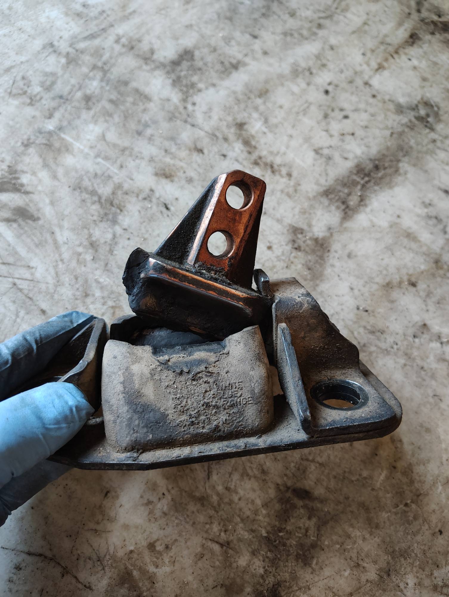

Probably wasn't necessary, but I went ahead and replaced it anyway.

Are you done with that mount??

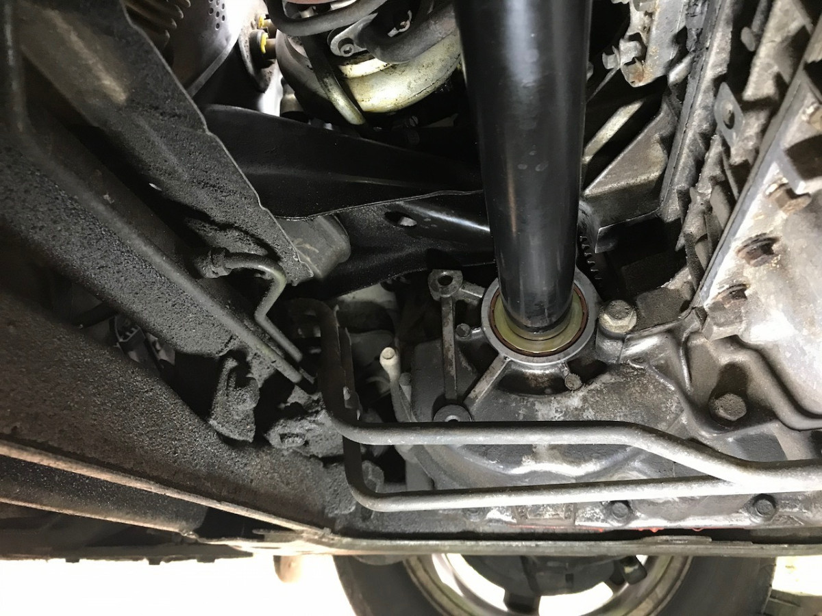

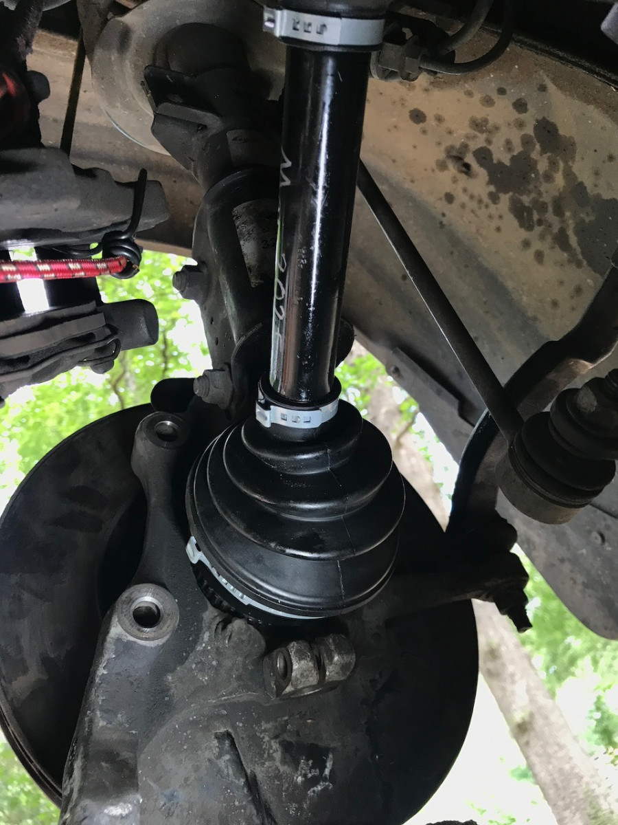

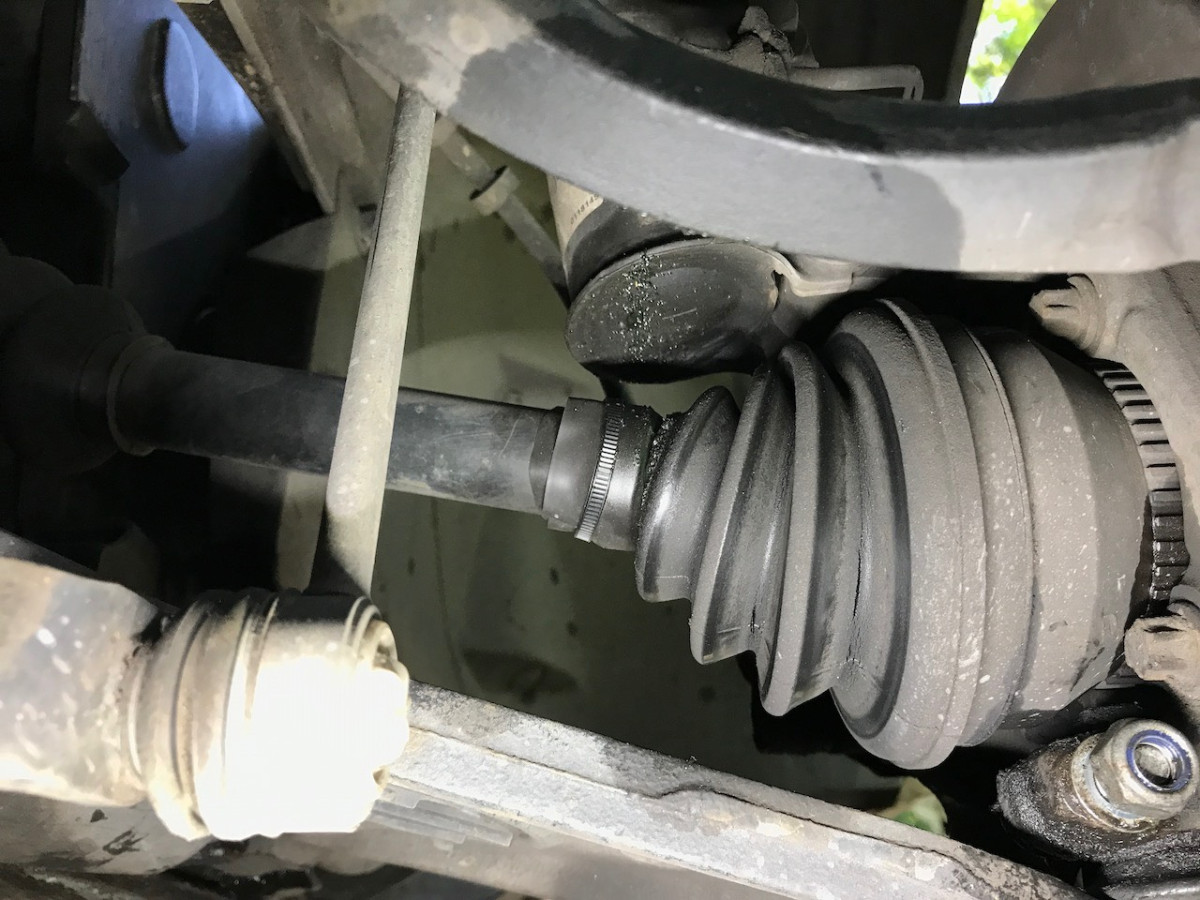

I replaced the boots on my passenger axle
Old boot: Newly re-booted axle installed in transmission with new Corteco seal: Axle reinserted into steering knuckle: I used the GKN Lobro outer boot... last one endured about 10 years. Hoping for similar longevity with this one.
