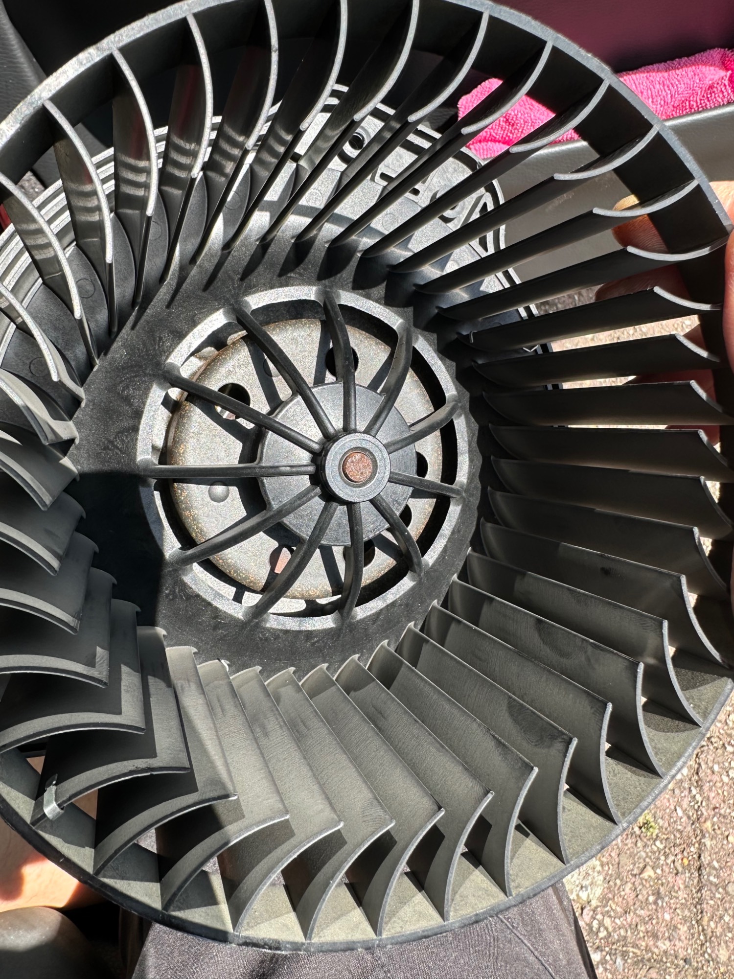

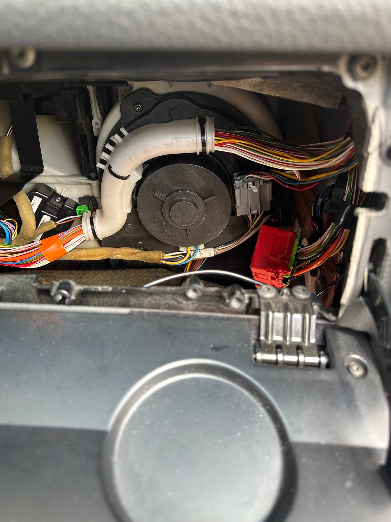

I have to take out the blower motor. Rookie mistake for not checking codes before putting everything back together.
Scan shows ecc-433 too high current for the blower motor.
There’s always something to work on, right?
Edit: added picture
Edit 2: it seized up, as it’s really hard to get it to spin.
Back to the junkyard it is. Too bad it’s Sunday.
