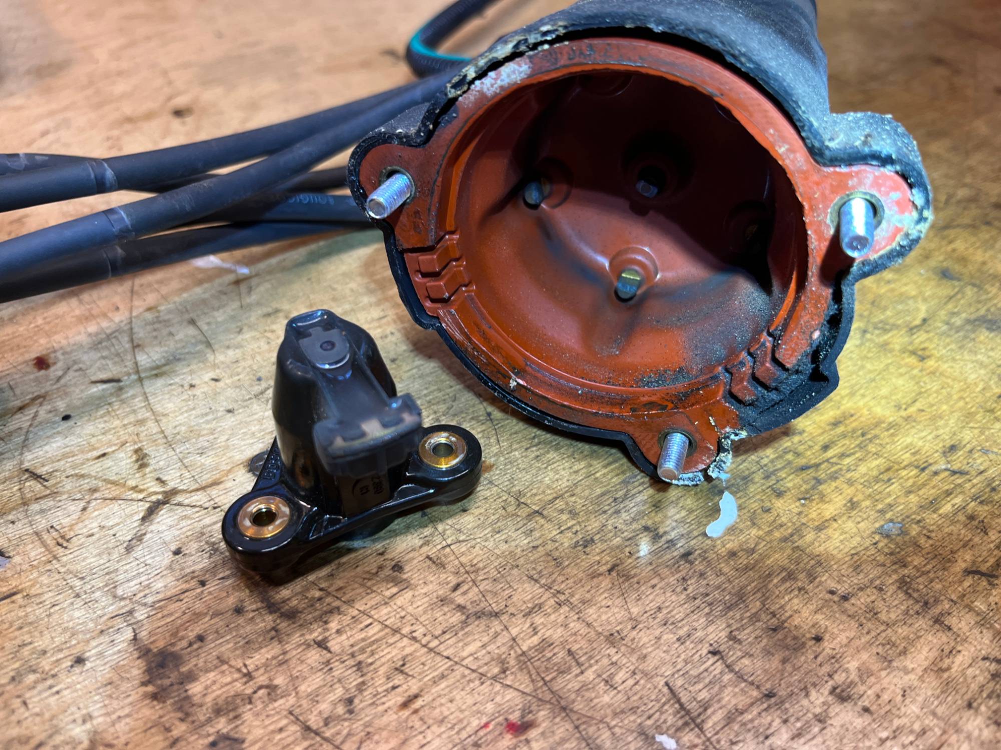

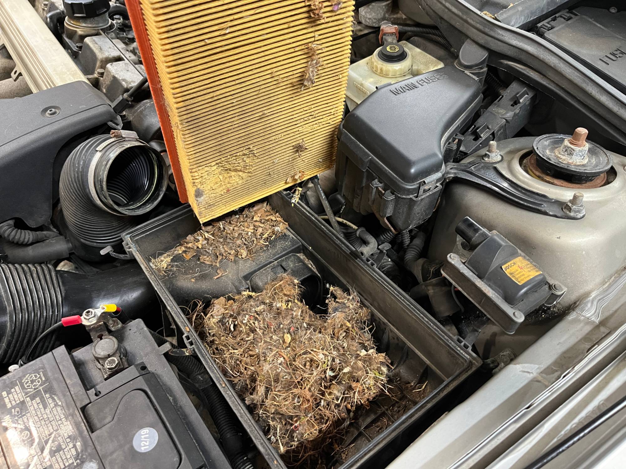

I just finished a tune up on Ingrid, the 98' S70 5-speed. A couple of weeks ago I had a no start situation, luckily it was just down road at our local supermarket. But it happened on a very humid and rainy day, and that got me thinking. The car started up again after letting it sit for a couple of hours, so luckily I didn't need a tow. It also had quite a bit of hesitation when accelerating.
Looking at the parts coming out of the car, I am thinking the tune up was way overdue. When I bought the car 2 years ago the owner said, naah, no tune up needed. But I should have looked right away.
Also, there was a very large mouse nest in the airbox. That engine was probably seriously starving for air.
But now she runs really well again. Parts used are Volvo plugs, Bougicord wires, Bosch cap and rotor. I also swapped in a nearly new K&N air filter from Mathilda, the non running 99' S70.
