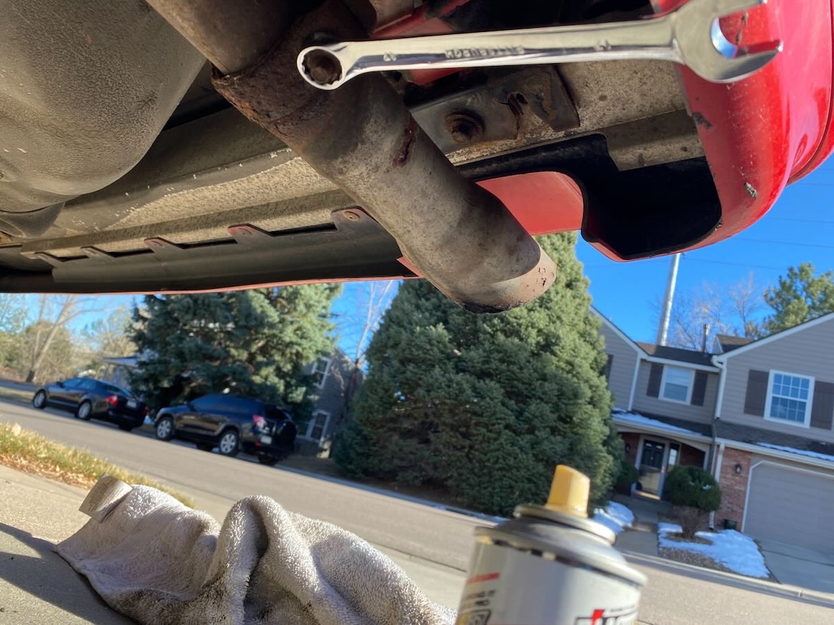

Got this clamp off after 282 gallons of PB Blaster.

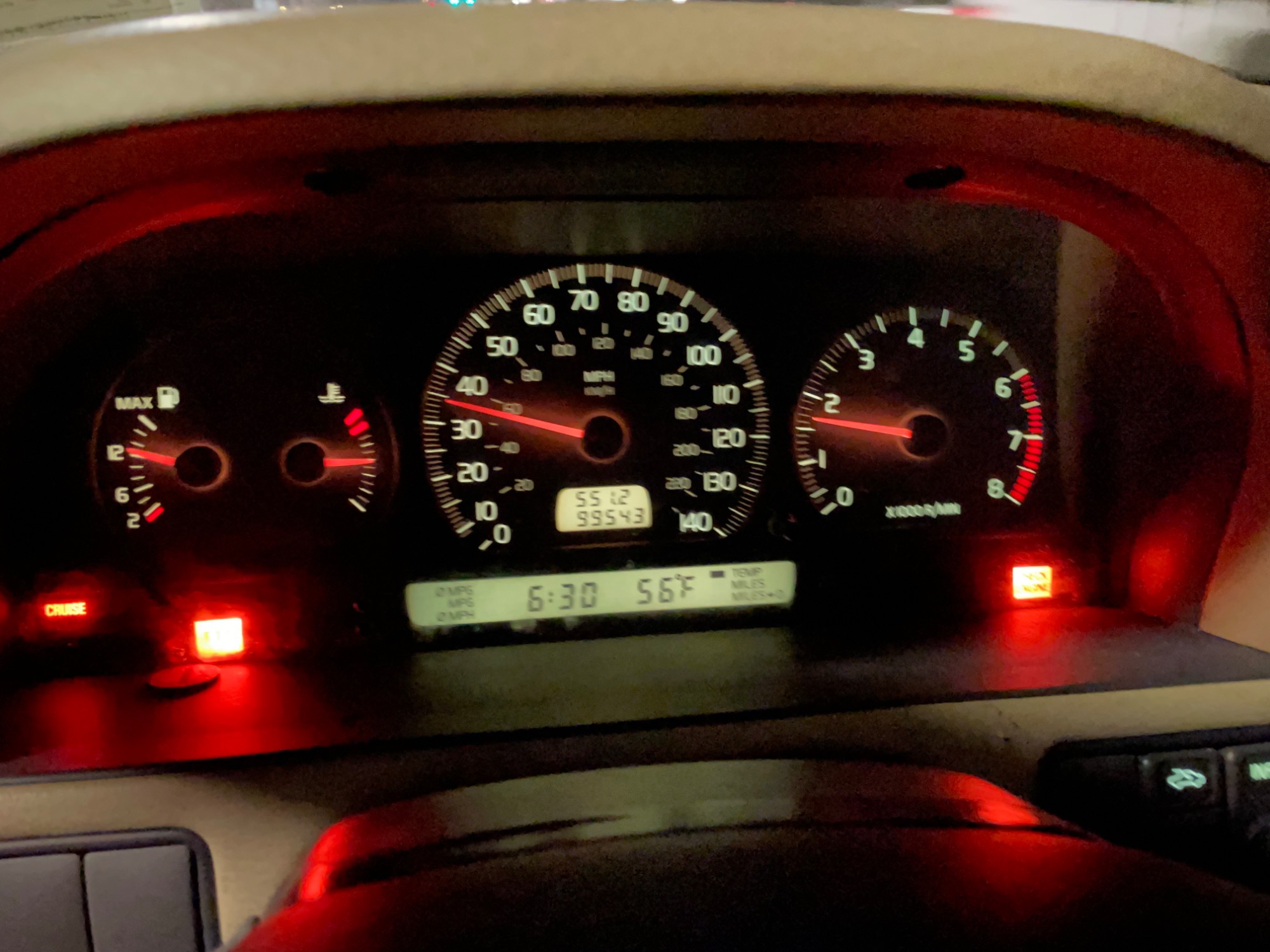

Duly noted the 10,000 mile marker to ETM failure on Karla as the ETS light came on.
It’s been holding a throttle body internal error code for a year now.
