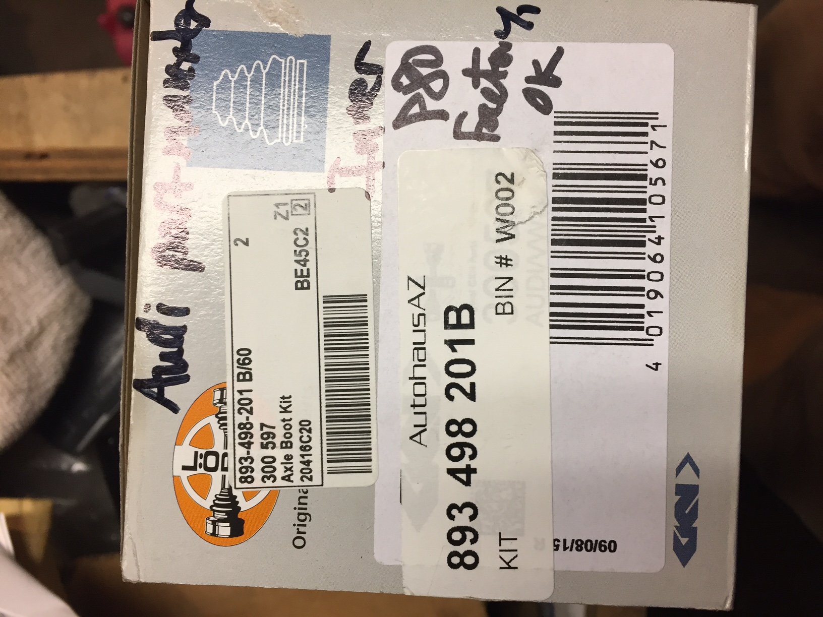

I’ve used the GKN 300597 boot on my 97 850 R and according to cn90’s info the inner boots are the same on the NA.
It is an Audi boot, but fits fine.

There is so much thread bloat in these axle boots posts lol. Go to the definitive post from NorthernLights who first sorted this out, all correctly: viewtopic.php?f=1&t=64252.
You can just look at the first post, unless you are up for a discussion that winds all over the place. The GKN 300597 is what you want, it also goes by part number 893-498-201-B-M60. AutoHausAZ is usually a great source.

Got the Volvo compatible Audi boot for inner CV joint. Side-by-side it looks just right.
