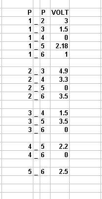

Voltage
I tested the power on the TB connector
between Pin 1 and Pin 2,3,4,5,6
then P2 and P3,P4,P5,P6
etc etc
voltage on TB connector Key position II
voltage on TB connector.jpg (15.39 KiB) Viewed 730 times
Then I checked the general voltage.
As you mentioned the voltage was too low.
I have had a drainage, but this time it seemed more bizarre because it went down fast and stayed there!
This is strange; I had the meter connected AND the battery charger plugged in.
The second I turned the key to position II, the voltage went down from 12.45 to 10.00 and STAYS there. I turn the key to position I the voltage starts going up slowly.
So I began pulling out the fuses one by one to see when the voltage goes back up.
It is the cabin 10A fuse # 25 Ignition Switch, CEM, ECM .
Is this a sign to look for another car?

Checked all the 6 pins on TB vs body negative;
Pins 2 and 4 == 0 V
Pins 1 and 6 == 3.4 V
Pin 3 == 5 V
Also searched my wiring pdf, there is no detail about CEM or ECM. No schematics, no pin # to battery positive indication. "I mean no detail /no electronic map of the printer circuit / no schematics for neither CEM or ECM."

I just finished doing the voltage-on-cranking test. The results are surprising.
With TB connector disconnected so that I can use a needle to my multimeter the reading are exactly same as if the key was sitting on position II. No change.
Not only that, the engine is running the same way . Pushing the pedal will stop the engine from running.
But don't forget that the TB is NOT WIRED to ECM.
So, being connected or not to ECM I have the same situation. Yet there was adequate continuity on the cable.
Maybe I go back and try the MAF voltage as well.
